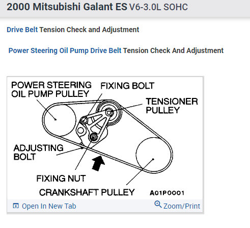

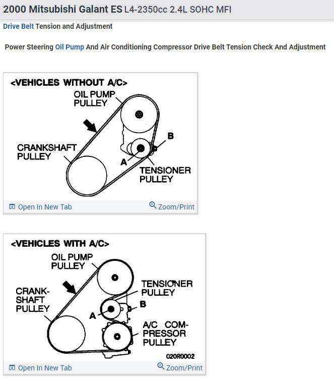

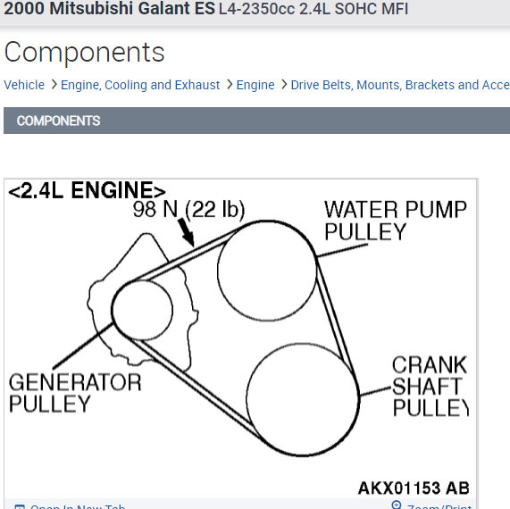

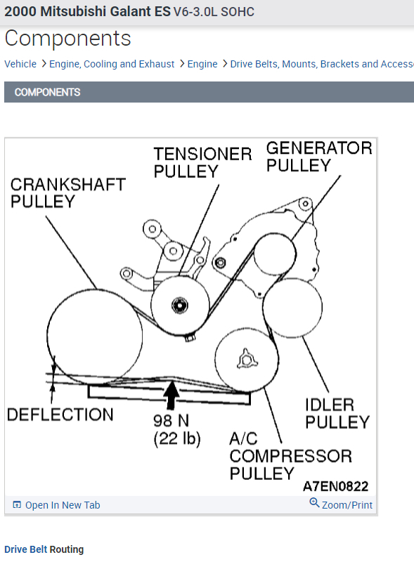

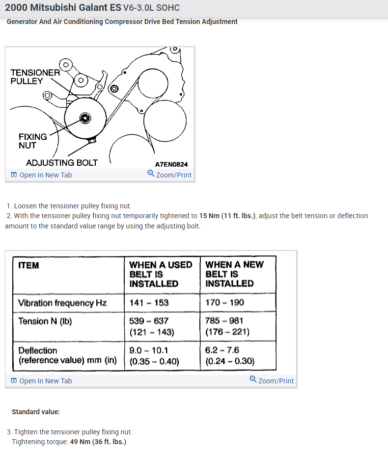

My car has 2 belts. A serpentine belt and a separate alternator belt. Trying to find sizes and diagrams.
Aug 13, 2021 at 2:59 AM
SQM
  • 6,383 POSTS
I see that you did not include the engine size so I have included diagrams for both of the 4 cylinder and 6 cylinder engines.
Unfortunately I do not have access to the size of these belts.
You might find these articles helpful:
https://www.2carpros.com/articles/how-a-serpentine-belt-works
Look below for the diagrams.
