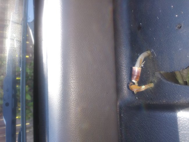

My alternator is bad. while i was trying install the new one i noticed the positive and another wire are going through my fire wall and out the top of my dash. I think they made a ground since that is coming out of my dash. Does anyone know the proper way to wire the alternator or a pictures so i can do it correctly? i am so stumped on why previous owners even did this. The picture is the ground out of my dash i followed the positive wire and another alternator wire to that ground.

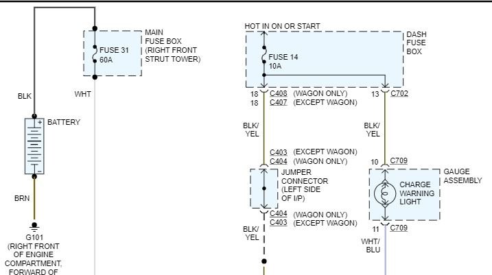

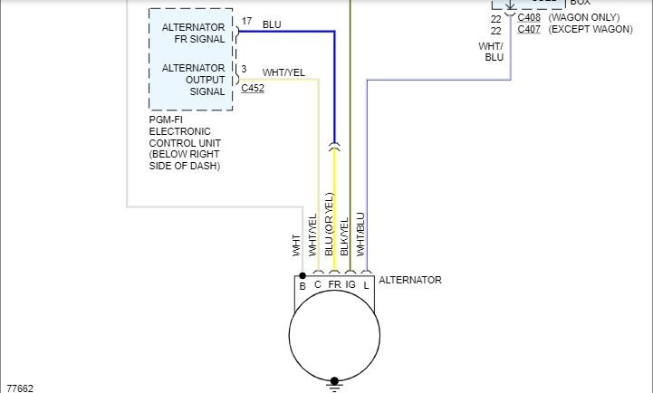

I have no idea what that is on the dash. I pray it isn't anything from the alternator. However, wires do run into the vehicle. I attached a wiring schematic for you to look at. It is the entire charging system. I had to break it into two pictures because of size and so you can read it. Take a look at it. It shows wire color, where they go, and indicates everything related to the charging system.
Here are a few links that you may find helpful:
https://www.2carpros.com/articles/how-to-replace-an-alternator
Take a look through the schematics I attached and see if it helps. Let me know if you have questions or need help. Also, I would love to know what the wires sticking from the dash are for.

The wiring on this car in general is just a mystery. they bypassed the key starter to put a starter button in. I turn the key and push a button to start the car. there is a switch to turn on radiator fan that never worked. Only thing i can think of for that ground on top of the dash was he had a phone charger bolted by it but no wires to it so i didn't understand. The schematics definitely make more sense. i am going to try tomorrow morning redue it.

I finally got new part in and everything seems working good. The wire coming out of the dash is spliced into the ground wire for the alternator from what i can see all the rest of the wiring is done correctly.

Good job. I'm glad you got it working. I still can't understand the ground wire coming out of the dash. Regardless, let me know if you need anything.

So i went to yank out the mystery ground in my car dash. when i ripped it out now the entire car wont start or click over.
Feb 28, 2019 at 6:29 AM
  • 110,248 POSTS
Wow. Do this. Tell me approximately where it is going and the color of the wire. I will look through schematics and see if I can locate it.
