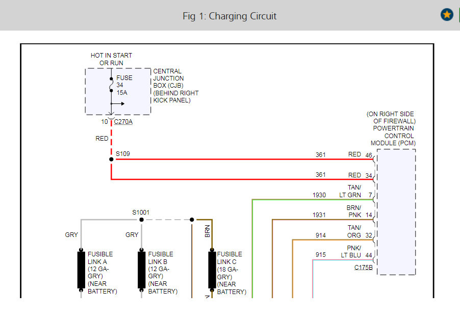

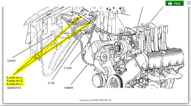

I need to know location of alternator fuse? What fuse do I use to replace it with? If that's not the problem of why my battery power level drops to nothing after being jumped. I need to know how to replace alternator.
Sep 2, 2019 at 9:44 PM
SCGRANTURISMO
  • 4,897 POSTS

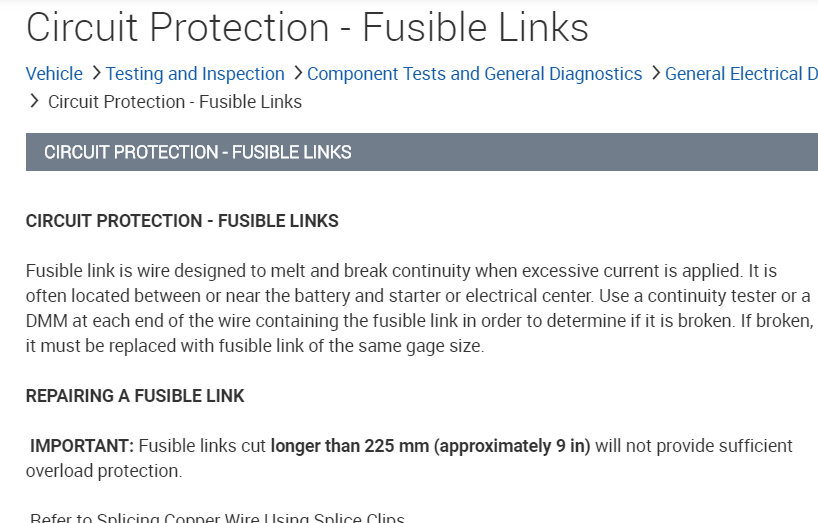

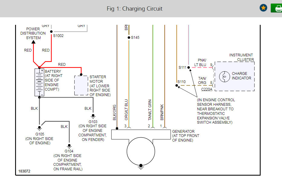

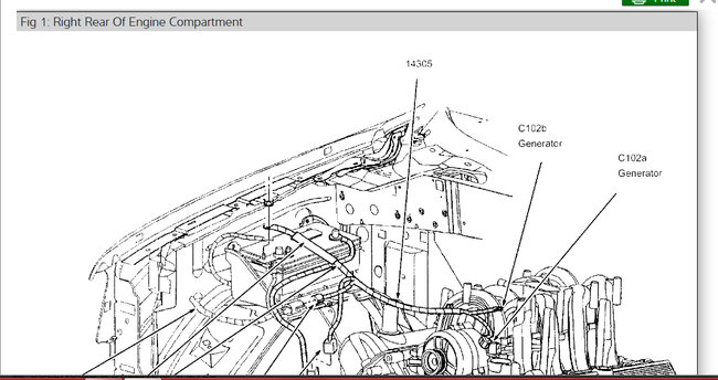

They are fusible links A, B, and C. In the diagrams down below I have included a wiring diagram of the charging system for your vehicle as well as a diagram of the location of the fusible links and a guide for how to check them. Please go through these guides and get back to us with what you are able to find out.
