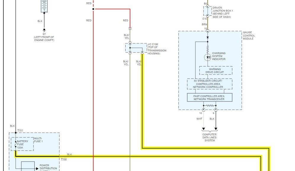

I have a message on my dash saying check charging system i have replace the battery and the alternator and is still coming up check charging system. can it be the belt and pulley? it just happen out of no where. i was about to make a turn my lights on my dash started flickering inside the car and then it shut off. i need help.
Jul 20, 2020 at 8:55 PM
Good morning,
Did you charge the battery with a charger? That is the first step.
https://www.2carpros.com/articles/how-to-charge-your-car-battery
Then you need to test the voltage at the battery with the engine running to see if the alternator is working.
Do those 2 test first and let me know.

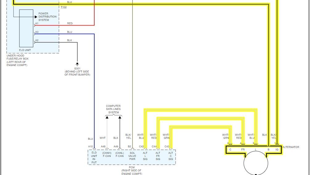

I attached a diagram as well for when we do testing.

Hey, yes i put a charge battery and it still saying check charging system. Can it be the belt or pulley? Also when I check the connector to the alternator there was no power or ground. what can that be? is there fuse I have to check? Because I don't know what fuse to check.
