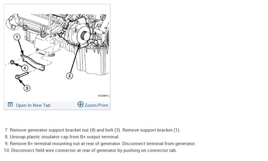

Looking for a step by step guide on how to replace the Alternator in a 2011 Dodge Challenger.. Thank you

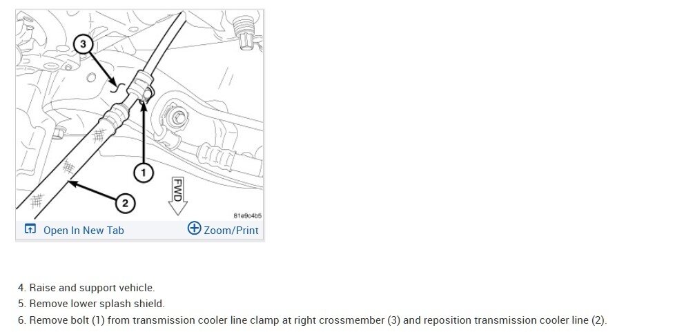

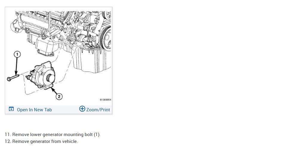

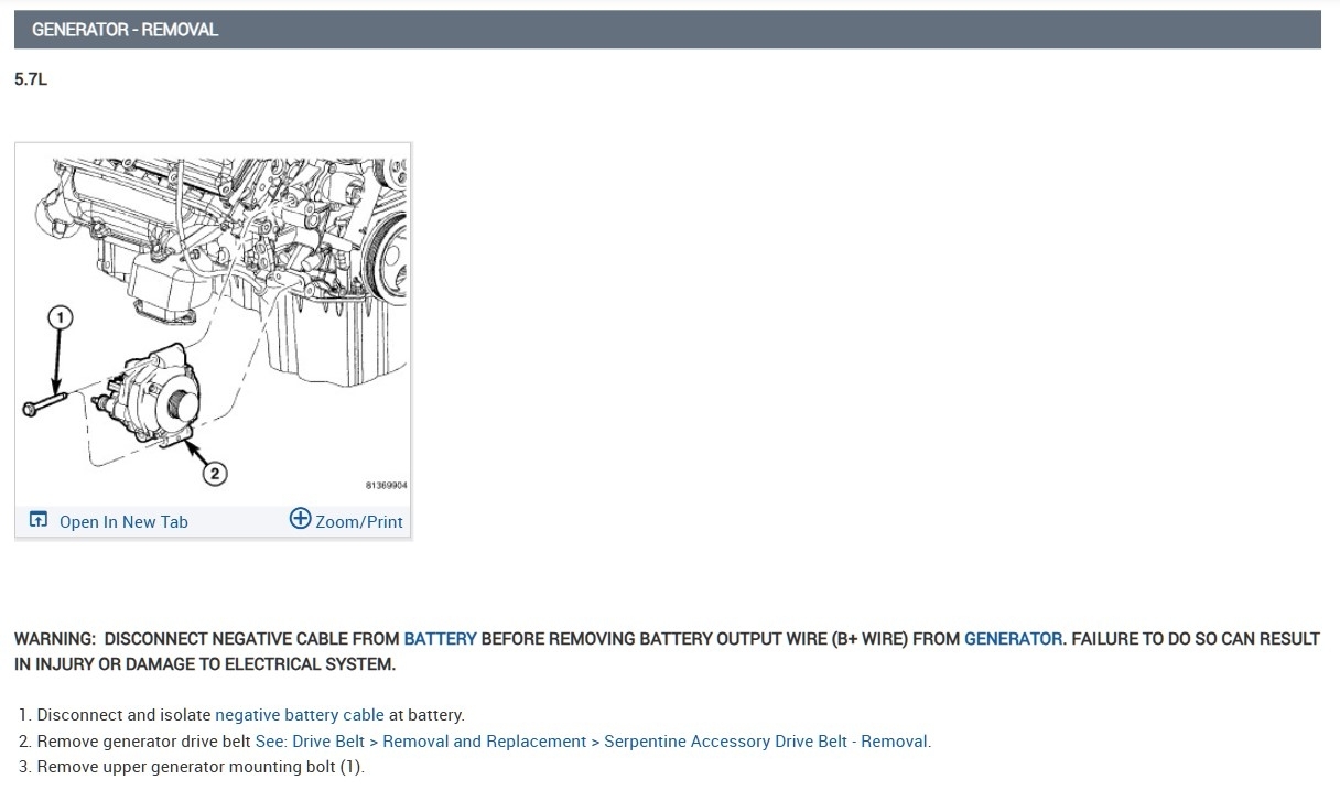

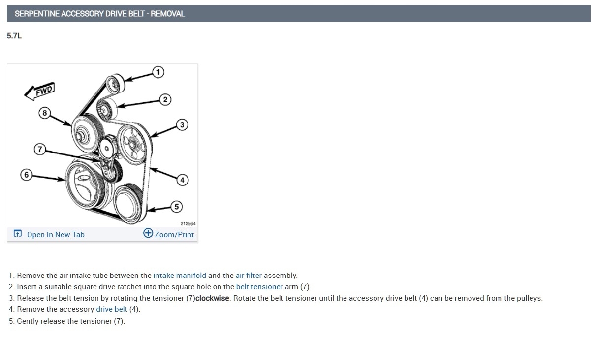

Heres the service info on the alternator replacement for the 5.7-liter V8. If it's a different engine size, just let us know.
