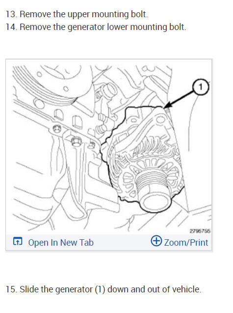

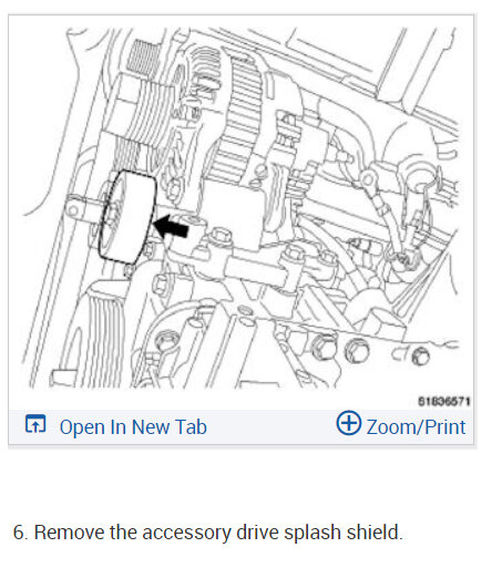

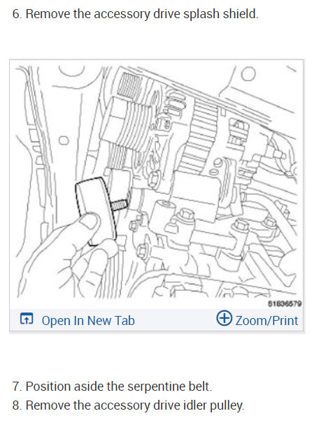

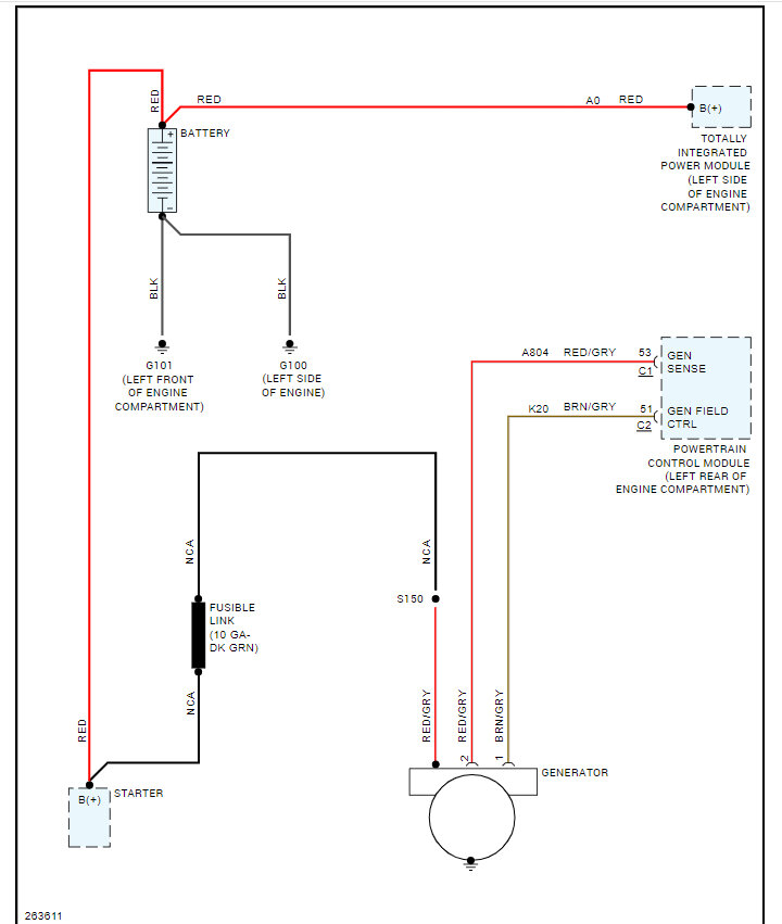

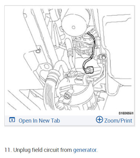

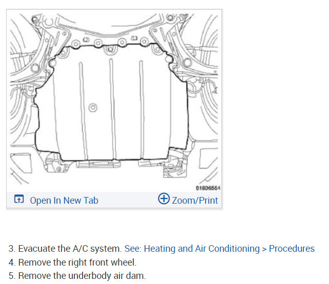

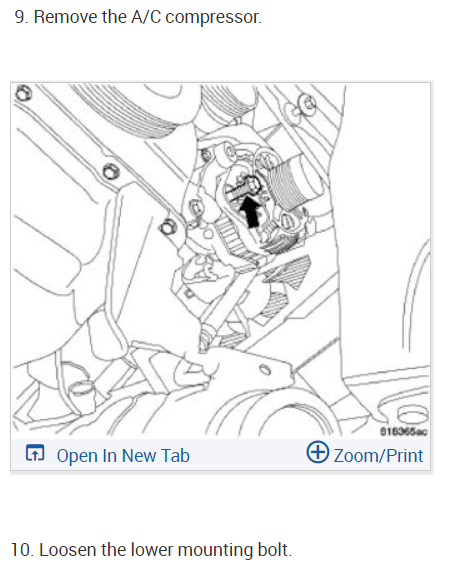

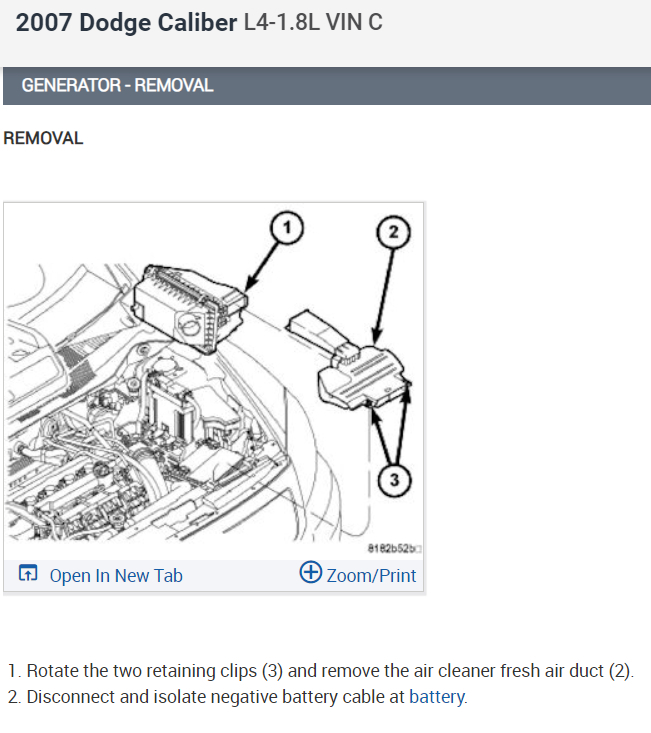

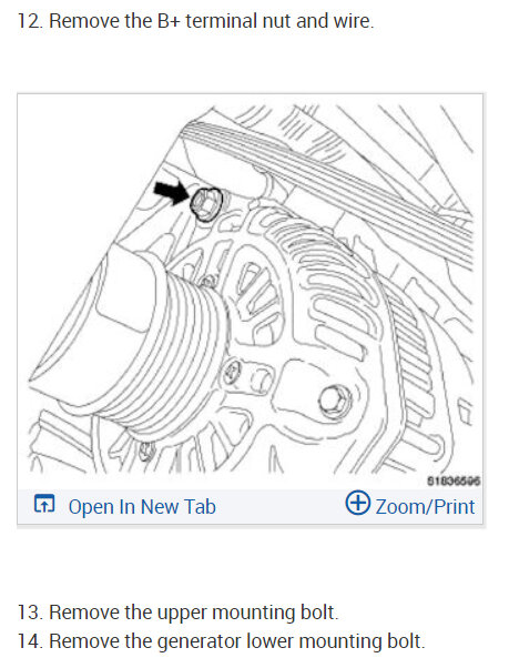

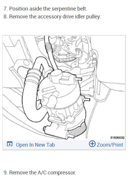

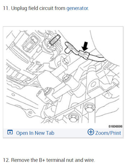

My car can't charge. there is a red light battery in dashboard. Can i have a full electrical wiring for charging system.
Oct 4, 2024 at 6:37 PM
  • 55,673 POSTS
Did you change out the alternator 9 times out of 10 this will be the problem. Here is how to change the alternator and the charging system wiring diagrams as requested. Check out the images (below). Please let us know what happens.
