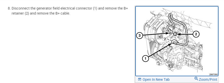

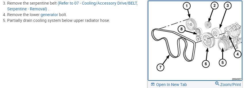

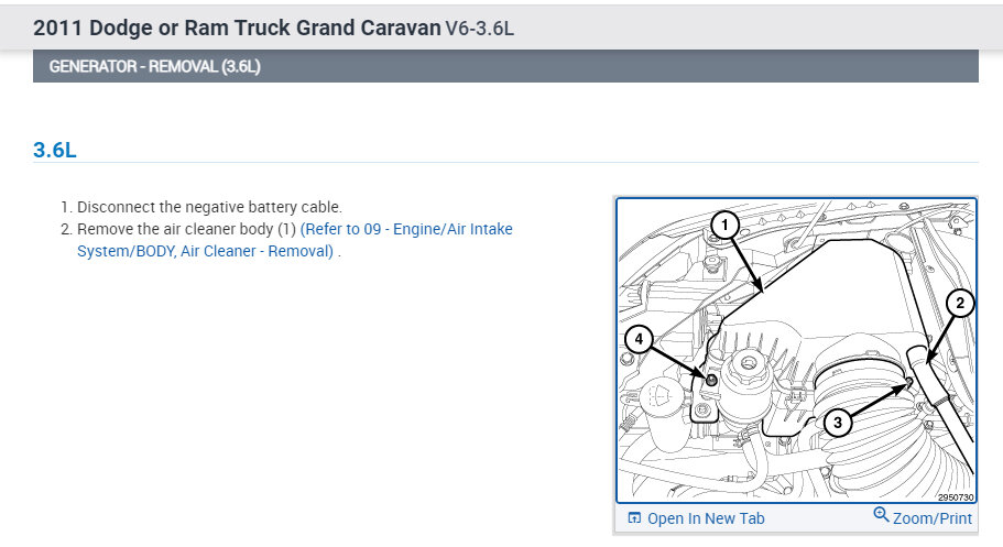

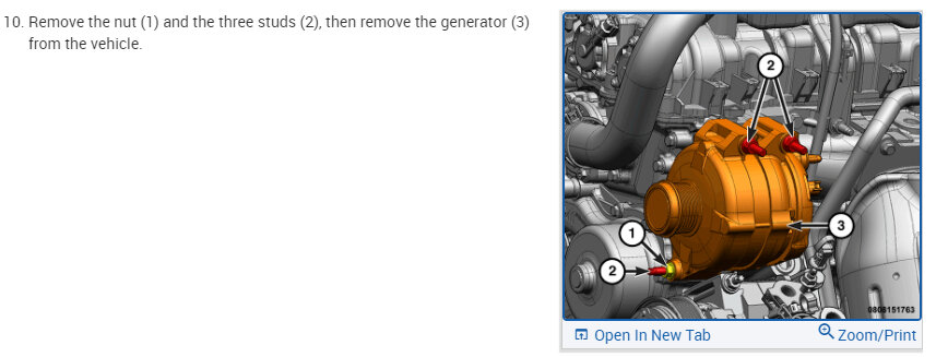

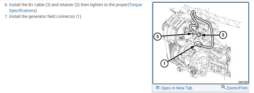

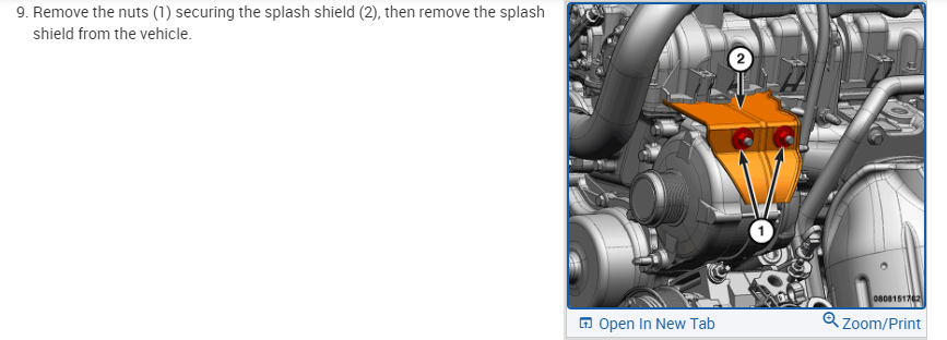

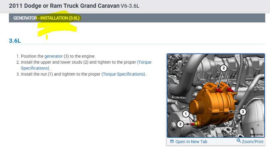

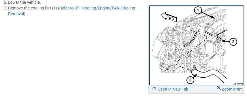

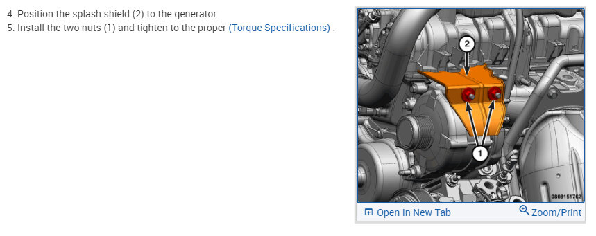

No, they are two very different parts. The OEM part number for the one needed is
68272108AD. That is the one needed.
Here is a link that explains in general how to replace one. If you look below, I attached the directions from my manual specific to this vehicle.
I hope this helps.
