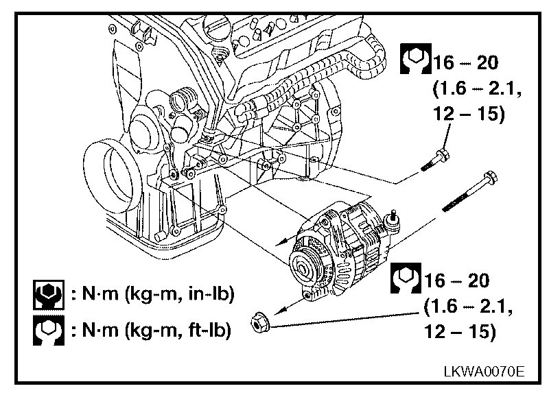

can you help me change the alternator out it is bad.
Nov 29, 2019 at 3:10 PM
  • 110,194 POSTS
Replacing the alternator on this vehicle will require you to work both under it and above. AS far as replacing it, you shouldn't have trouble.
First, here is a link which shows in general how one is replaced. You can use it as a guide:
https://www.2carpros.com/articles/how-to-replace-an-alternator
Here are the directions specific to your vehicle. The attached pic correlates with the directions.
____________________________
2006 Nissan-Datsun Altima V6-3.5L (VQ35DE)
Procedures
Vehicle Starting and Charging Charging System Alternator Service and Repair Procedures
PROCEDURES
CHARGING SYSTEM
Removal and Installation
Removal
1. Disconnect the negative battery terminal.
2. Remove radiator.
3. Remove front/right-side engine undercover.
4. Remove the drive belt.
5. Remove idler pulley.
6. Remove the generator adjustable top mount, using power tools.
7. Remove the generator lower mount bolt and nuts, using power tools.
8. Remove the generator lower front bracket bolt, using power tools.
9. Disconnect the generator harness connectors.
10. Slide the generator out and remove.
Installation
pic 1
Installation is in the reverse order of removal.

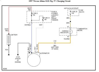

The charging circuit is rather simple and does not show any bypass resistor.
https://images.2carpros.com/forum/automotive_pictures/192750_ChargingCircuit97Altima_1.jpg
Since there was a recall on the alternator, I would not discount the possibility of bad alternators. The possibility of more than one bad alternator is there. The buzzing indicates power is being passed through the alternator IC regulator and that should be the main culprit. If you look at the circuit diagram, the system is different from most other cars which uses ignition switch power for the S terminal ( white) wire. Maybe you can consider changing the power source for this particular wire to operate only with ignition switch at ON and START.
Mar 11, 2021 at 11:24 AM (Merged)
STUDIOJ
  • 6 POSTS
Interesting. I have not had the dash apart (at least that part of it) but my Haynes manual shows a resistor in parallel with the bulb. I had thought about your suggestion as a simple solution to the problem. It seems odd to me that the mfg would not apply power to the regulator IC only in the key on or start position anyway. That may be the route I take. I had wanted to leave everything stock but I'm coming to the conclusion that the way the factory did it may have been just plain poor design. What really bugs me is that my original alternator was working fine before the recall fix! Thanks for the suggestion.

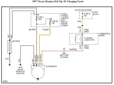

Just noticed that your diagram is for the Altima. Can you verify that the charge circuit is the same for the 97 maxima?
KHLOW2008
  • 41,814 POSTS
Sorry for the error. There are differences in the circuit and the resistor is across the charge indicator bulb. Unless the IC regulator is bad, otherwise the resistor should not be the cause of the problem.
https://images.2carpros.com/forum/automotive_pictures/192750_ChargingCircuit97Maxima_1.jpg
STUDIOJ
  • 6 POSTS
After ripping the dash apart and finding both the bulb and the resistor in the indicator circuit to be in good condition (it's a 100 ohm resistor BTW), and then tracing the circuit back to the alternator plug and verifying that if the wire on the indicator finds a path to ground the indicator light does indeed illuminate, I've concluded that yes, the regulator in the 3rd new alternator is bad. Since it takes about 2 hours to pull the alternator and since no shop will test the regulator before giving me another one and since I've had 3 bad ones in a row, I've decided instead to re-route the field wire on the alternator to a B+ position that is only on when the key is on. I don't know why they did not do this in the first place - makes a lot more sense than leaving the field energized all the time.
