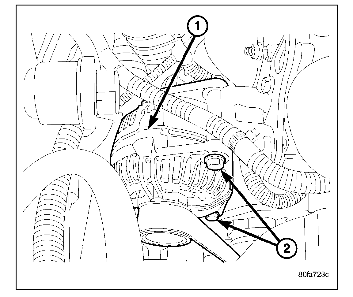

Okay, water pump was leaking so I changed the water pump. Started it up and let it warm up but now the alternator is not working. I am wondering why it would stop working. This is a 2006 Dodge 2500 heavy duty turbo Cummins. Any thoughts would be greatly appreciated. Thanks

By any chance, did coolant get into the alternator? It can cause it to short. The bad thing with coolant, it won't evaporate. Sharon, these trucks have a voltage regulator that is built into the engine control module (ECM). You don't want that to be damaged. If you checked it and it's not charging, I really recommend that you remove the alternator and have it bench tested at a parts store. Most will do it for free. If something fails in the alternator, I have seen them damage the regulator and then the vehicle requires the entire module.

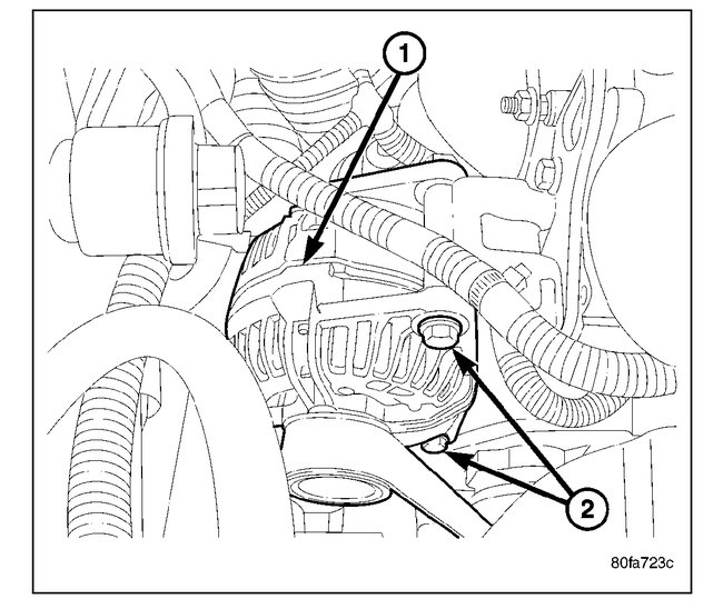

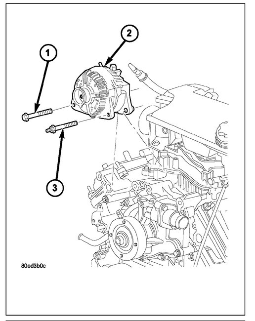

Here are the directions specific to your vehicle for removal and replacement. The attached pics correlate with the directions.
PROCEDURES
REMOVAL
WARNING: DISCONNECT BOTH NEGATIVE CABLES FROM BOTH BATTERIES BEFORE REMOVING BATTERY OUTPUT WIRE (B+ WIRE) FROM GENERATOR. FAILURE TO DO SO CAN RESULT IN INJURY OR DAMAGE TO ELECTRICAL SYSTEM.
pic 1
pic 2
1. Disconnect both negative battery cables at both batteries.
2. Remove generator drive belt. Refer to Cooling System for procedure.
3. Unsnap plastic insulator cap from B+ output terminal.
4. Remove B+ terminal mounting nut at rear of generator. Disconnect terminal from generator.
5. Disconnect field wire connector at rear of generator by pushing on connector tab.
6. Remove upper mounting bracket bolt (2).
7. Remove lower mounting bracket bolt and nut (2).
8. Remove generator from vehicle.

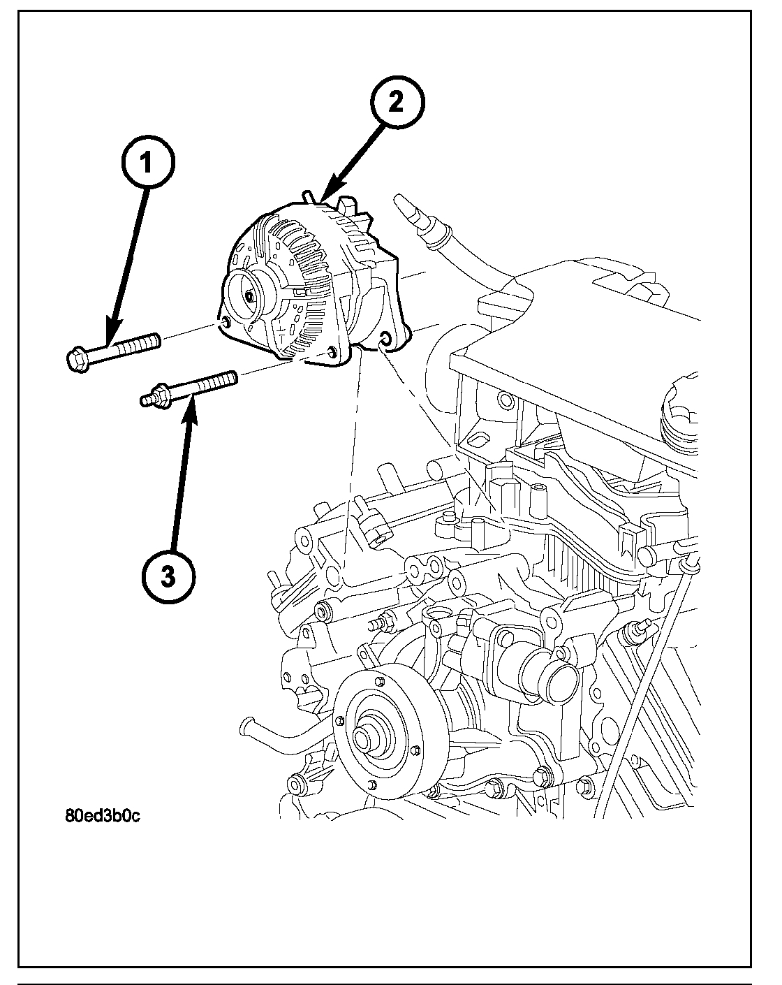

INSTALLATION
1. Position generator to upper and lower mounting brackets and install upper bolt and lower bolt/nut.
2. Tighten all bolts/nut. Refer to Torque Specifications.
3. Snap field wire connector into rear of generator.
4. Install B+ terminal eyelet to generator output stud. Tighten mounting nut. Refer to Torque Specifications.

Thank you for all the information. I checked the voltage of both batteries one read 18 volts the other battery wasn't getting charged. Thank goodness it was a simple wire connection so I cleaned this up and the alternator was doing its job properly. Thank you so much for your quick response.i think it's great you guys can answer my questions. Thanks again.
