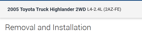

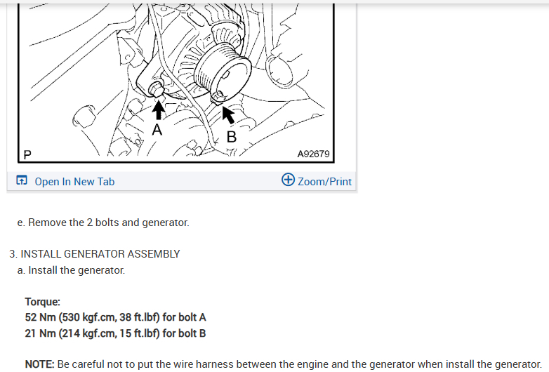

It sounds like the alternator is failing. It's odd that by tapping it, you make it work again. Check to make sure there are no connection issues at the alternator. Also, make sure the alternator mount is tight.

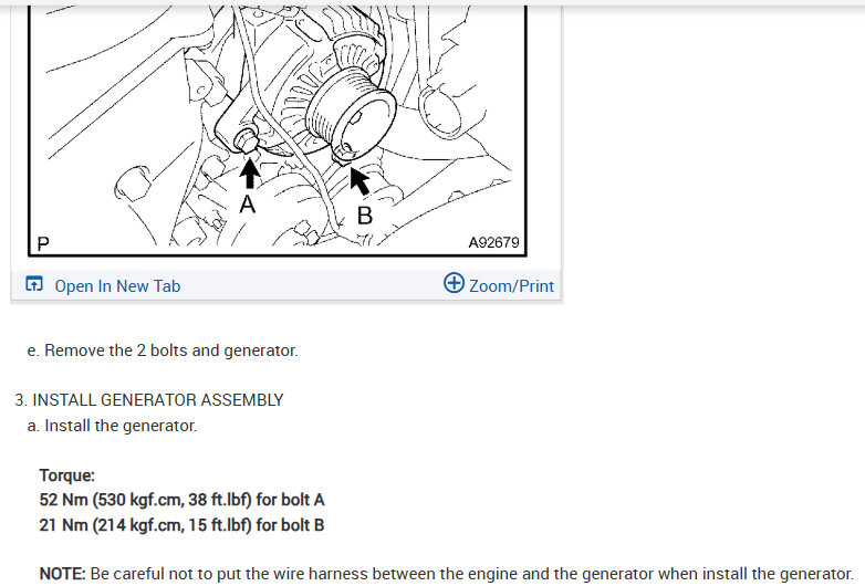

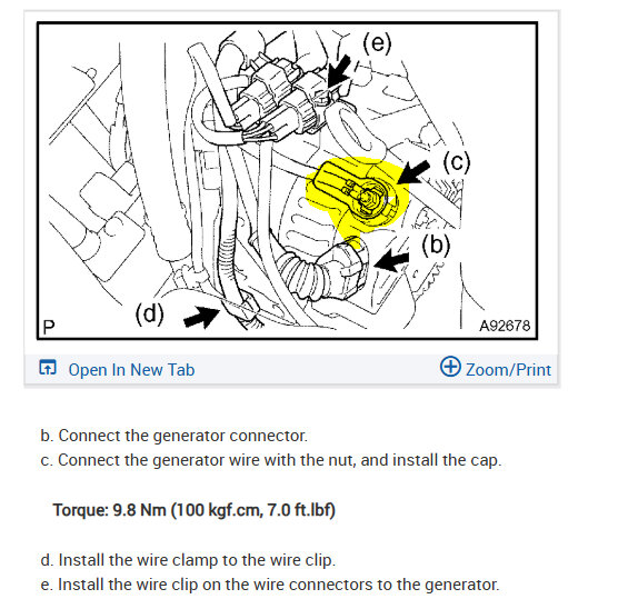

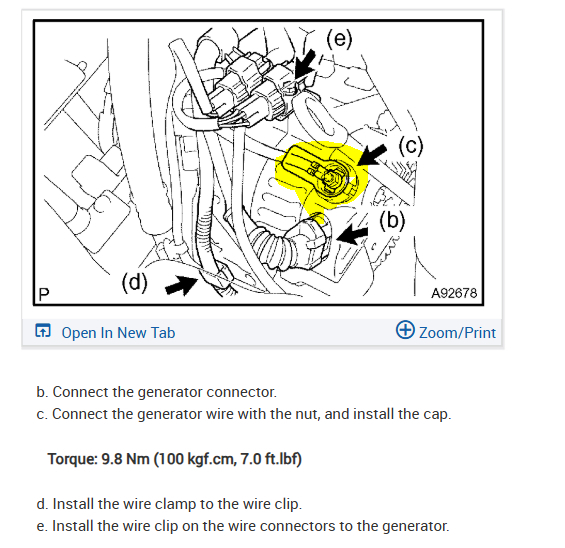

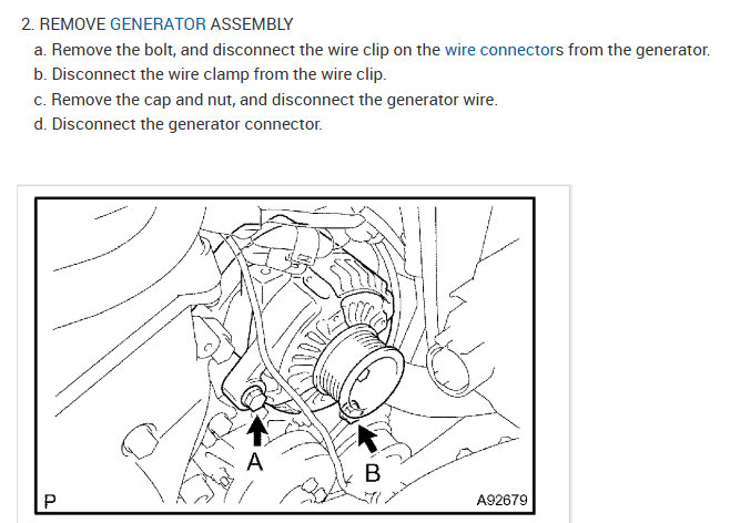

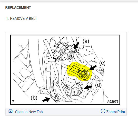

If the connectors are in good condition and free of damage and corrosion, then the alternator should likely be replaced. If you look below, I attached the directions from my manual for replacing it. Additionally, here is a link that may help you as well:
