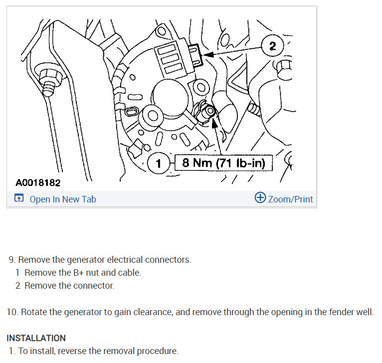

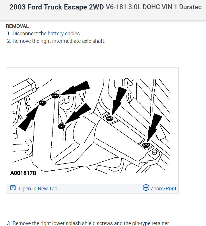

Battery light has been going on but later turns off. Recently noticed radio turns off than back on. We first thought it was our battery,took it to autozone and was told battery was good. System test passed. Took it back this morning and was told it was the alternator. My question is where is the alternator on my vehicle and how hard is it to replace. Any help would be appreciated, this is our only vehicle .
Jun 14, 2024 at 7:58 AM
  • 55,433 POSTS

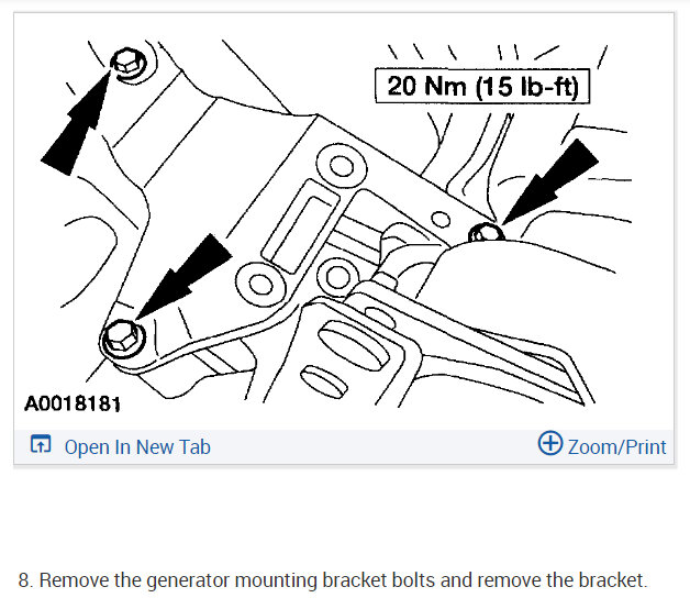

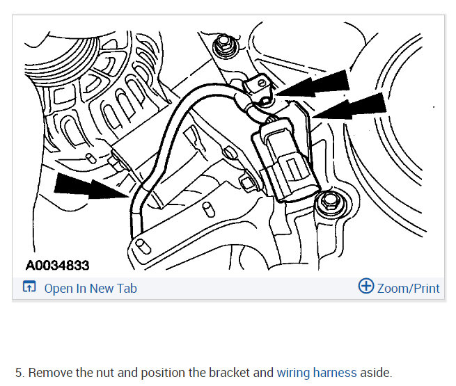

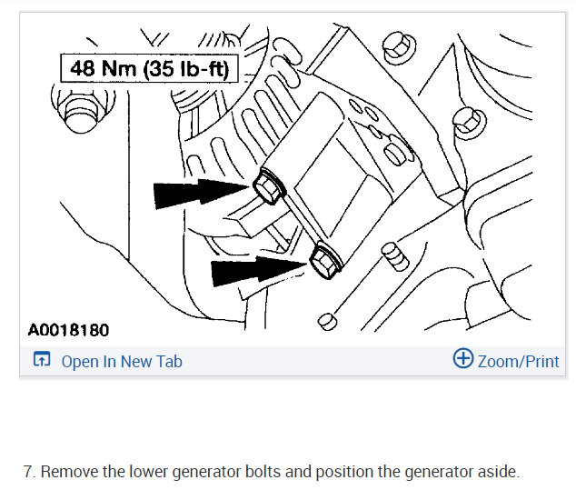

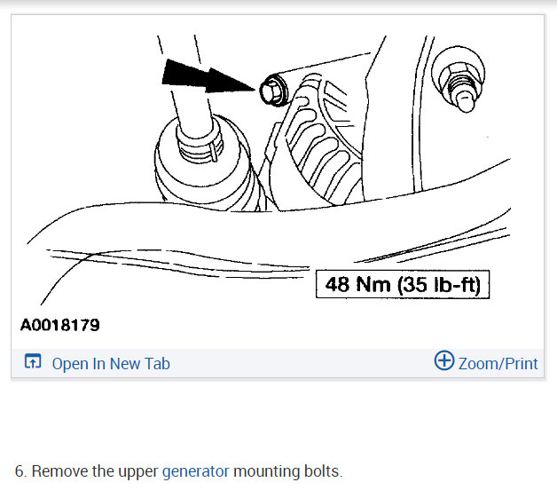

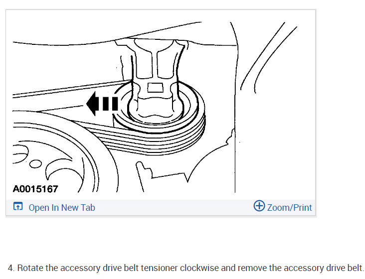

It does not look like it is that bad to change but you will need to raise the car up onto jack stands to replace the alternator.
Here is a guide to help:
Here are the step-by-step instructions for the alternator replacement, please let me know if there are any questions. Check out the images (below). Let us know if you need anything else.

Thank you, got a new alternator put in and seems liked the problem is fixed.
