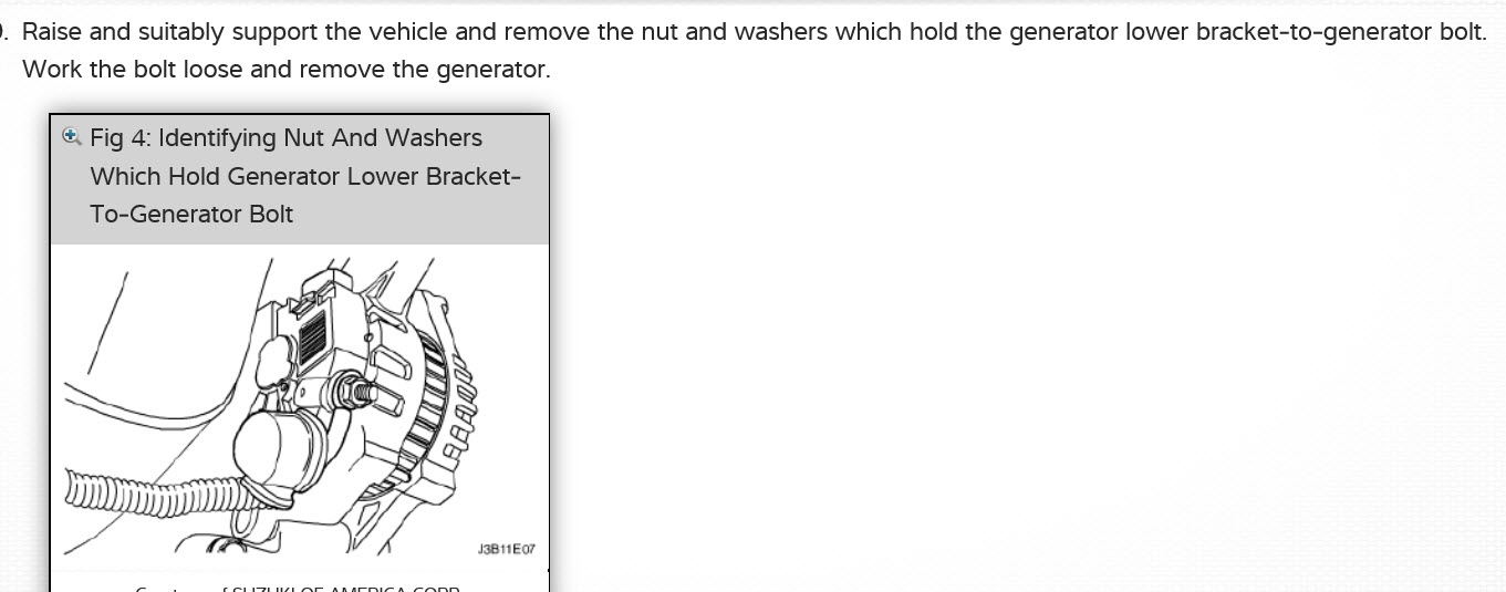

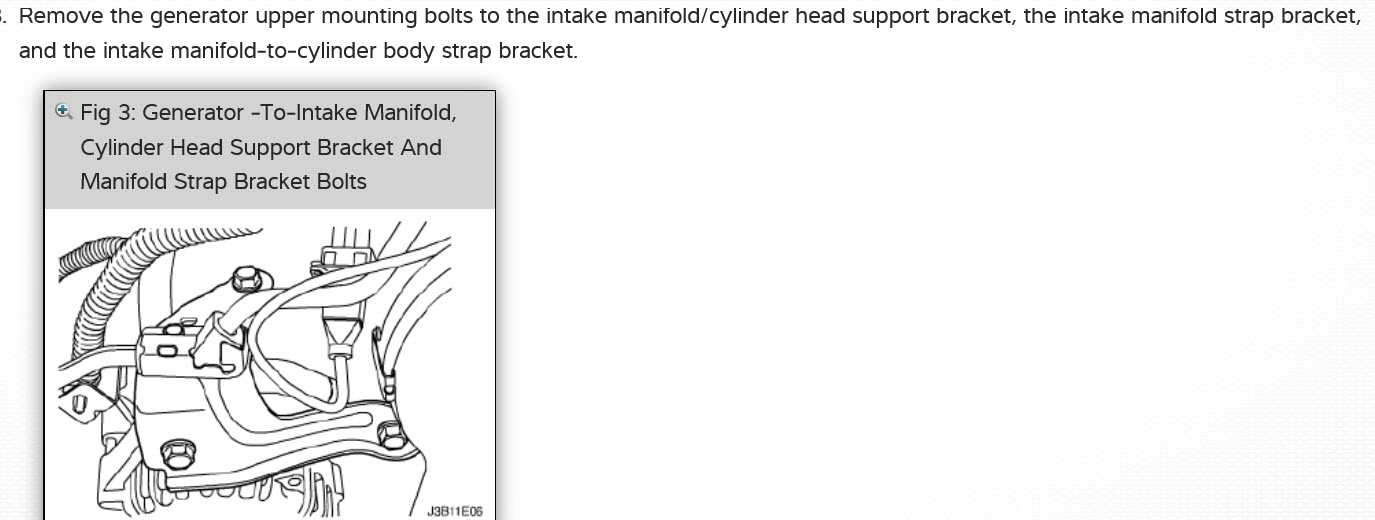

how to change the alternator in my 2006 suzuki reno
Aug 29, 2016 at 8:24 AM
HMAC300
  • 48,601 POSTS

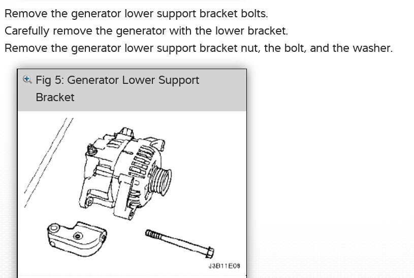

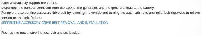

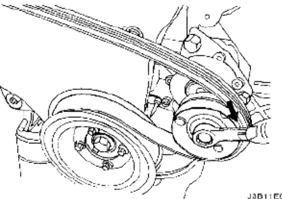

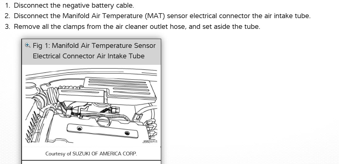

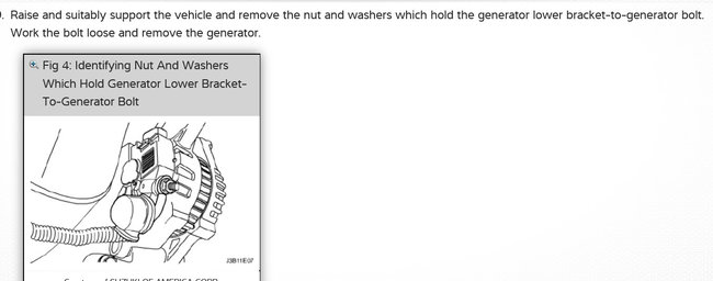

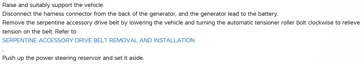

see pics for removal reverse for install
