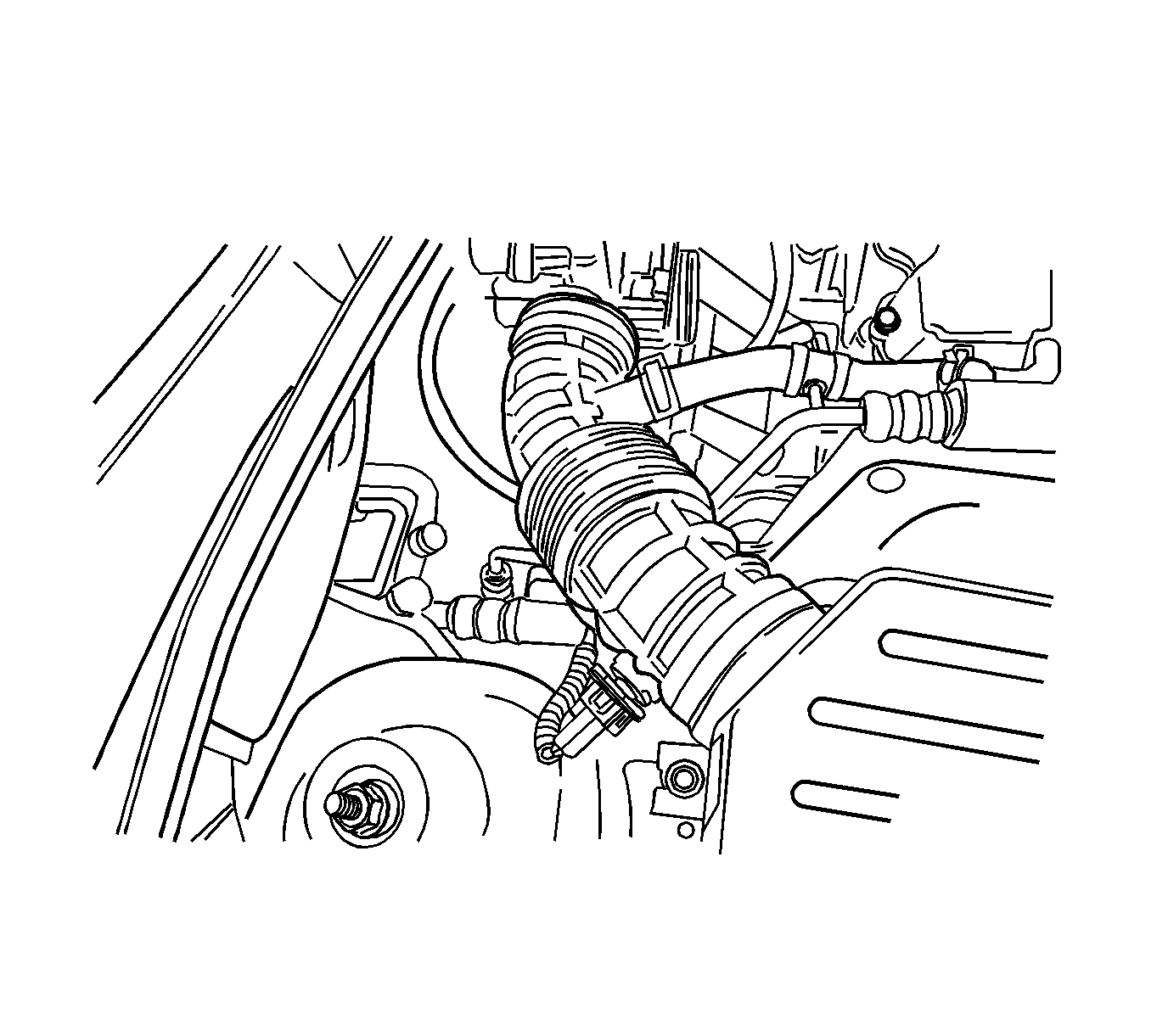

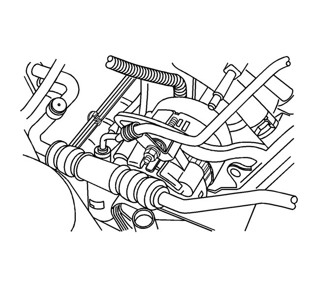

picture 1
1. Disconnect the negative battery cable.
2. Disconnect the intake air temperature (IAT) sensor electrical connector from the air intake tube.

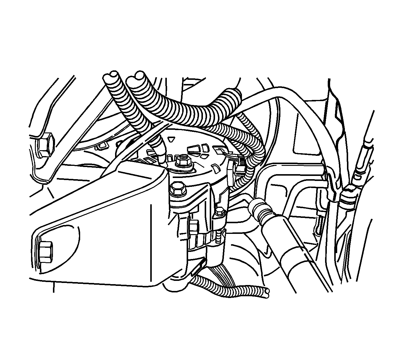

picture 2
3. Remove the breather tube clamp and all other clamps to remove the air intake tube.

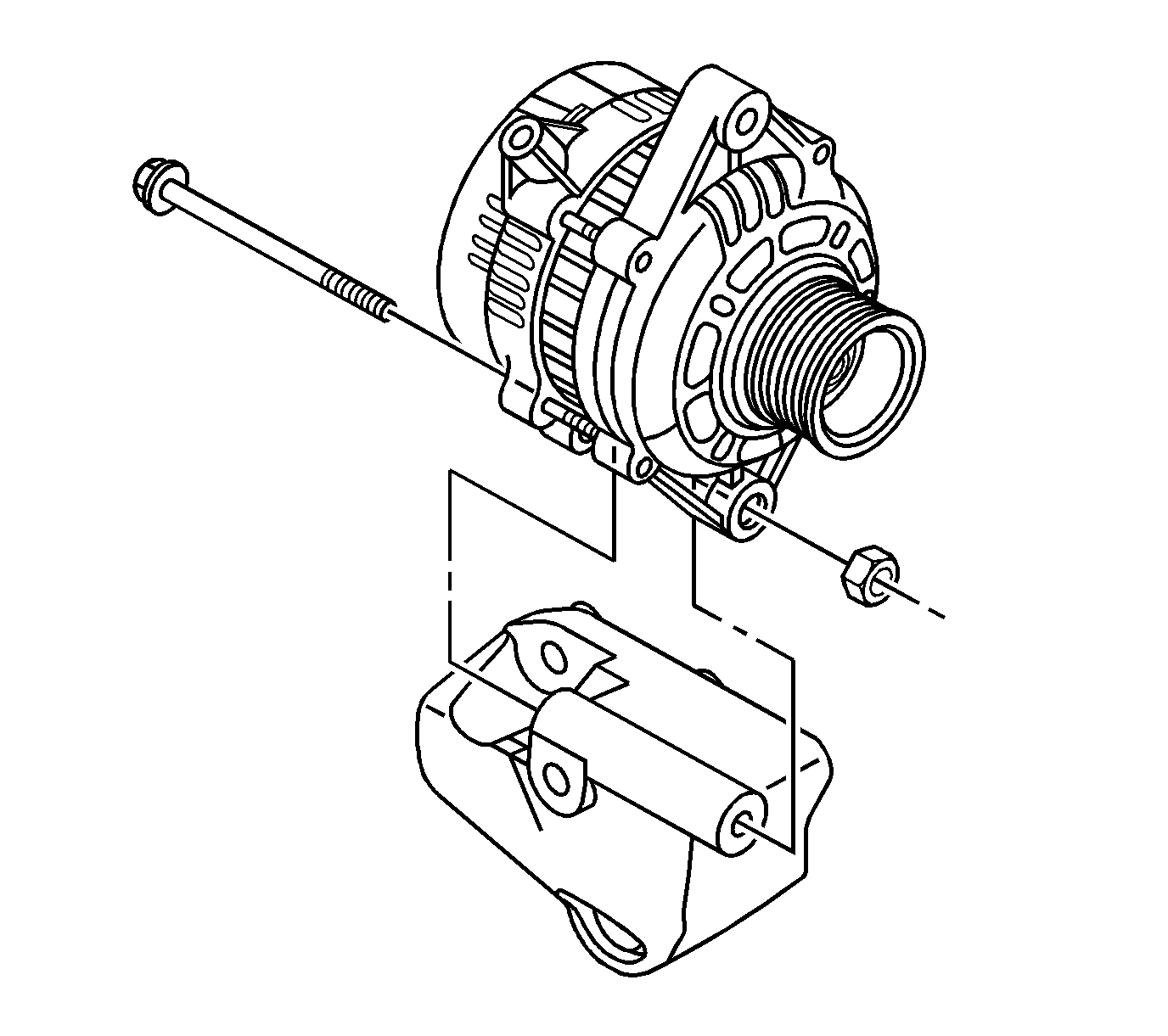

picture 3

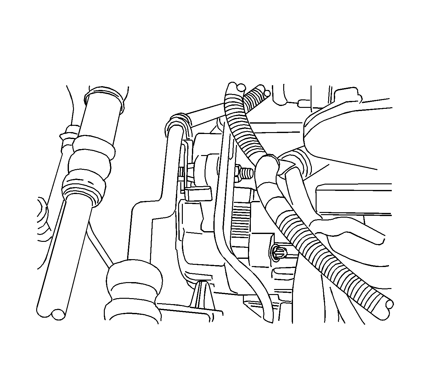

4. Remove the battery harness connector nut from the generator.

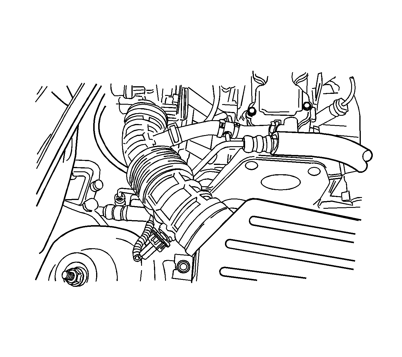

5. Remove the generator shackle bracket bolt.

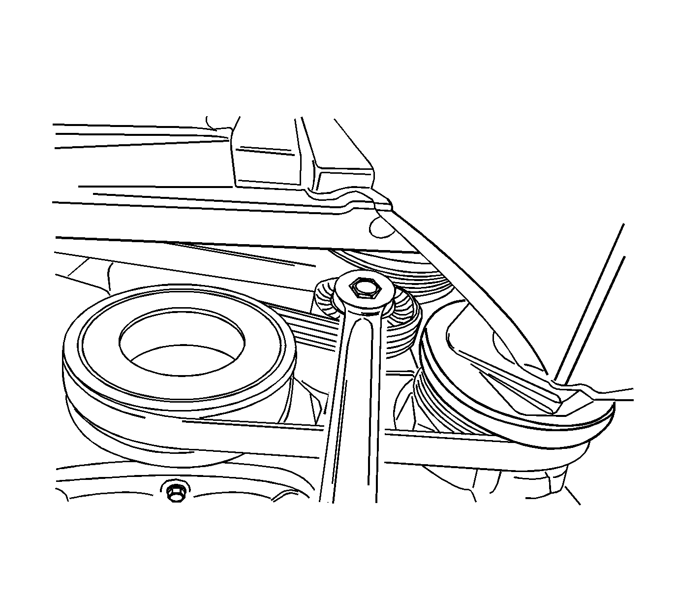

6. Remove the serpentine accessory drive belt. For vehicles equipped with power steering and air conditioning.

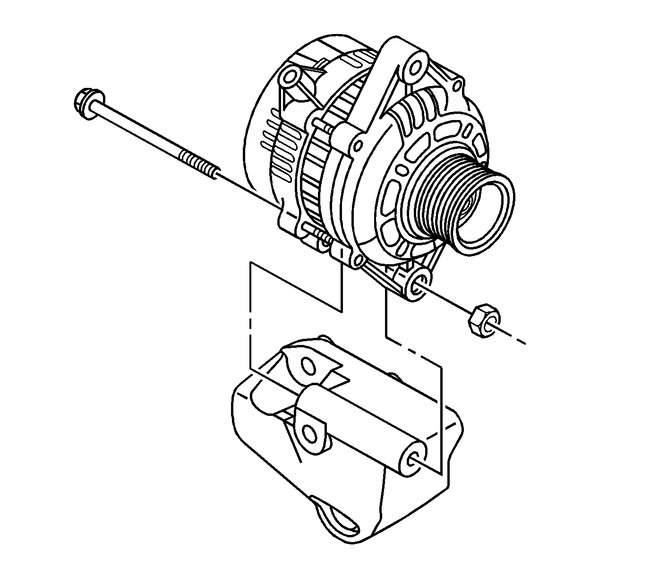

picture 8
3. Install the generator and the lower support bracket assembly to the engine block with the bolts.
4. Secure the generator to the shackle bracket with the bolt.
Tighten the generator shackle bracket bolt to 25 N.m (18 lb ft).

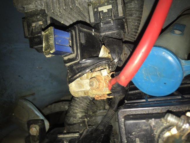

I think the alternator doesn’t kick on sometimes because sometimes the battery goes dead. I can tell when the alternator is working and when it isn’t by the clock on the dashboard, when the alternator is working as it should the clock is bright, but when it isn’t it isn’t as bright and it will soon dim and the car will shut off. But I think it’s connection because when the clock is dim none of my lights around it, like the air bag and seat belt don’t come on either. When I turn my key over the engine and oil light won’t come on or anything, that’s usually an indicator it isn’t going to work. Before I switched the negative terminal my dash lights would flash on and off so I thought it was probably a bad ground not letting the battery charge. Also, on my positive terminal there is a thick wire running from where my terminal, acting as a possible extension cord I’m assuming. I thought maybe that could be the issue as well. I will send a picture of it because explaining it would be confusing.
Feb 24, 2019 at 10:46 PM
BRITTANY296564
  • 5 POSTS
In this picture I have that wore clamped between where I think a normal terminal could go. It isn’t spliced in anywhere. Could that be a possible problem?
Feb 24, 2019 at 10:51 PM
  • 110,194 POSTS
Is that cable running from the positive terminal of the battery?
Feb 25, 2019 at 7:39 PM
BRITTANY296564
  • 5 POSTS
Yes.

Today I bought a terminal with a cable on it to make it a proper connection. I’m going to see how that works.
