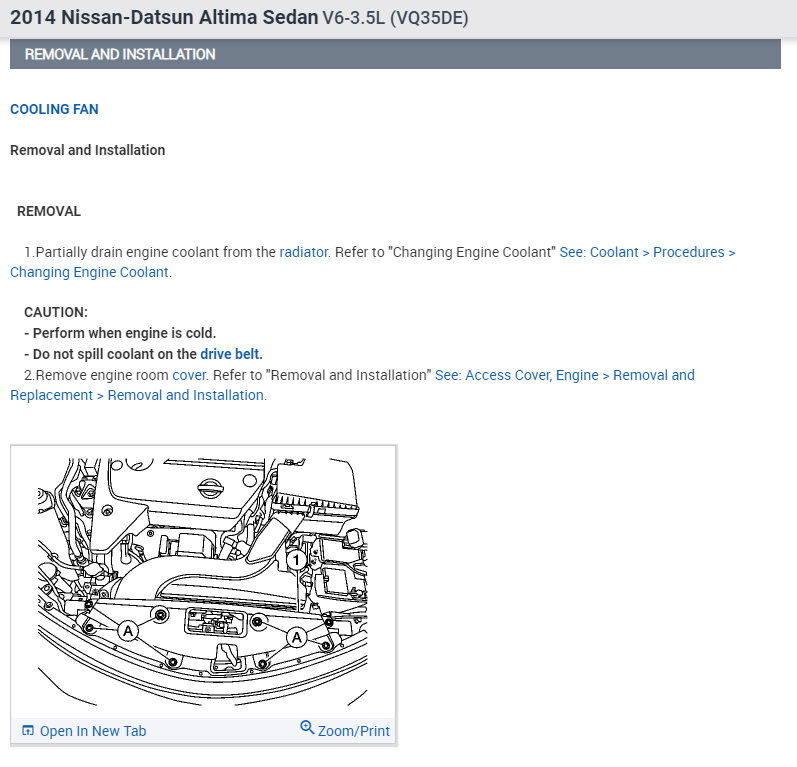

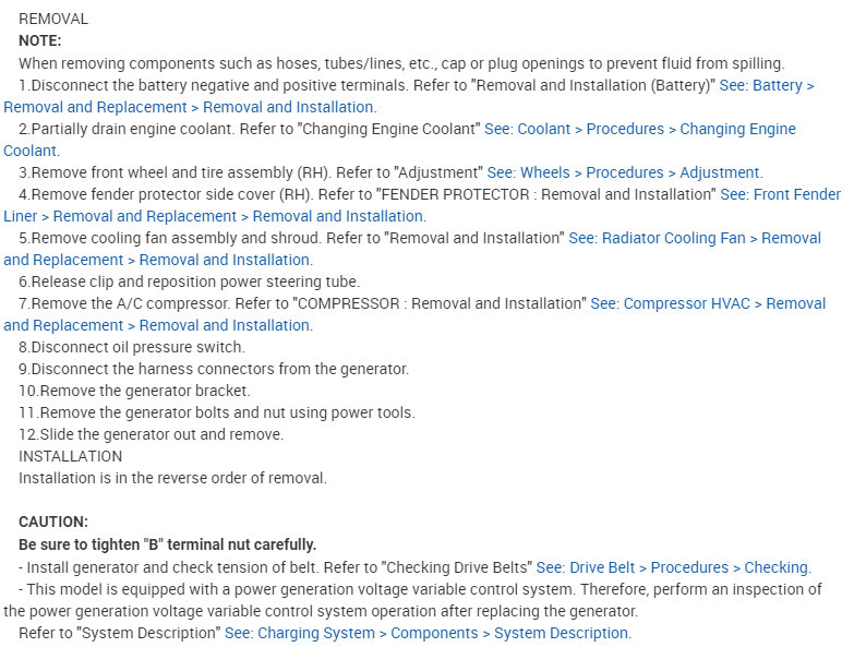

Need a guide to replace the alternator.
Feb 7, 2022 at 3:53 AM
SQM
  • CAR REPAIR CONTRIBUTOR
  • 6,383 POSTS

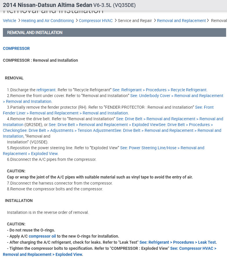

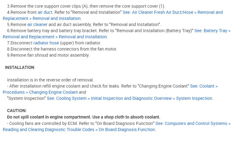

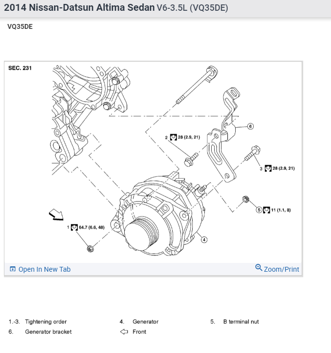

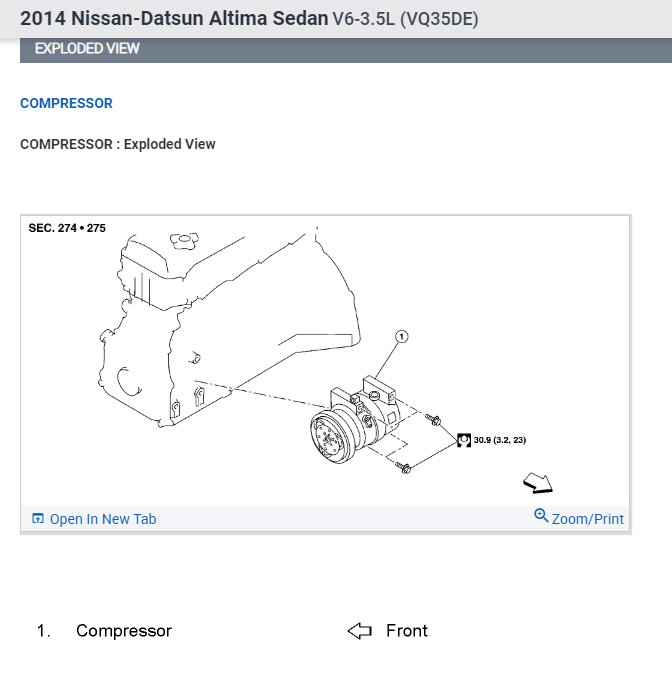

In order to replace the alternator, you will have to first remove the front passenger side wheel and remove the inner fender liner. Then the A/C compressor will need to be removed and the radiator fan. It will also require partial draining of the coolant system.
I have attached the steps below.
If you need any further assistance, please let me know.
https://www.2carpros.com/articles/how-to-replace-an-alternator
