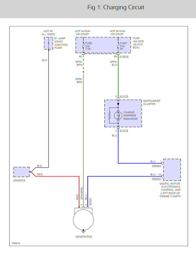

Okay, so I have the car listed above (model i). I just got a new battery for it and it is not charging. I replaced my alternator in 2015. I did an alternator test on it. It says it is running 120 amp but not charging battery. The alternator itself is 120 amp. So I do not know what to do. Can you help?
Jul 11, 2018 at 4:19 AM
  • 55,732 POSTS
It cannot charge at 120 amps and not give some kind of charge voltage. Is the alternator a Bosch rebuild? Cheaper rebuilds do not work right. But to be sure lets check the wiring to makes sure you do not have a connection issue. Check fuses f30 and f34.
