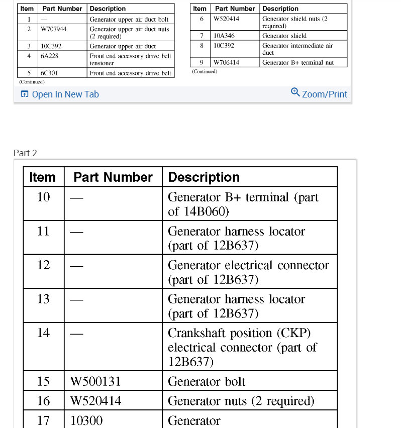

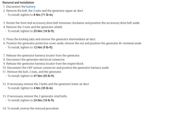

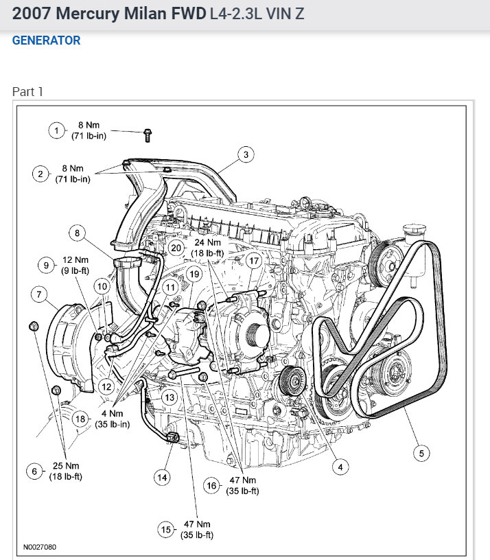

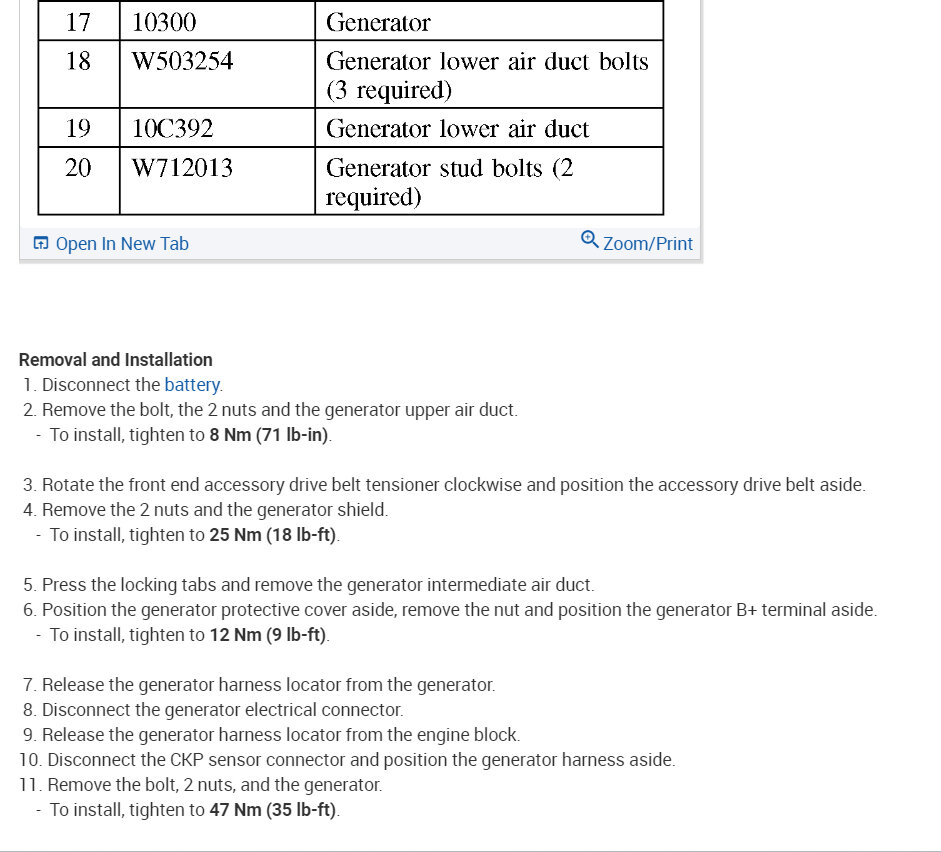

Any diagrams on how to remove and replace an alternator for the vehicle listed above?
Jul 8, 2023 at 1:43 AM
  • 55,433 POSTS
It looks like the alternator replacement is pretty straight forward but if you have any issue, please let me know. Here is a generic guide to help you step by step with instructions in the diagrams below to show you how on your car:
https://www.2carpros.com/articles/how-to-replace-an-alternator
