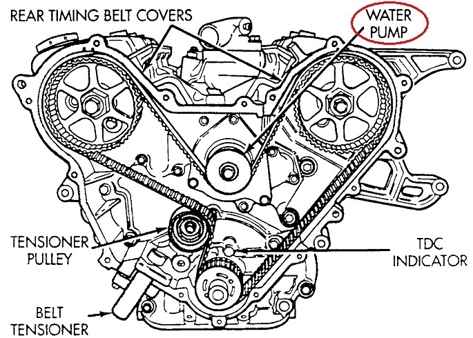

Car was making intermittent rattling noise in the engine area. Gas station guy thought it might the water pump going out. Stopped driving it, but once in a while i idled the car so the battery wouldn't go drain. One day i idled it and went inside for a bit and when I came back the car wasn't running. Plenty of gas. Not only that, battery had drained and had to be recharged. When I recharged it starts up and runs like a champ. I thought it must be the alternator. But when I put multimeter on battery terminals while car is running, it's over 14 volts.
What do you think? no water leaking on the ground, at least yet.

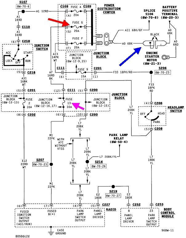

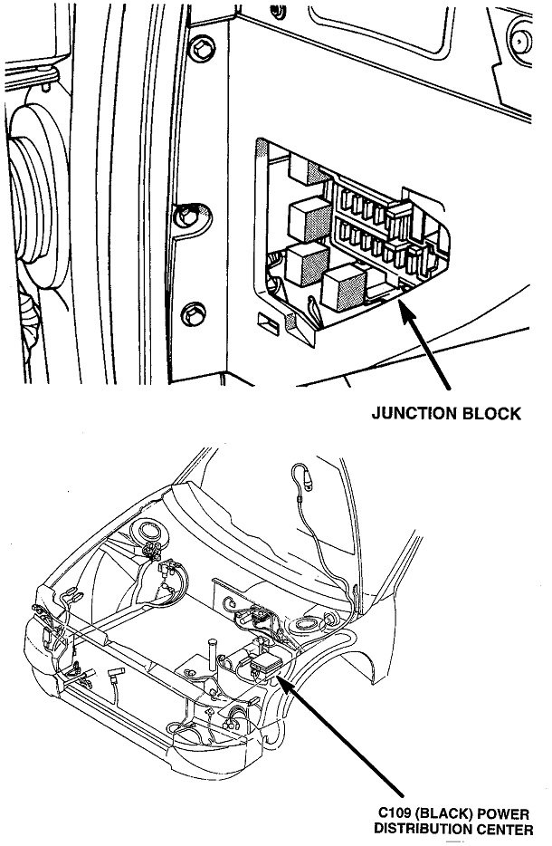

I can't find a reference to the IOD fuse but I do remember the radio's 12-volt memory circuit was involved, so I posted the first part of the diagram for that. You'll have to look at the fuse box covers to see if one of these is labelled "IOD". The blue arrow is pointing to the bullet connector near the back of the battery. Unplugging that will stop the current drain on the battery but everything will be inoperative. You'll have to reconnect it to start the engine.

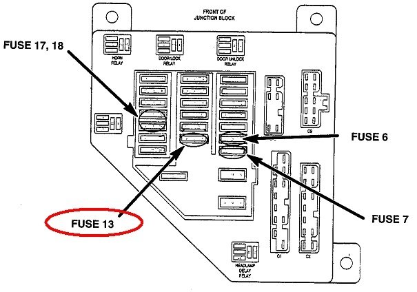

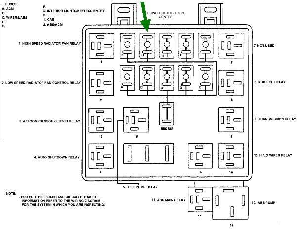

The red arrow is pointing to "fuse G", a 20-amp in the Power Distribution Center under the hood, also next to the battery. The pink arrow is pointing to "fuse 13", a 10-amp in the Junction Box. That's the fuse box inside, at the left side of the dash assembly. Fuse 13 is circled in the third drawing, and the green arrow in the fourth drawing is pointing to Fuse G
