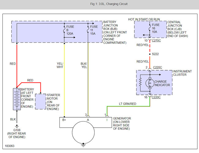

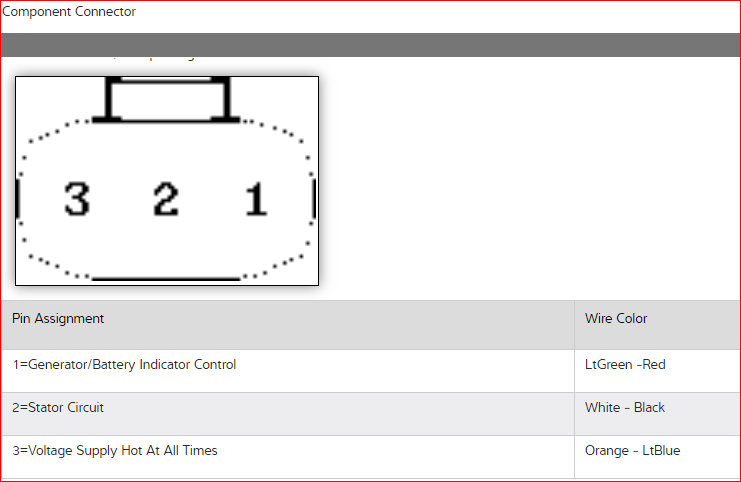

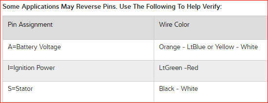

When replacing alternator it fell and pulled out two of the wires out of the 6G generator connector. The brown/red in terminal three is still there. The green/red and violet wires are the wires I need to know which terminal they go to. The brown/red goes to the battery junction block, fuse #6. I think the green/red is for the indicator light but do not know which terminal it goes to.

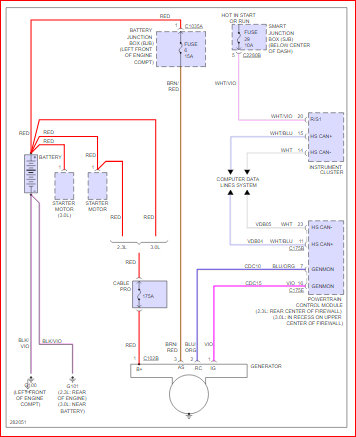

Hello, I am Danny.
I have attached two pictures for you. Hope this helps and please ask any questions if needed. Thanks for using 2CarPros.

So the #2 pin should go to the PCM and #1 pin should go to the instrument cluster then to the central junction block. What is the pin at the PCM #2 connects to, in my case it would have to be my VT wire. I want to check that circuit, ohm the wire.
The wiring diagram Chilton has shows the green/red wire ending at the CJB, what fuse? Can I check continuity from the 6G connector to the fuse. I know the ohms will be high due to going through the instrument cluster but will the be continuity?

I found this picture that is more detailed. This has all components in the charging circuit. Hope this helps more and thanks again for using 2CarPros.

Here is a wiring diagram for the alternator and the rest of the system so you can fix the problem and get back on the road. (Below) Please let us know if you need anything else to get the problem fixed.

You need the light green with red and the black with yellow wires. On the original connector they would be the two outer wires. Pins one and three.
