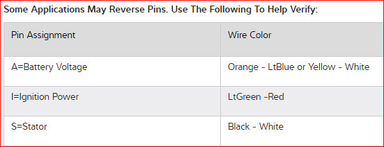

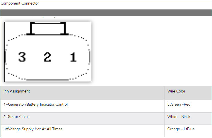

When replacing alternator it fell and pulled out two of the wires out of the 6G generator connector. The brown/red in terminal three is still there. The green/red and violet wires are the wires I need to know which terminal they go to. The brown/red goes to the battery junction block, fuse #6. I think the green/red is for the indicator light but do not know which terminal it goes to.
Jul 20, 2018 at 7:45 PM
DANNY L
  • 5,648 POSTS
Hello, I am Danny.
I have attached two pictures for you. Hope this helps and please ask any questions if needed. Thanks for using 2CarPros.
Danny-
Jul 20, 2018 at 8:53 PM

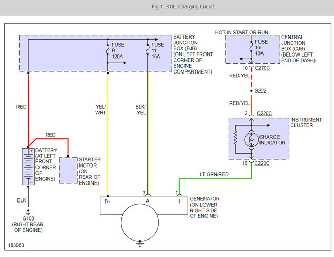

BILL BRATINA
So the #2 pin should go to the PCM and #1 pin should go to the instrument cluster then to the central junction block. What is the pin at the PCM #2 connects to, in my case it would have to be my VT wire. I want to check that circuit, ohm the wire.
The wiring diagram Chilton has shows the green/red wire ending at the CJB, what fuse? Can I check continuity from the 6G connector to the fuse. I know the ohms will be high due to going through the instrument cluster but will the be continuity?
Jul 21, 2018 at 3:58 AM
DANNY L
  • 5,648 POSTS
Hello again.
I found this picture that is more detailed. This has all components in the charging circuit. Hope this helps more and thanks again for using 2CarPros.
Danny-
Jul 21, 2018 at 4:53 AM

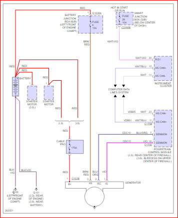

I was replacing the alternator because the battery light was on and when I took off the three bolts to the alternator and turn the alternator to take the plugs off I notice that the center plug wire was cut and that the other two outer wires were spliced in with other wires. AutoZone has the replacement pigtail but I do not know where those three black wires go. Any and all help will be appreciated. I know the other two wires are wired in but I just need help with that center wire or maybe all three wires if someone could help me? Thank you
Dec 22, 2020 at 9:13 AM (Merged)
  • 54,832 POSTS
Here is a wiring diagram for the alternator and the rest of the system so you can fix the problem and get back on the road. (Below) Please let us know if you need anything else to get the problem fixed.

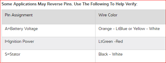

HUMPHREY CHAI
The plug in part that comes from the car side of the alternator had to be changed and the new plug in had three wires and I only have two wires. Which wires do I hook up to on the new plug in? The two outside wires or one in and the middle wire or middle wire and the other side? It gets confusing and now I am getting my battery fully charged, because you cannot start the car with a 11.50 volts battery.
STEVE W.
  • 15,200 POSTS
You need the light green with red and the black with yellow wires. On the original connector they would be the two outer wires. Pins one and three.
