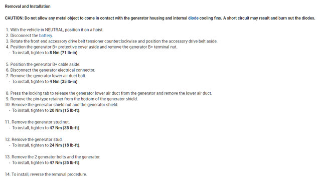

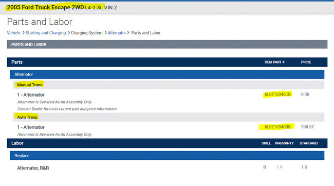

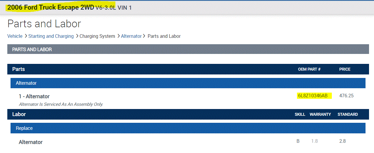

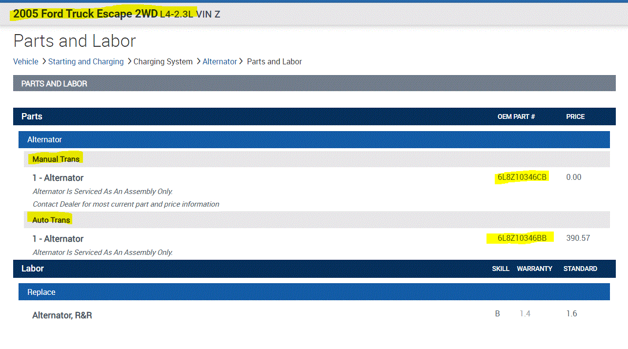

I was wondering if i can use an alternator from 2006 6 cylinder to replace my 2005 4 cylinder alternator?
Jun 9, 2021 at 4:29 AM
  • 110,241 POSTS
I looked up part numbers for both of the vehicles you mentioned. They have different part numbers, so I would not recommend it.
If you look at the first two pics below, it shows the part numbers and labor time.
As far as replacement, here is a link to help you get started. You can use it as a reference.
https://www.2carpros.com/articles/how-to-replace-an-alternator

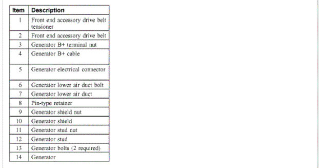

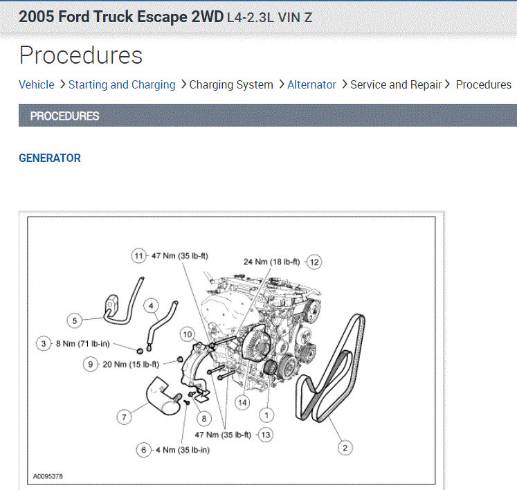

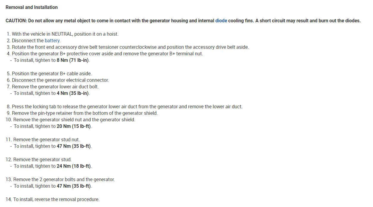

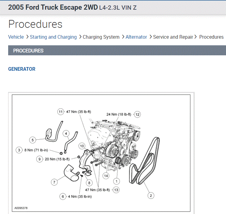

The remaining pictures are for replacement specific to your vehicle.
