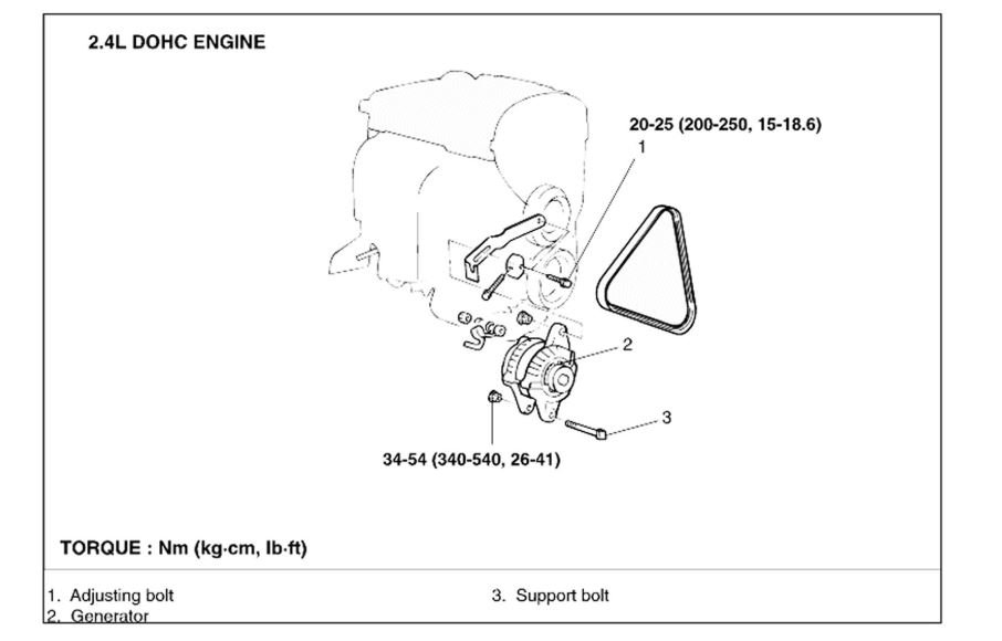

Not sure if this is true or not..
I just recently had to replace my alternator and instead of buying a new one, I got one from a car at pick n pull. It lasted only a week and a 1/2 and it started showing the same symptoms as when my last alternator went out.. battery light flickering on dash, slow wipers, dim lights etc.. So I have ordered a new one online to have put in. But the guy who is doing the work for me just told me that he heard that on Kia's when you switch alternator's, that you have to reprogram the brain or it for some reason will keep frying the Alternator's.. is that true, and if so, what do I need to do before putting this new one in?

That is inaccurate information. The alternator is not a module and does not require any programming at all. It is a plug and play.

That is not true of generators. Reprogramming computers is a trick dreamed up by GM to force you to go to the dealer for a lot of repairs, and most other manufacturers copied this customer-unfriendly business practice. You need to find a different mechanic. As proof, if this was true, your replacement generator would not have worked at all.
There'are two bigger concerns. The first is there is a pretty good chance the generator is not the cause of the problem. The symptoms you described are not likely to be exactly the same with two different generators, and it is much more common to find corroded connector terminals or other wiring problems. I recently helped a fellow with a Kia who ended up finding three corroded wires, then he learned this is a common problem on this brand.
