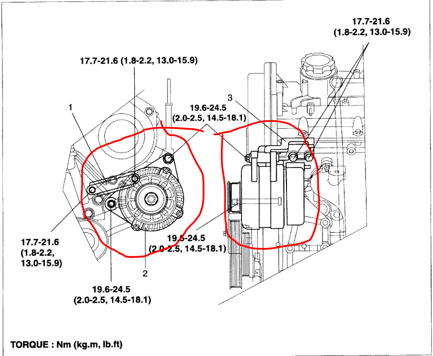

i am trying to locate the alternator.

If you are standing at the front of the vehicle, it will be at the front of the engine and to the right. See picture 1 below for mounting locations. I circled the alternator. It is pictured from two different angles.
