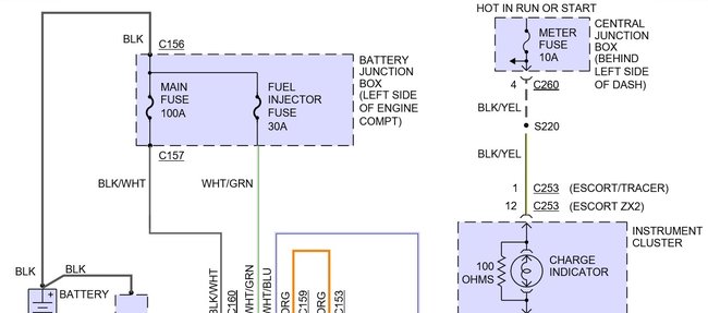

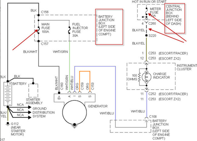

My alternator went out. Bought new one and installed it. Ran for a day then 30 amp fuel injector fuse blew out. Replaced it car ran, but new alternator went bad. Had alternator checked it was bad. Had a new alternator checked before installing was good. Also had battery checked. They said it was bad so I bought new battery. Before installing battery put in new alternator then connected battery. Started car fuel injector 30 amp blows. Replaced fuse. Car started but charge light was on. Took new alternator off had it checked showed bad. Same alternator they checked before I bought it. So alternator still under warranty. Just taped off wires to alternator without installing it.car started fine and drove. Why would alternator keep going out immediately when car is started?

You can check wiring circuits to and from alternator and battery. I do not know if injector fuse blowing has anything to do with alternator? If you have a digital multi-meter, you can do some testing on your charging system. If the system is overcharging or undercharging, hopefully it will show up with testing.

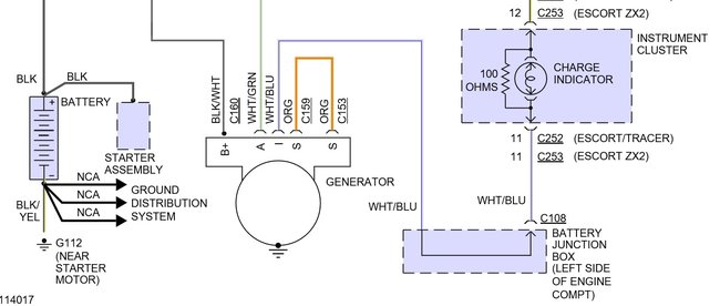

Had both re-manufactured alternators tested before installed. Had third one checked before taking it. Tested good. This is my wiring diagram.

Your injector fuse is involved, Our information says terminal A is hot all the time. You can check that circuit.

Took my car to the pro's. Was a ground issue not sure exactly where till I pick up my car. They replaced alternator belt and some wiring $95.00. Happy camper. Thanks for your help.
