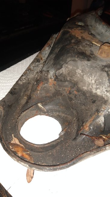

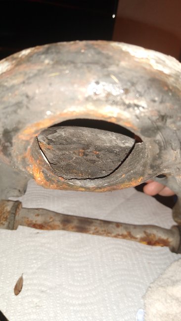

The upper control arms are bad I cannot find replacements everyone that I find the screw in ball joints the thread is worn out. so every time I put one in the ball joint pops loose. is there a alternate control arm I can use that is either pressed screwed or riveted in place to where I don't have to worry about them popping out? A mechanic suggested welding in place to help the worn out threads hold the ball joint I'm at wits end and don't want to junk my truck. The picture is of the last control arm failure the ball joint came out and did not notice until I went for alignment ruined the third ball joint and this upper control arm. please help. can I use the second gen upper control arm or if not a suitable replacement. Thank you

I have owned Dakotas for the past 20 years. There is no optional ball joint. Where all have you tried finding a good control arm?

Have you tried a local aftermarket 4x4 parts store? I would think a place like 4WheelParts could answer your question or put you in contact with somebody. Let me know if you have any further question about this. I'll do more research. Hope this helps and thanks for using 2CarPros.

The last one was a junkyard component. I have looked at local parts retailers, online like Rock Auto and others. local mechanics tell me I can't use 4x4 components unless convert everything else too like up and lower spindle and sway bar. I was told could fabricate on but it is a very expensive choice.

Have you tried the online salvage yard locators? Plus, I just looked on craigslist and there is a 94 2wd for parts. I have no idea where you are located, but I know you should be able to find one used.
