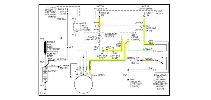

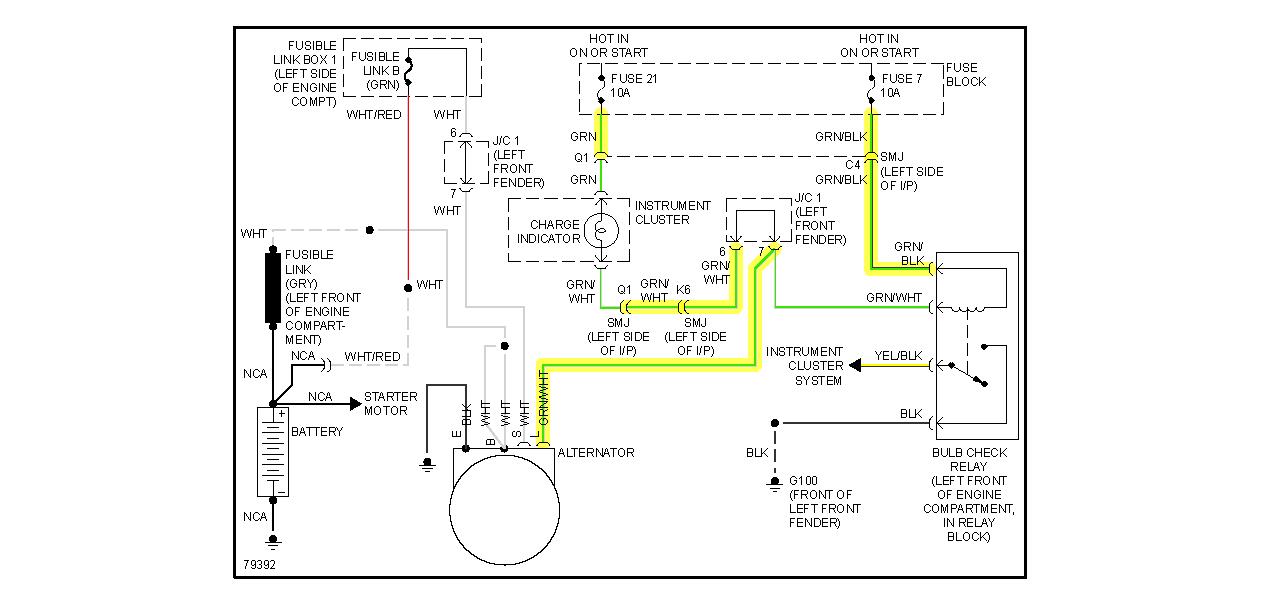

WILLIE 93
alternator not charging replace with a new one from nissan work for one week replace battery sears diehard 93 nissan maxima sohc 3.0 battery light in dash does not work when i switch car on please some help paid out over $900.00 so farnow mechanic say it need computer
Mar 11, 2021 at 11:27 AM (Merged)
  • 75,992 POSTS
Check and test fuse 21 and 7 in fuse block and check for battery voltage on the white at back off alternator and should power on the green and white on the alternator-
WILLIE 93
fuses are good has fire at white wire on back of alt green&white wire has low voltage on it test lite is very dim
  • 75,992 POSTS
Bring it in and have it load tested
