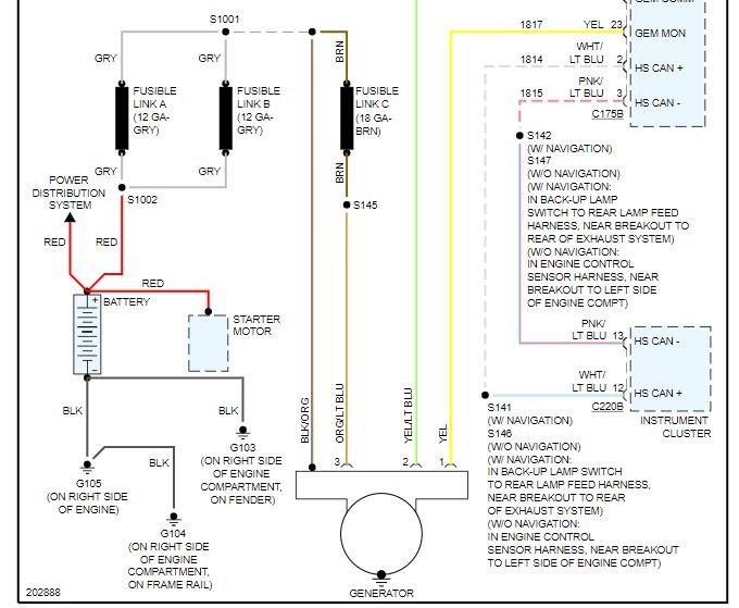

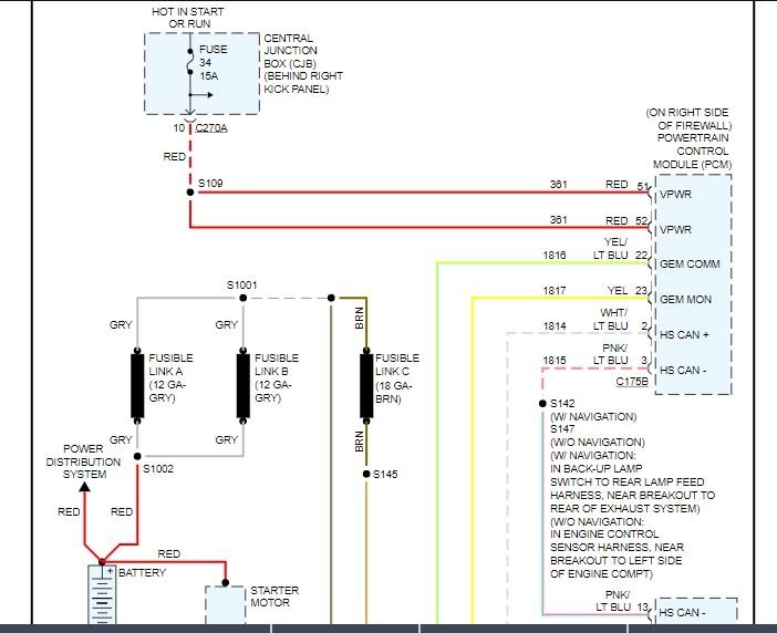

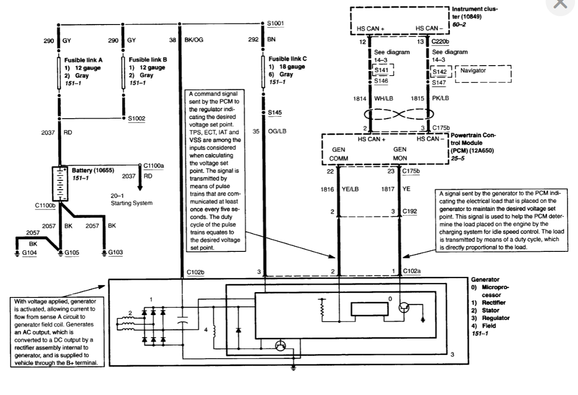

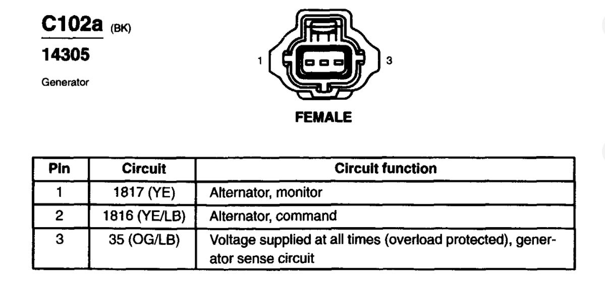

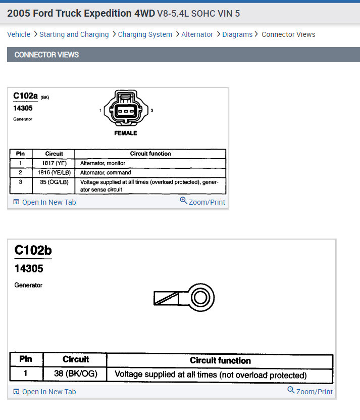

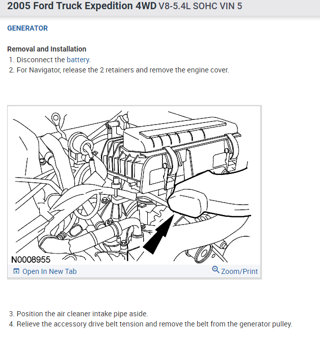

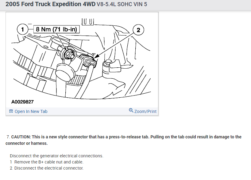

The 'I' pin is the alternator sense circuit, voltage supply at all times, and the 'A' pin is alternator monitor.
Couple of helpful articles on wiring:

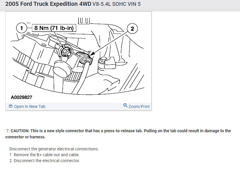

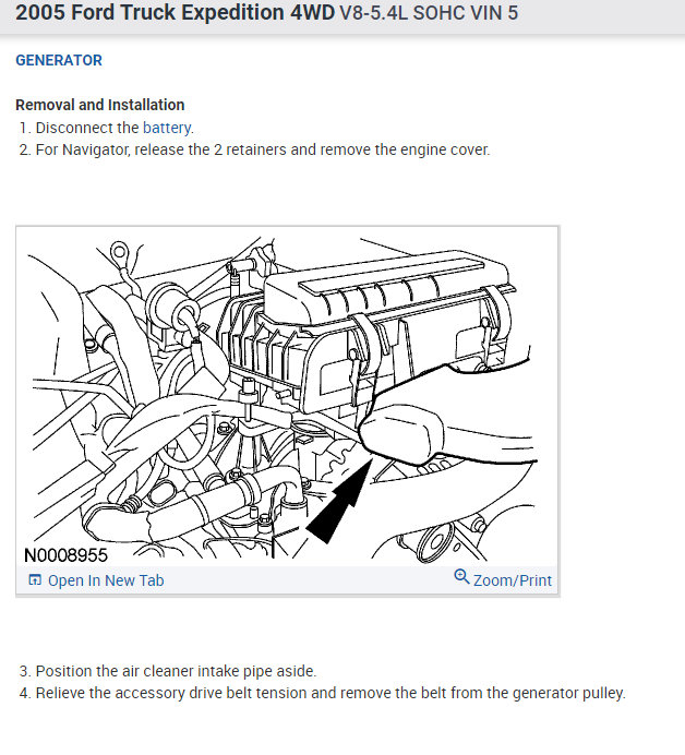

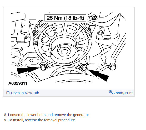

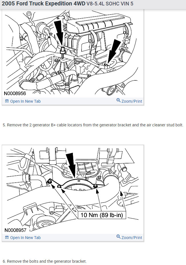

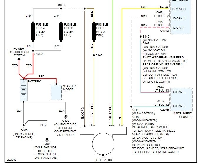

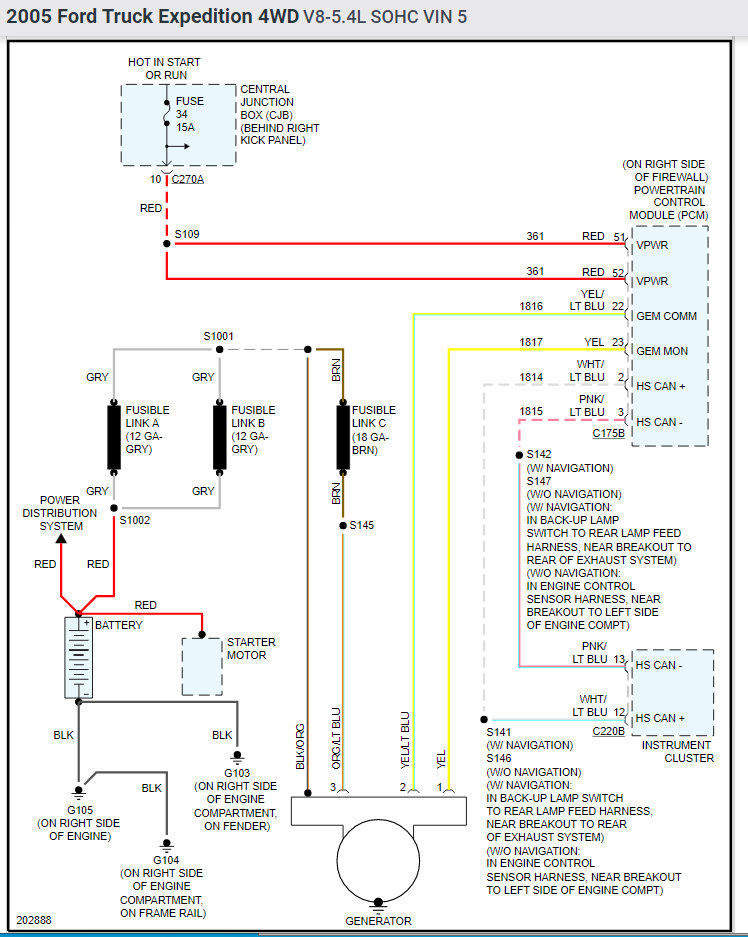

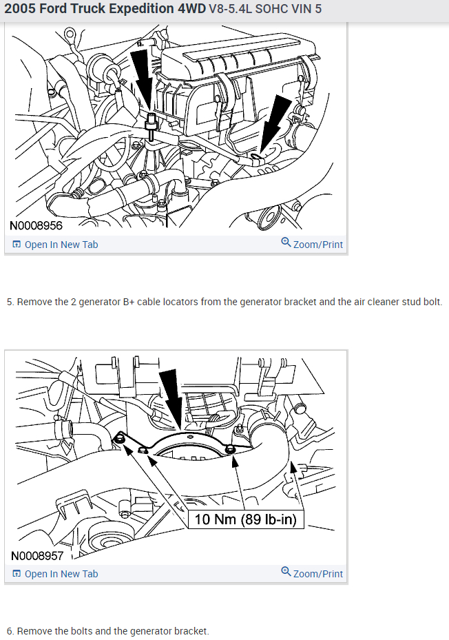

I have attached the wiring schematics of the charting system as well as the alternator replacement procedure your reference.

Sir/ Madam,
Based on your response , The "I" pin connects to positive power on the battery and the "A" pin would connect to Negative ground through a gage or light or a diode .
Is that correct????

CUSTOMER
I only have 2 wire "A " and " I " (marking on connector).

Good evening,
I attached the wiring diagram of the charging system for you as well as the connector diagram with the location of the wires for you.
Let me know if you have any other questions.

Yes, that is correct.
