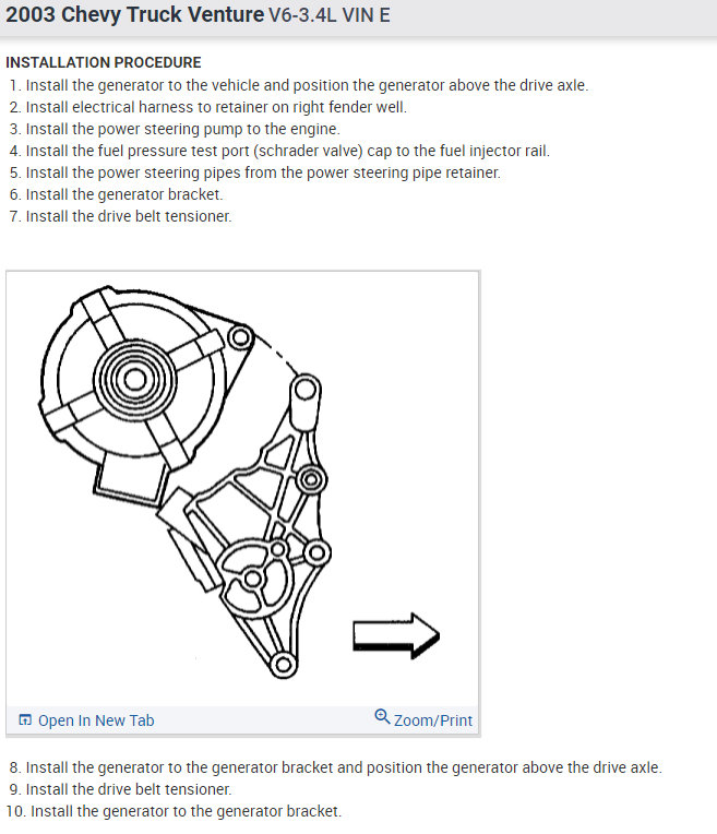

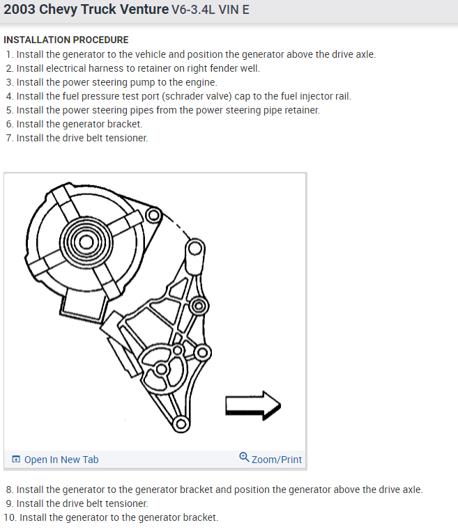

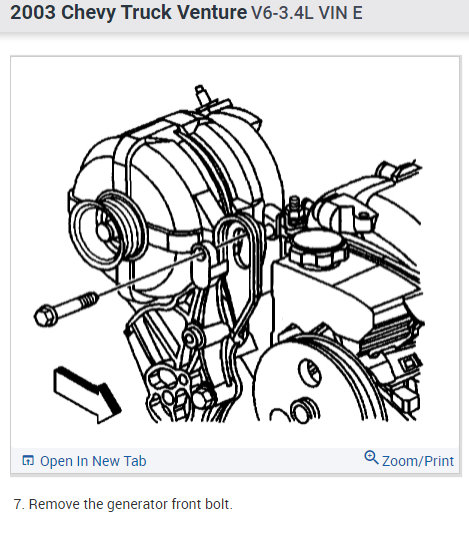

Alternator replacement instructions needed.
Jul 28, 2021 at 5:17 PM
SQM
  • 6,383 POSTS

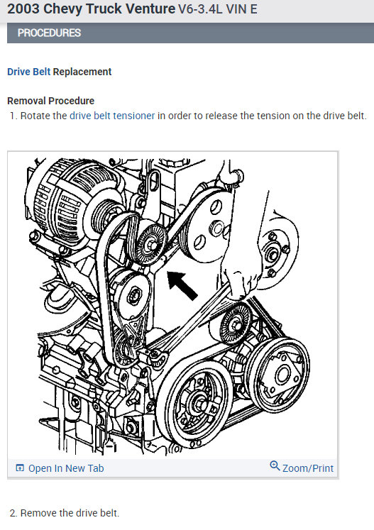

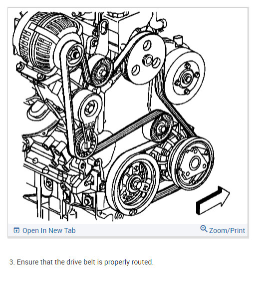

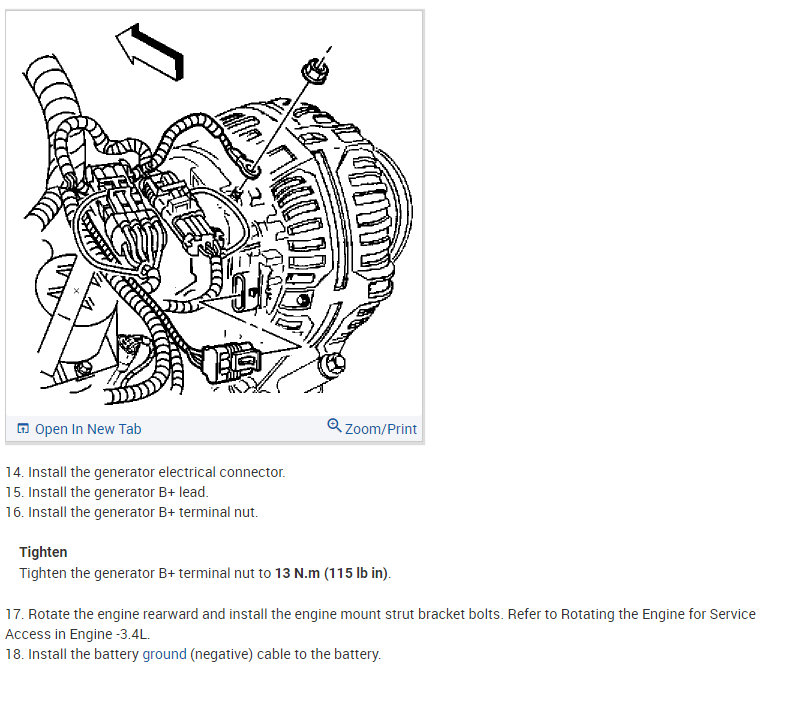

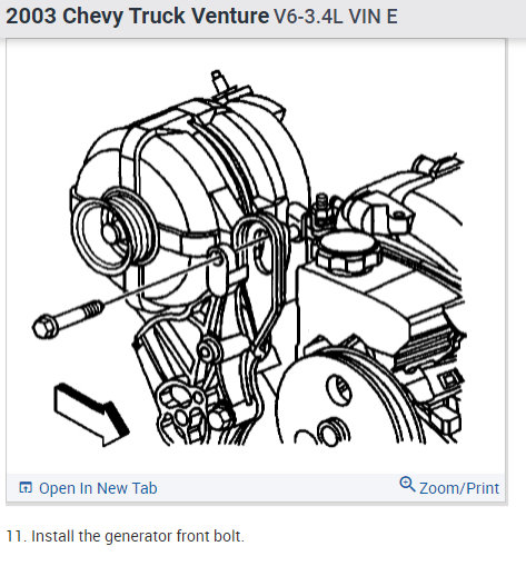

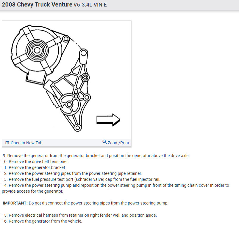

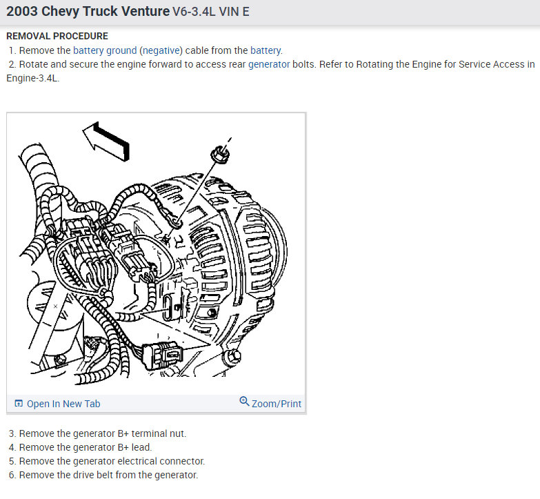

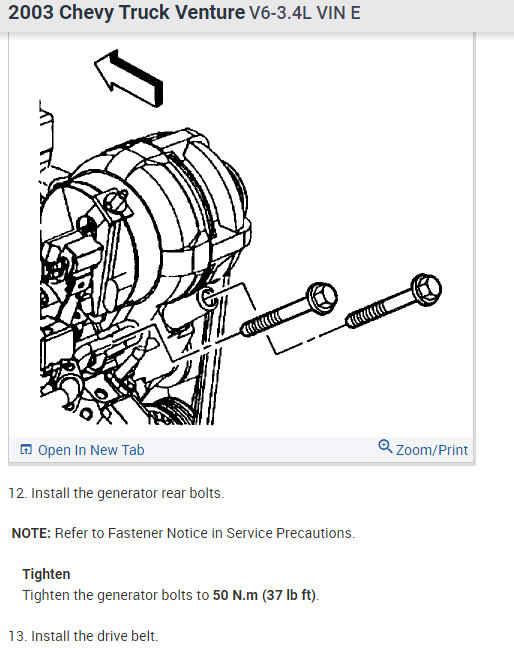

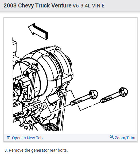

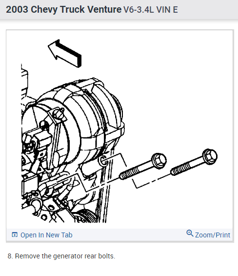

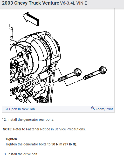

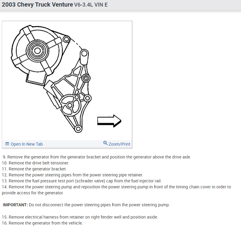

Replacing the alternator can be done using simple hand tools in about an hour for your vehicle.

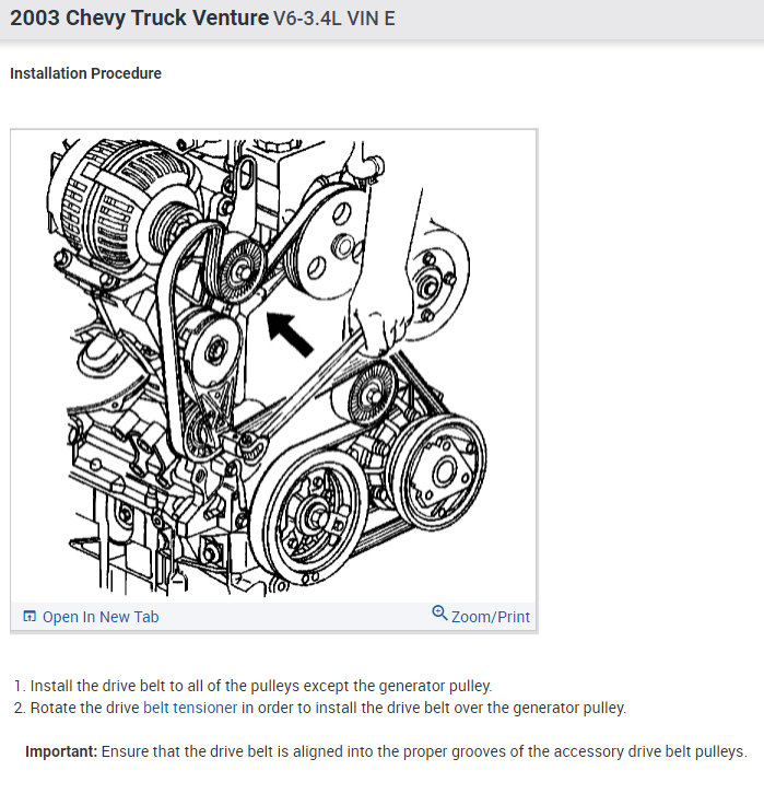

First of all you will have to remove the drive belt, before you can remove the alternator.
Always remember to disconnect the negative battery terminal before getting started.
You might find this article helpful:
https://www.2carpros.com/articles/how-to-replace-an-alternator

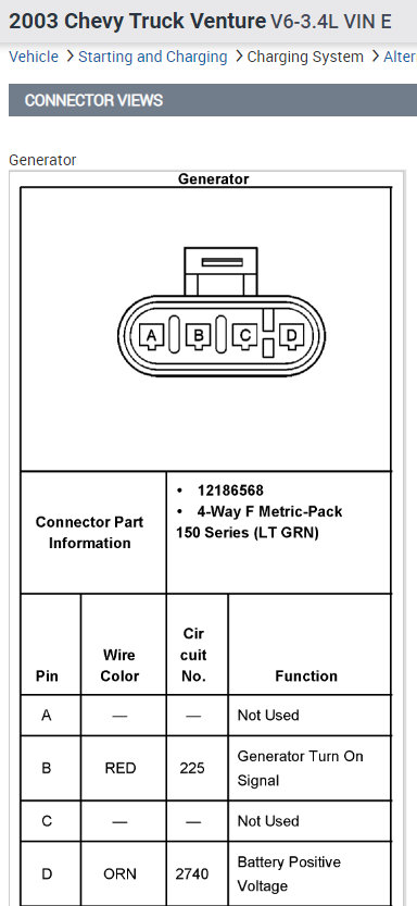

I have also attached complete replacement procedure of the alternator and belt for the drive belt.
