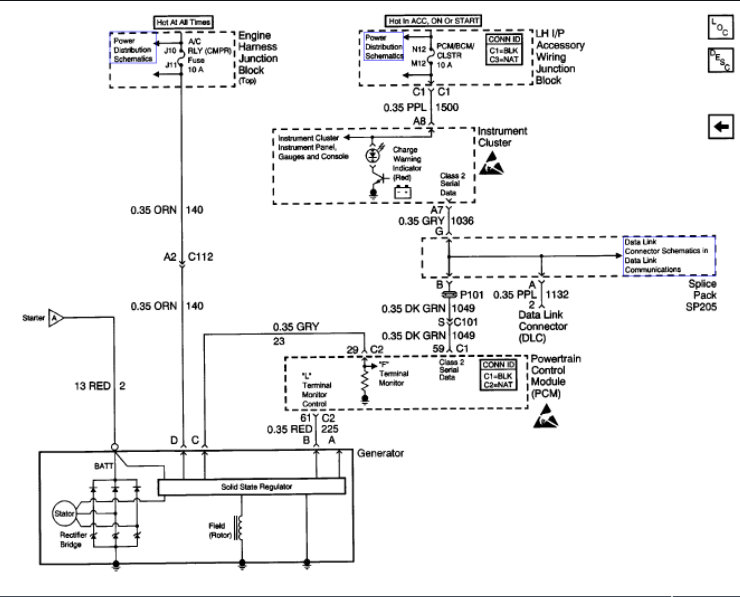

Replaced alternator when first started fine, then a few minutes battery light comes on and battery will drain out. Also replaced battery, no change. Also only code is fan control.
Jul 21, 2021 at 1:44 AM
SQM
  • 6,383 POSTS
Almost sounds like a wiring issue.
Have you got a chance to make sure the main charging wire from the alternator to the battery is in good condition and attached securely? If not take a look at that wire as well as the battery terminals.
https://www.2carpros.com/articles/how-a-car-electrical-system-works

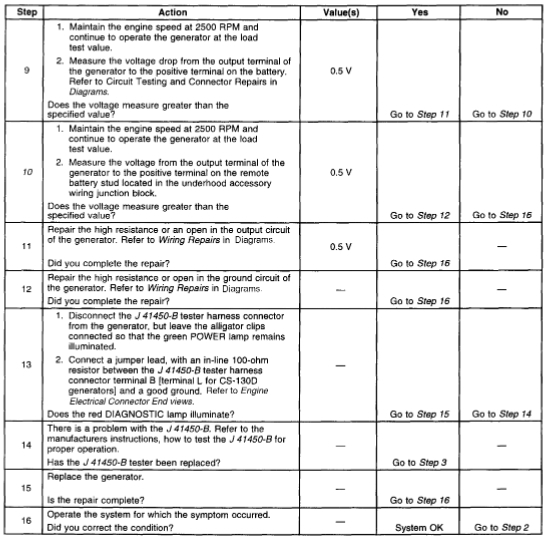

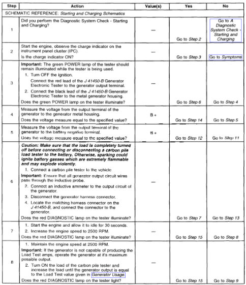

I have attached the charging system wiring diagram for your reference. Also included diagnostics steps.
Please let me know if you are able to get this resolved.
