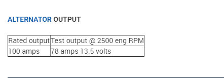

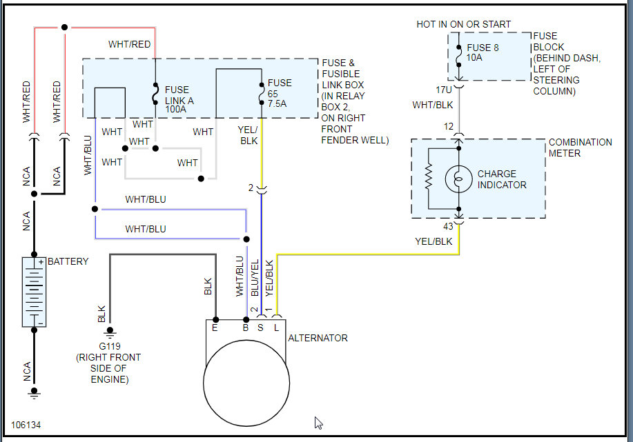

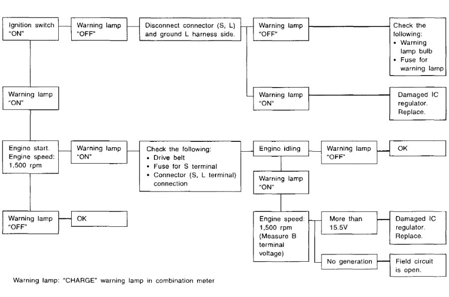

Put a new alternator in an still wont charge battery.
My battery light is not on which is weird, it works but not on.
Oct 20, 2019 at 8:35 AM
What is the output when the engine is running at 2500 RPM? I attached the spec to see if we are even close.
Also, I attached the flow chart for charging issues with the wiring diagram because we will need to get into measuring voltage if it is under the spec.
