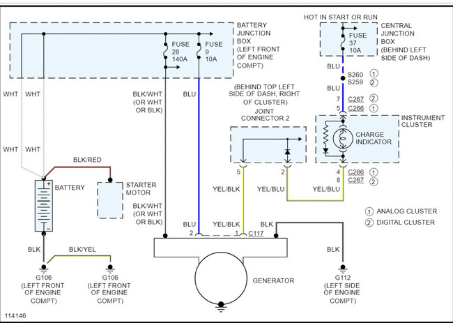

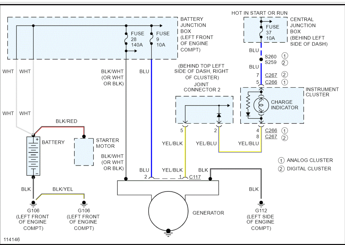

Trying to remove alternator fuse and need help.
Jul 15, 2020 at 7:40 AM
  • 110,236 POSTS
I attached a copy of the wiring schematic for the charging system. Which fuse are you having trouble? They both should pull straight out of the box. If possible, take a pic of what you are dealing with and upload it for me to see.
