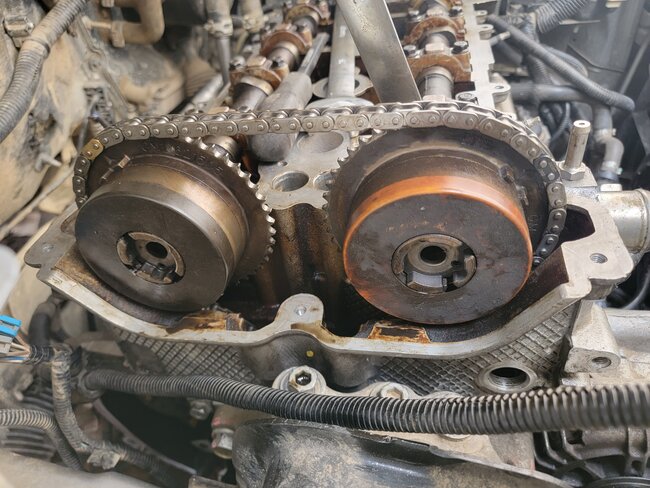

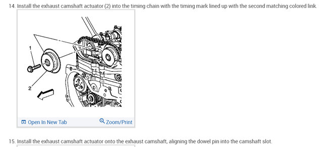

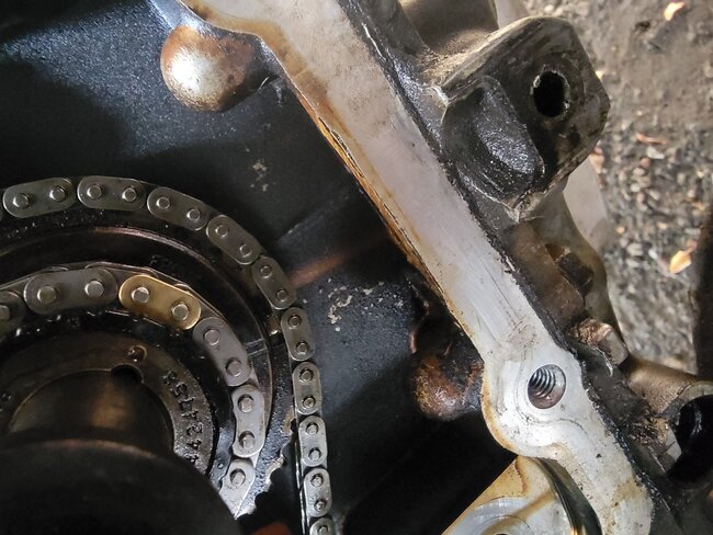

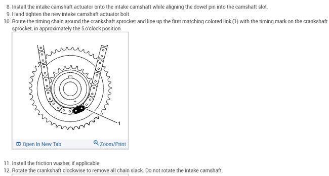

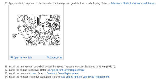

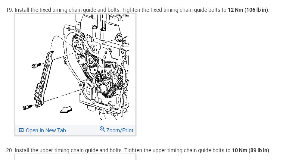

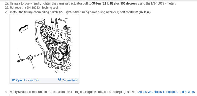

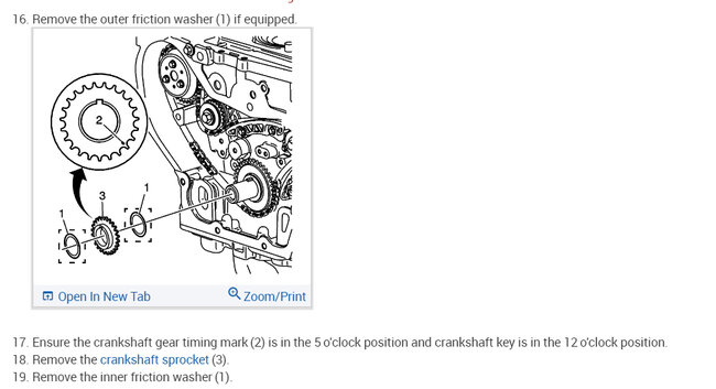

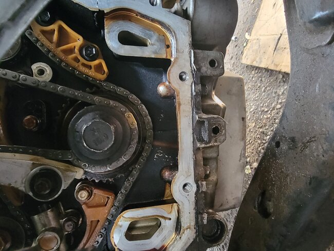

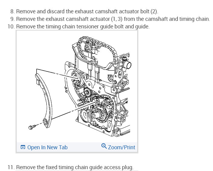

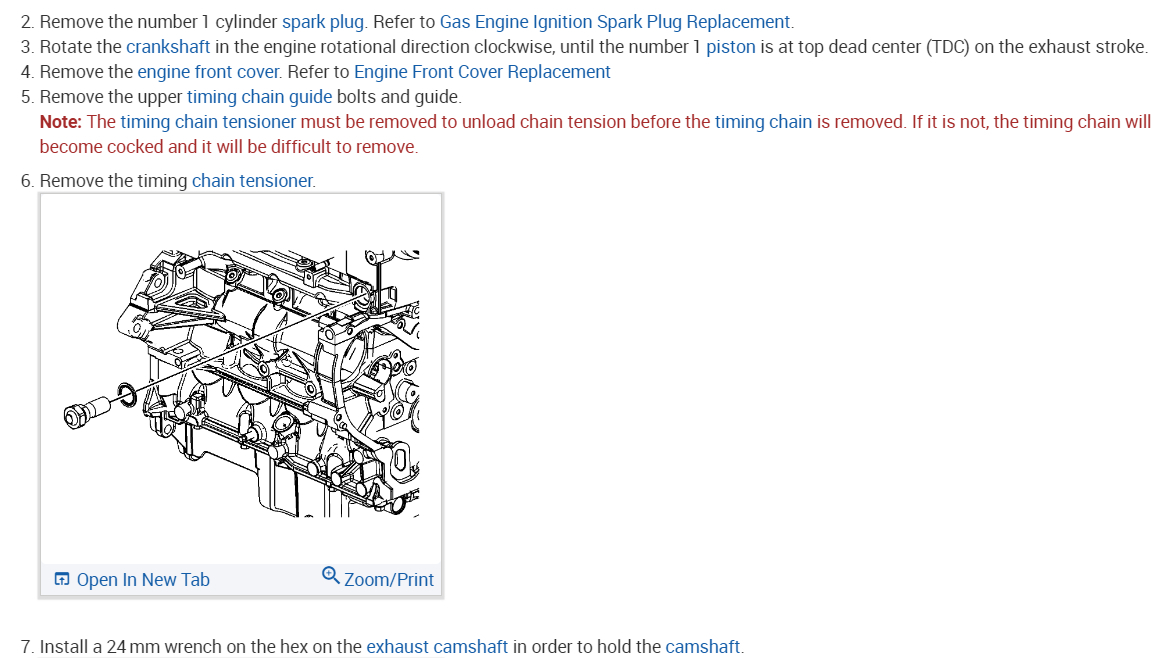

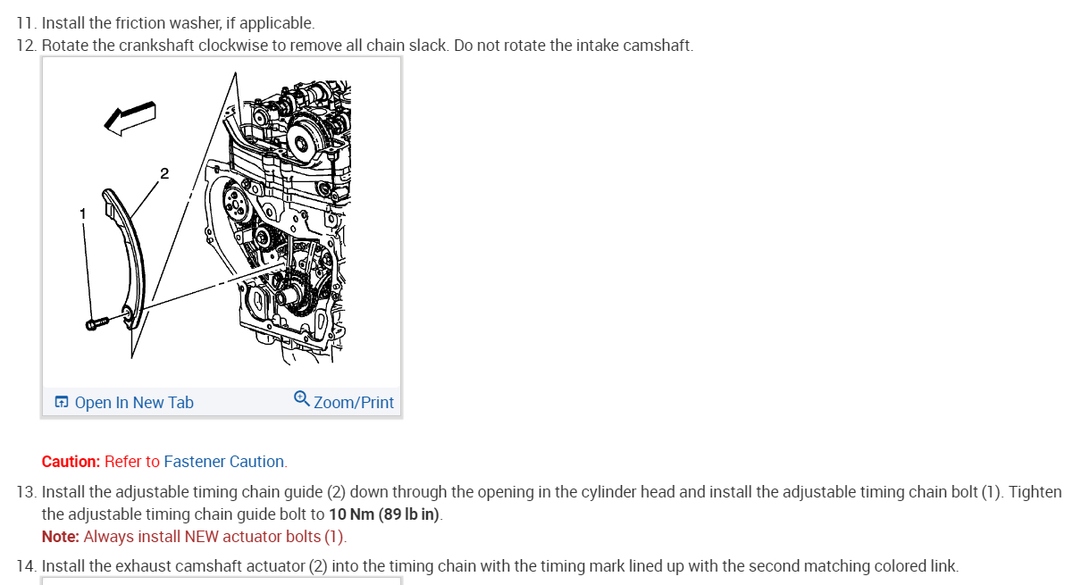

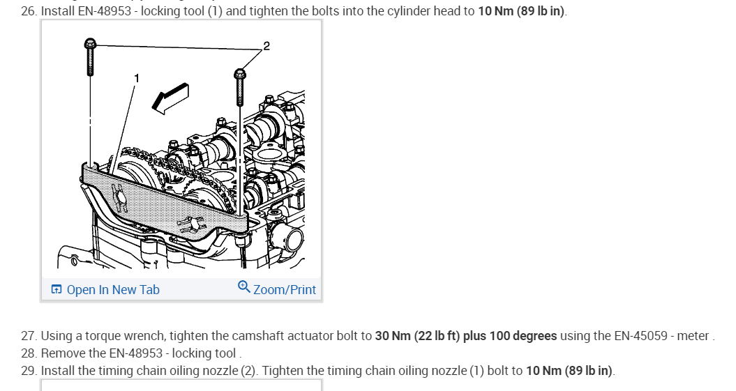

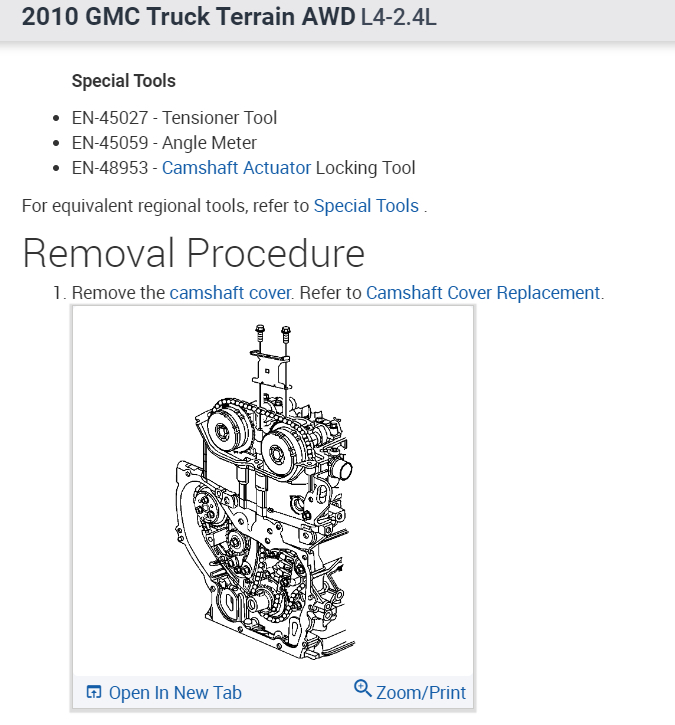

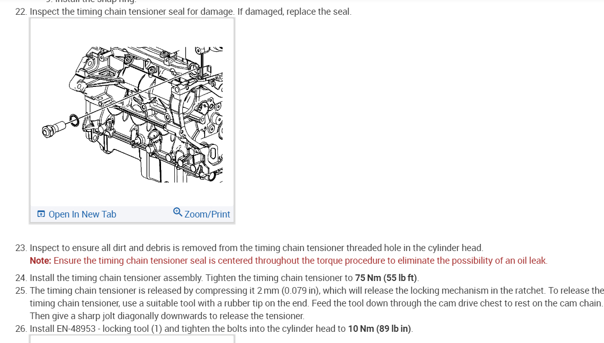

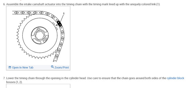

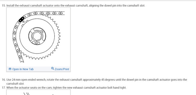

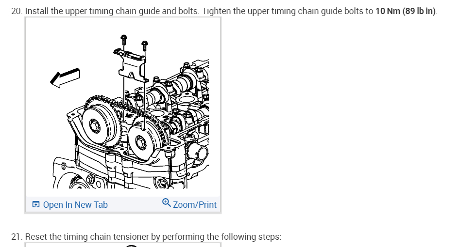

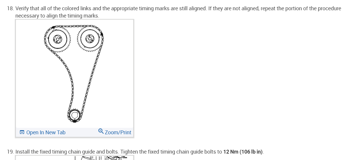

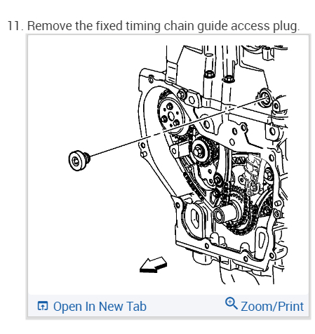

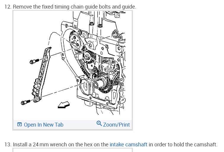

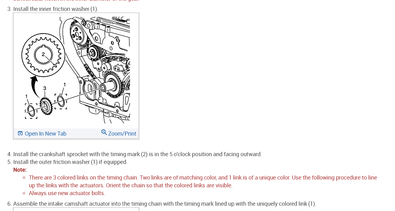

I got a couple of codes after changing timing chains, new chain and guides. I also pulled the engine to do refresh i will show you my work let me know what you think. These codes are listed as pulled in this order:
P0011
p0016
p0017
p0113
p0742
P0742 I'm thinking maybe didn't seat torque converter in correctly?
Sep 9, 2023 at 11:25 AM
  • 55,433 POSTS

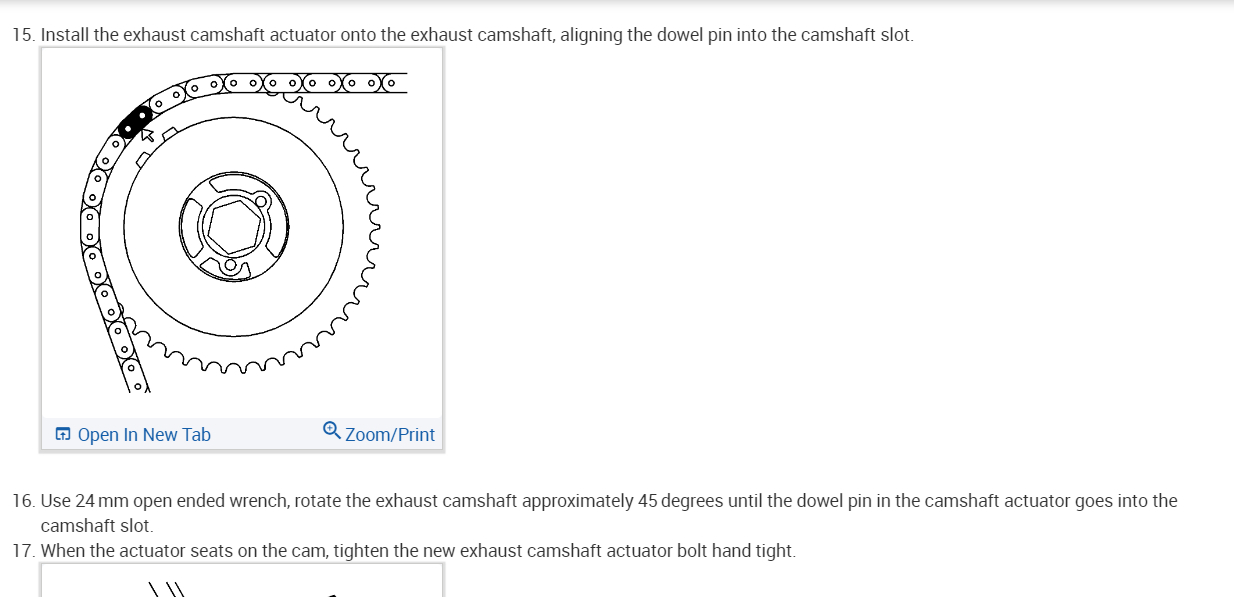

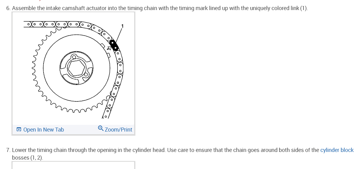

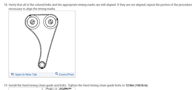

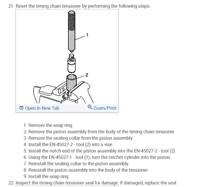

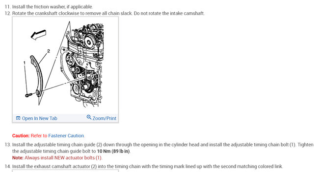

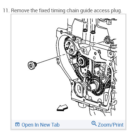

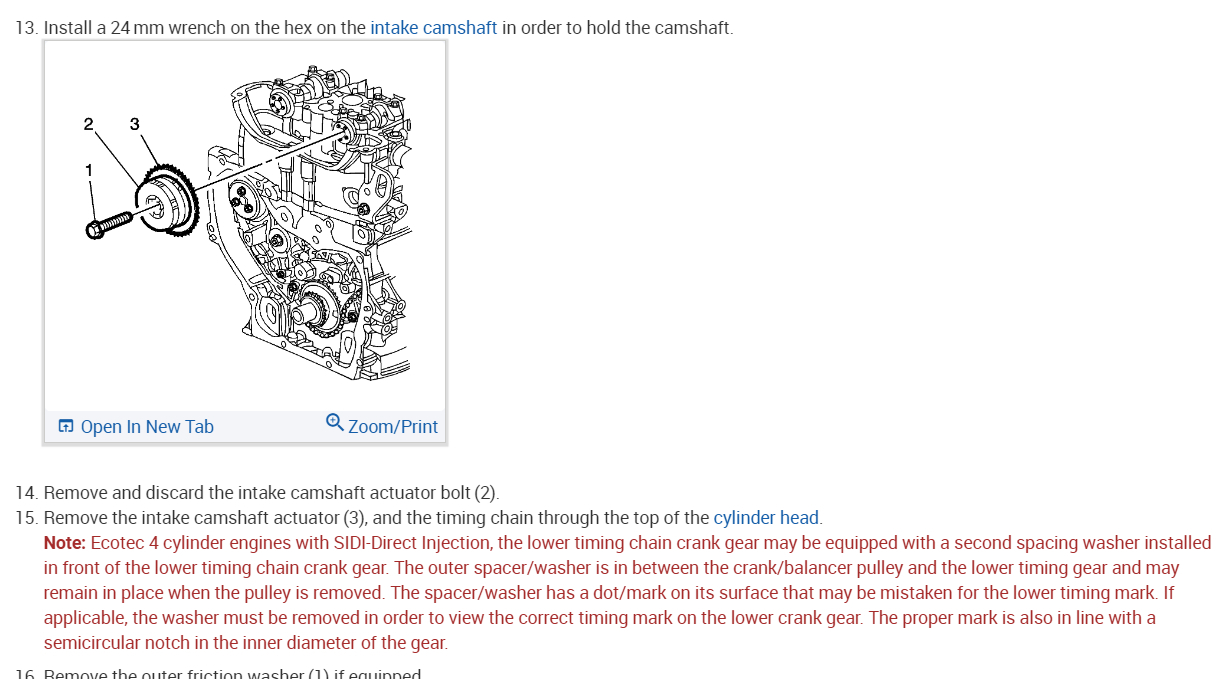

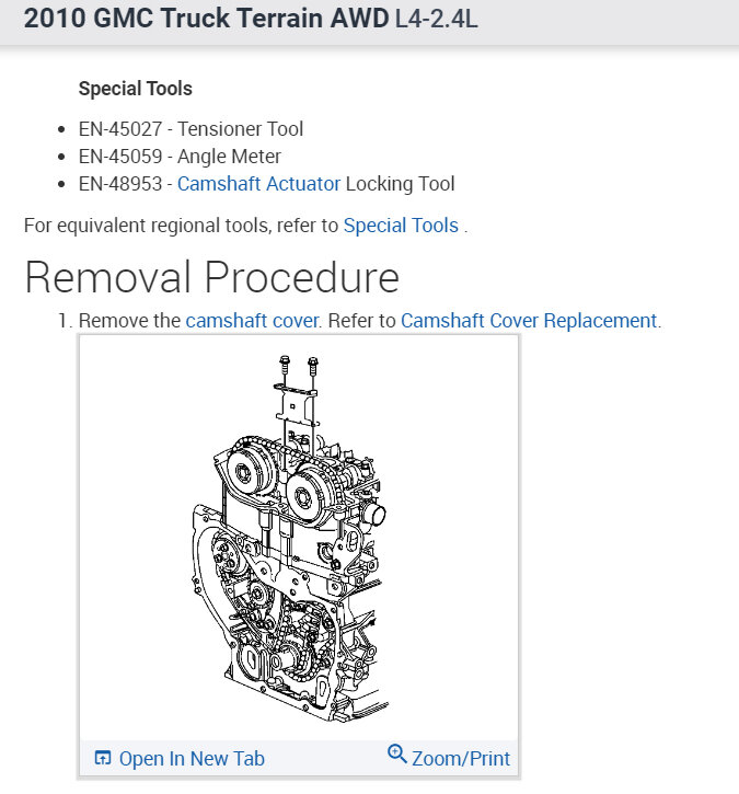

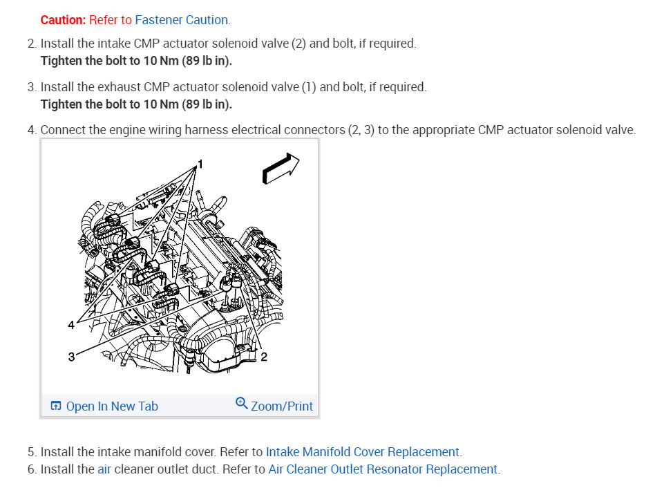

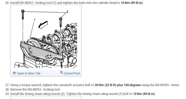

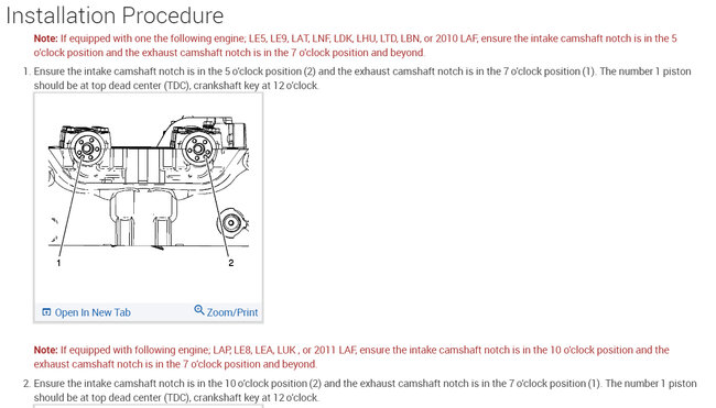

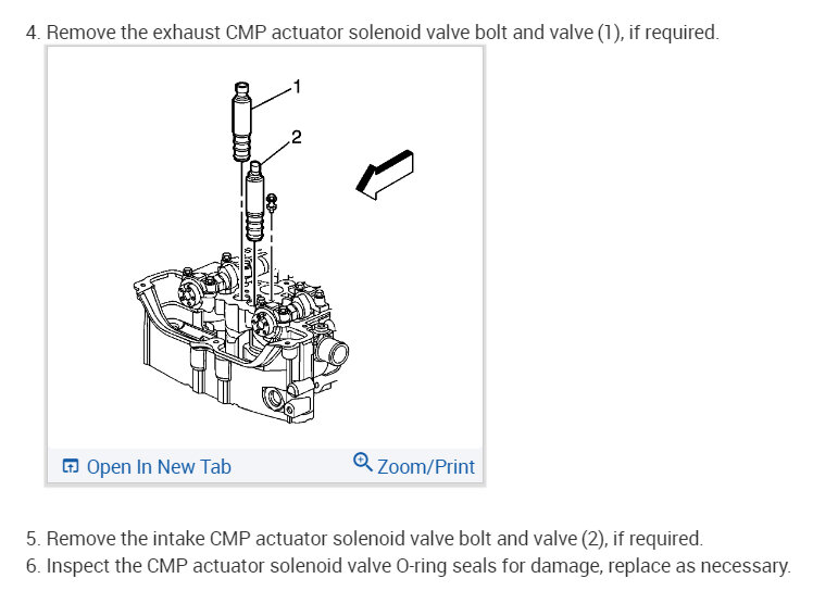

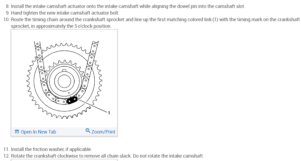

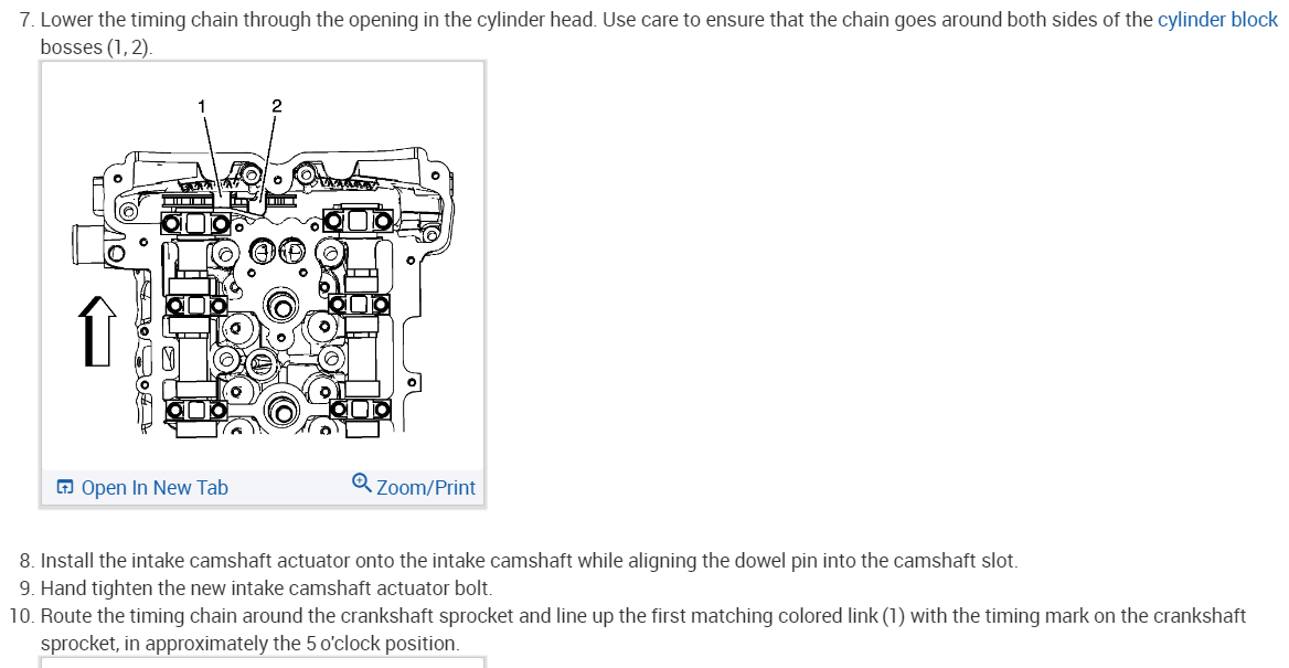

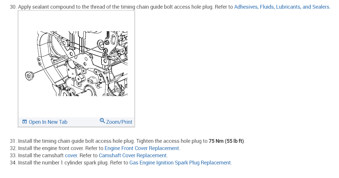

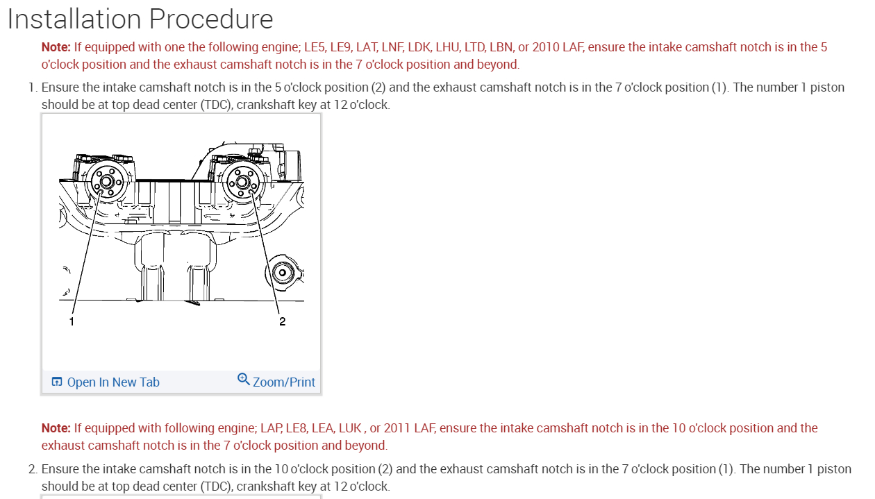

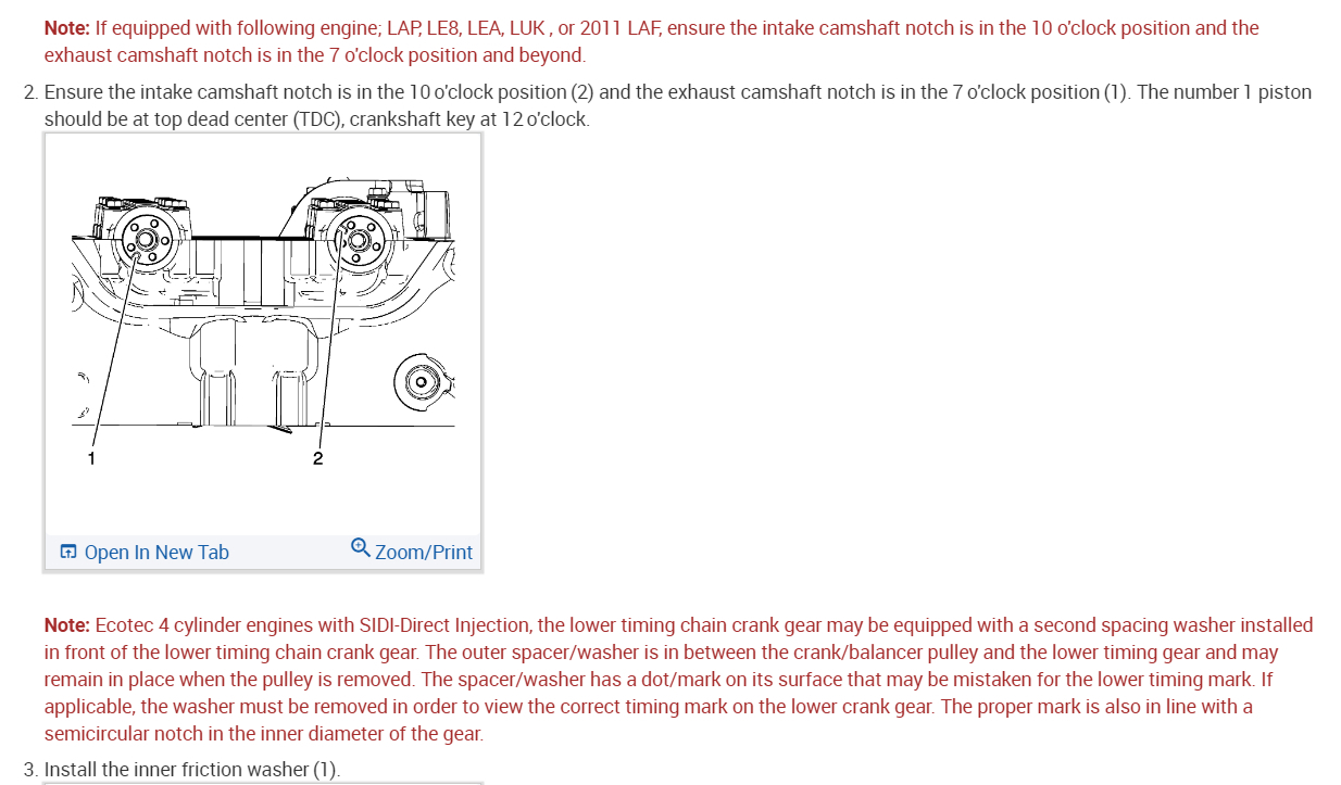

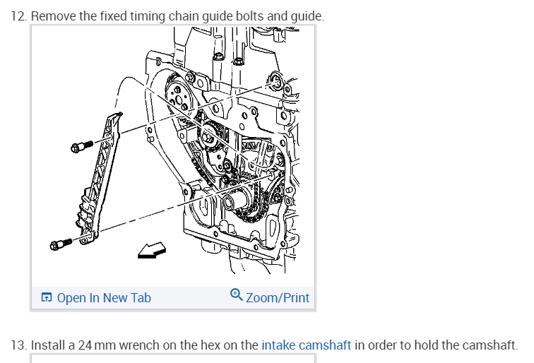

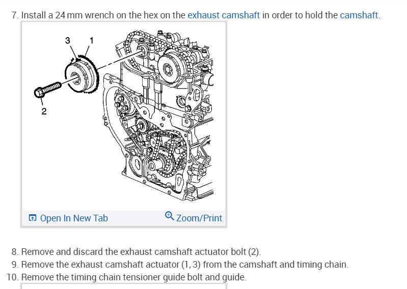

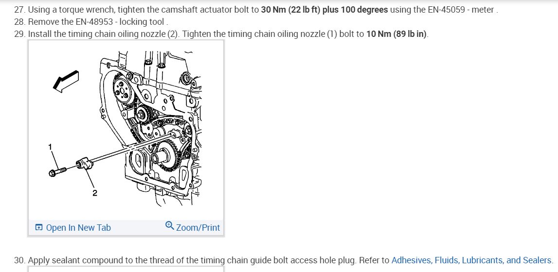

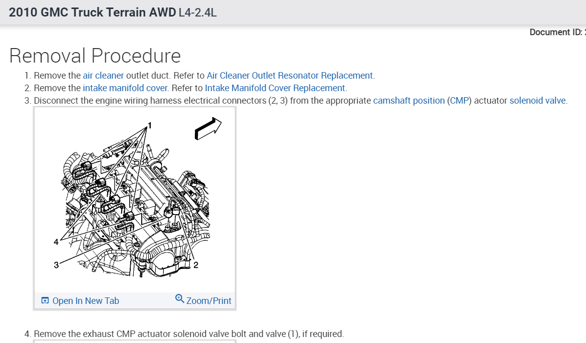

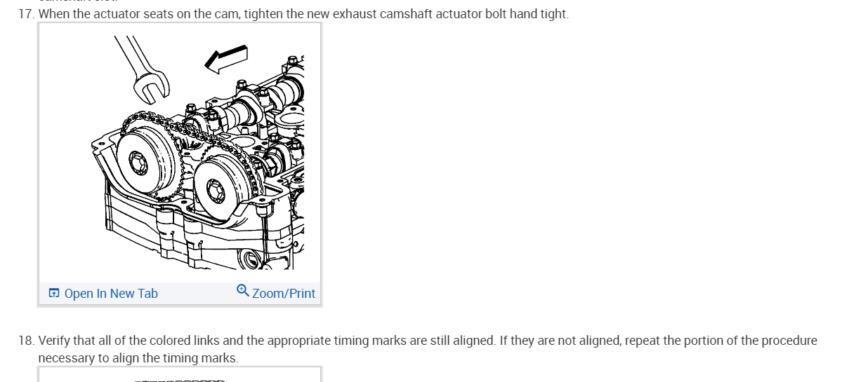

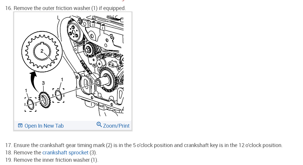

There is a procedure to get the timing of the crankshaft to camshaft correlation correct which I have included below. If you can confirm the timing is correct and you still get codes, please remove the camshaft oil control valve to see if any gunk/metal shavings have plugged the oil screen and the front of the valve.
P0011 - Camshaft Position "A" - Timing Over-Advanced or System Performance (Bank 1):
P0016 - Crankshaft Position - Camshaft Position Correlation (Bank 1 Sensor A):
P0017 - Crankshaft Position - Camshaft Position Correlation (Bank 1 Sensor B):
These two codes please start new questions for each code.
P0113 - Intake Air Temperature Sensor Circuit High Input:
P0742 - Torque Converter Clutch Circuit Stuck On:

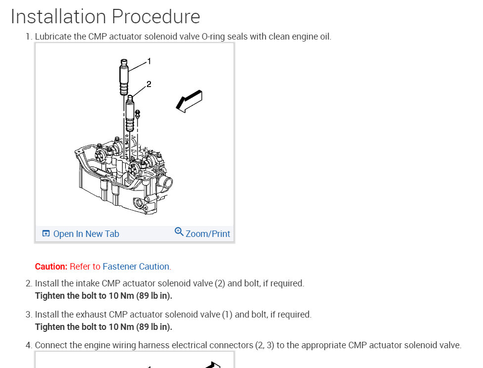

Here are the locations of the oil control valves of the camshafts. Check out the images (below). Please let us know what you find.
Sep 11, 2023 at 5:45 AM
  • 55,433 POSTS
Anything?
May 7, 2024 at 3:07 AM
KINGJD123
  • 104 POSTS
Yep, all good.
May 7, 2024 at 7:13 AM
  • 55,433 POSTS
Glad you could get it fixed, thanks for letting us know. Please use 2CarPros anytime we are here to help.
