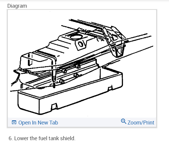

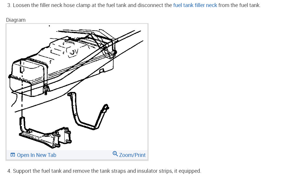

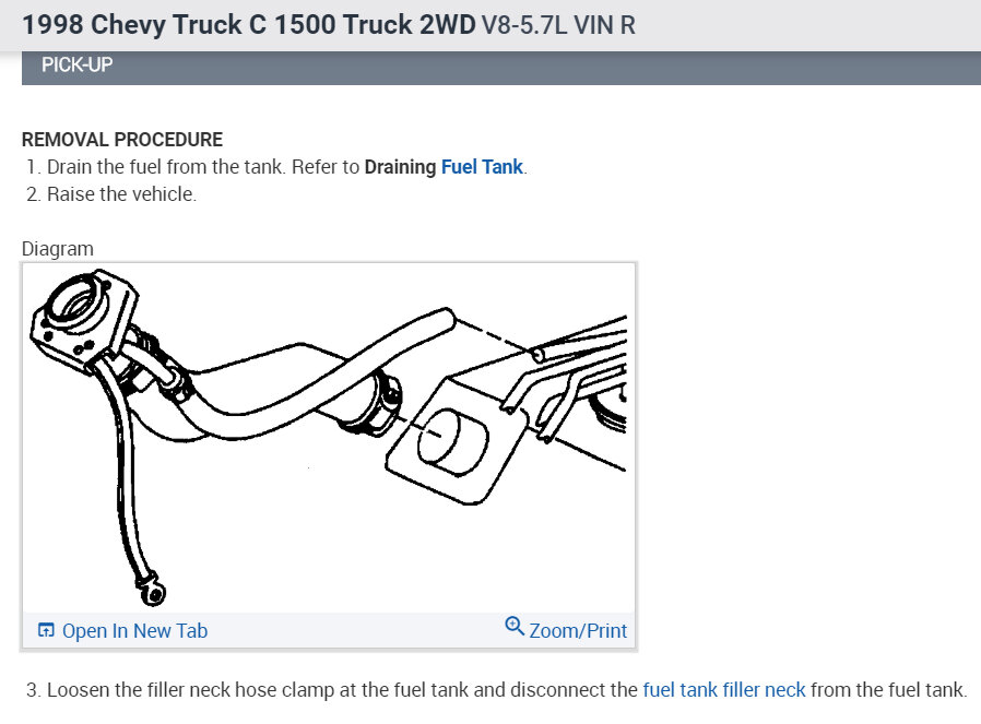

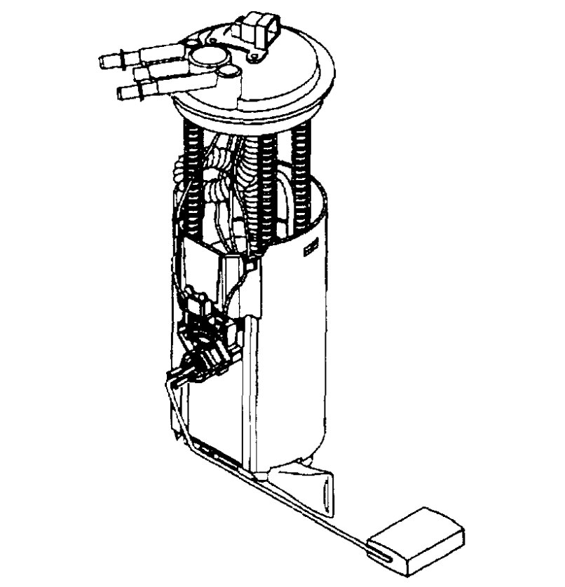

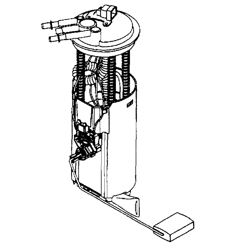

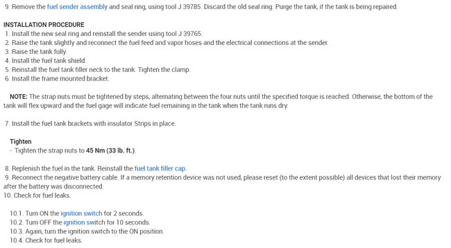

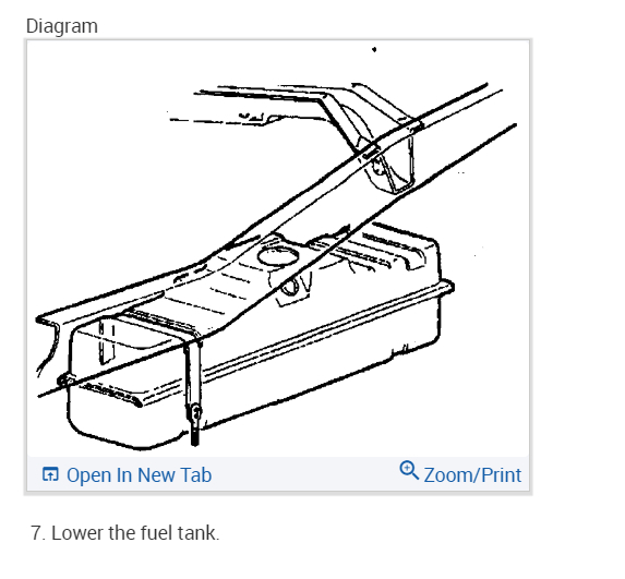

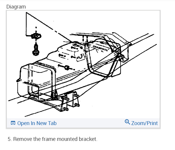

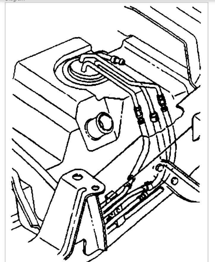

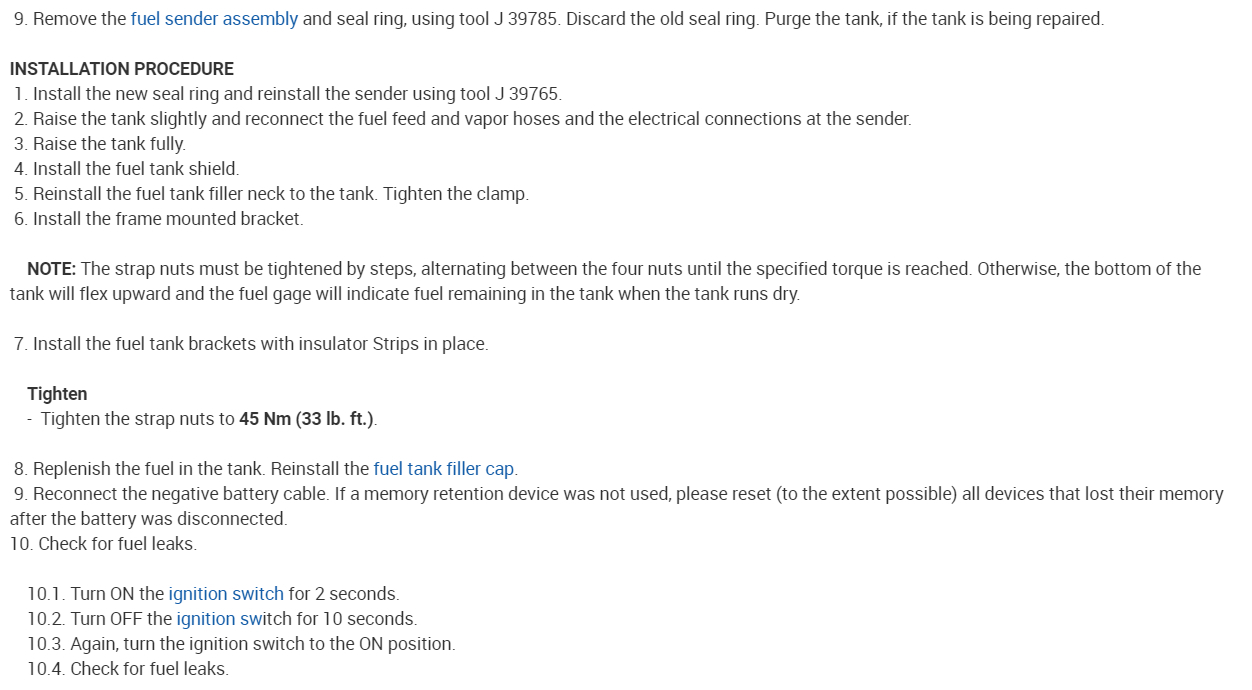

When you did the freeze plug did you remove any ground wires? If so double check to make sure they are connected. Next, can you hear the fuel pump run in the tank for about 5 seconds if you turn the key on and not crank the engine over? If not, it sounds like the fuel pump when out but to confirm see if the engine will run on starting fluid. Here is a guide to help us and I have included the fuel pump replacement instruction in the images below:
