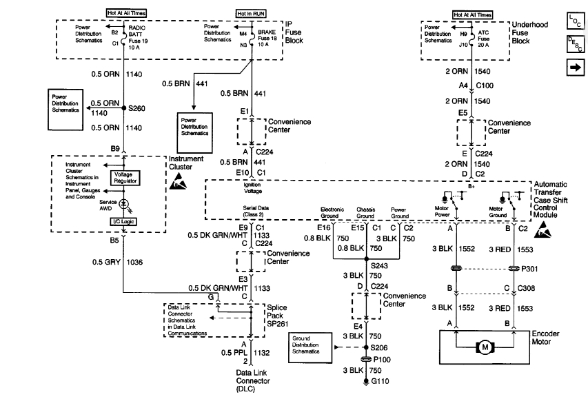

Will not engage in all wheel drive.

I attached a wire diagram for you to view. check the three fuses that power the system to be sure they have voltage on both sides of the fuse. Check out the diagrams (Below). Let us know what happens and please upload pictures or videos of the problem.
