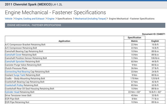

Hi
I need all torque settings please.
Jan 29, 2020 at 3:29 AM
SCGRANTURISMO
  • 4,897 POSTS

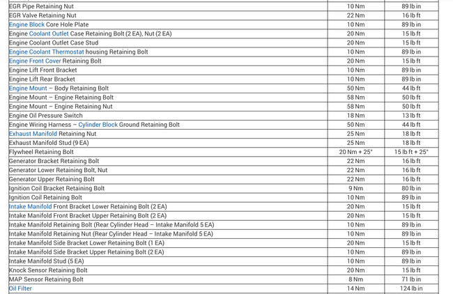

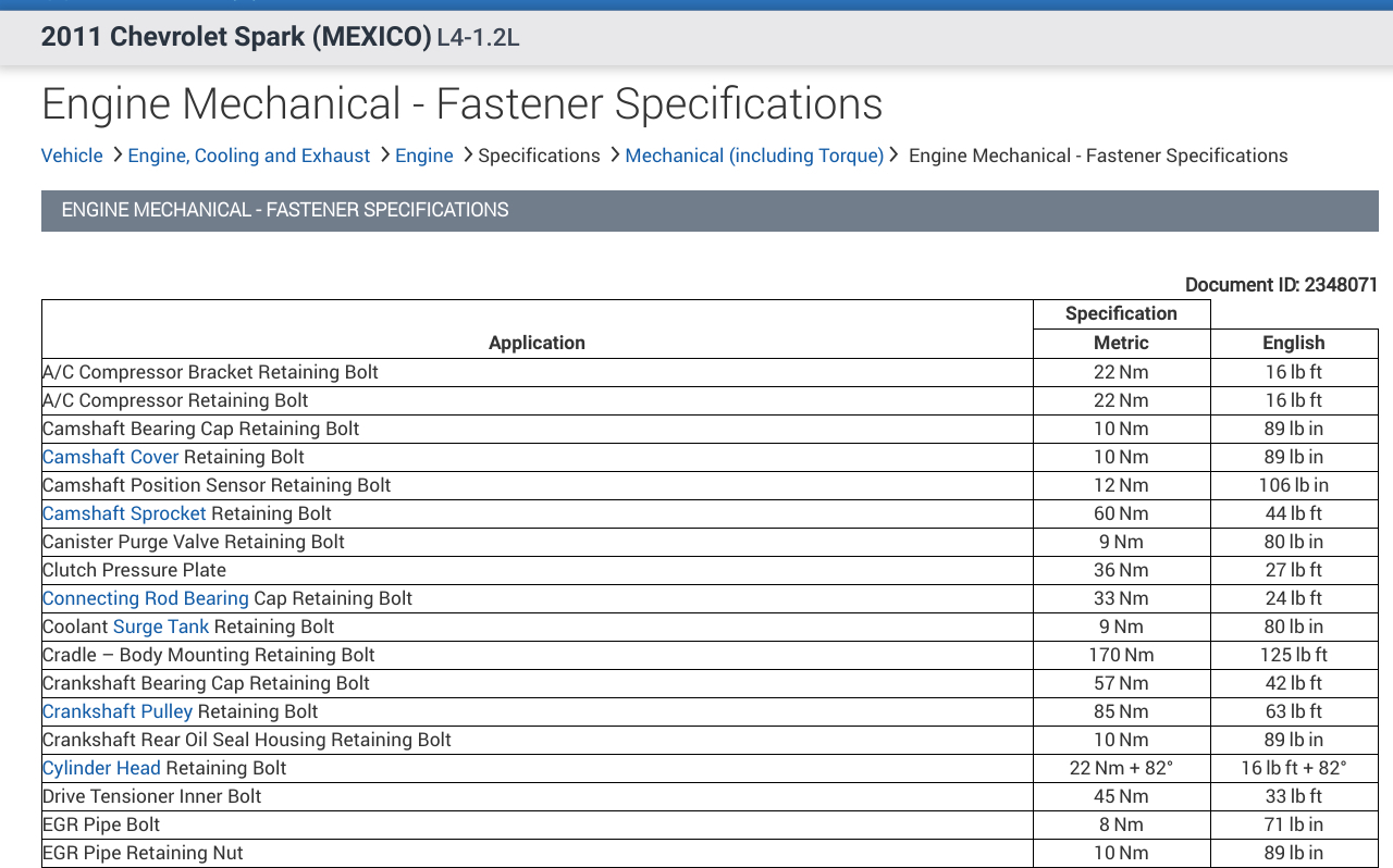

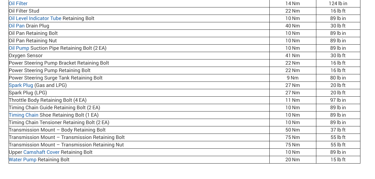

I don't have a listing for a 2010 Chevrolet Spark, but I have a listing for a 2011. In the diagrams down below I have included all of the torque specs for your vehicle engine assembly. I hope that this helps and please let us know if you need any others.
Thanks,
Alex
