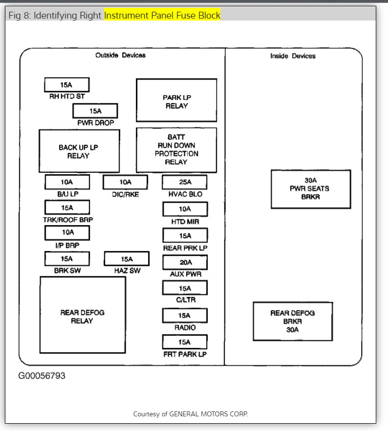

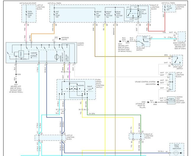

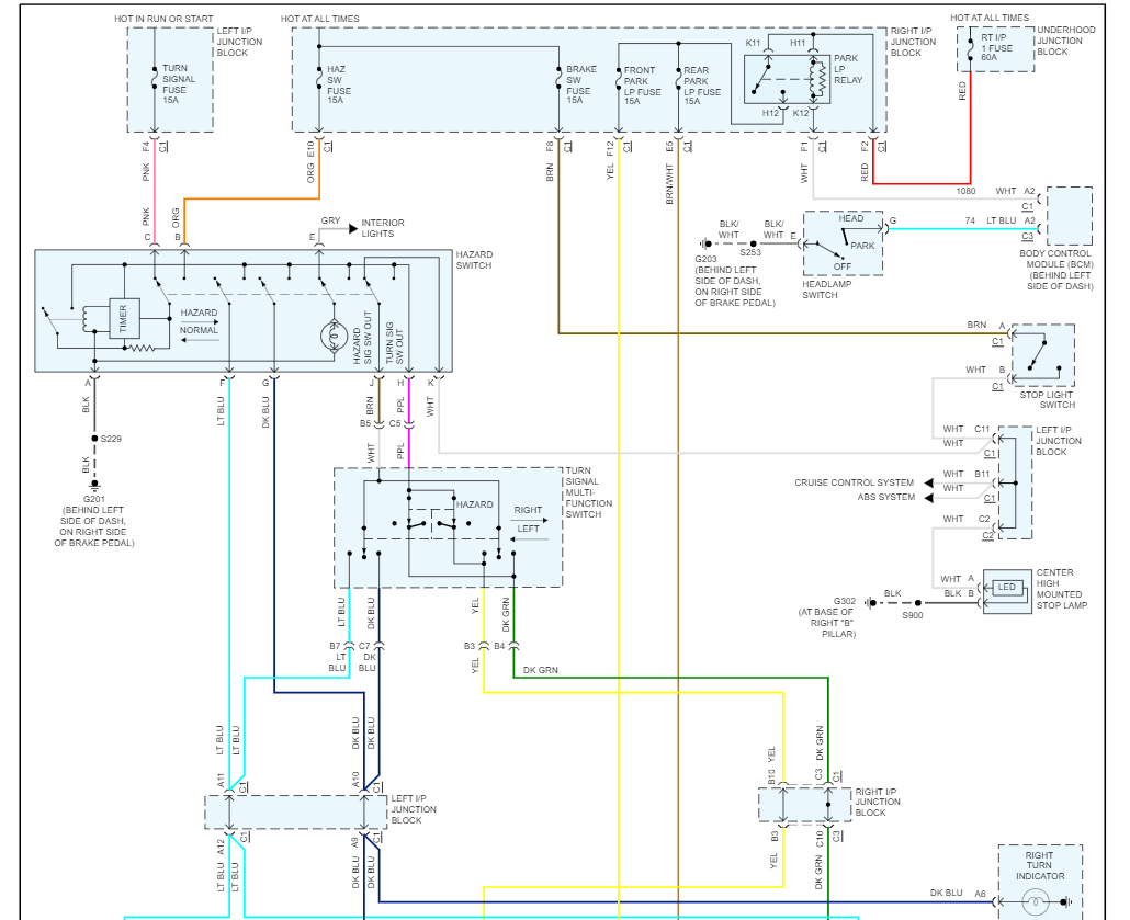

Turn on the headlight switch either by Auto or by manual, both headlights are okay but all of running lights are not working.

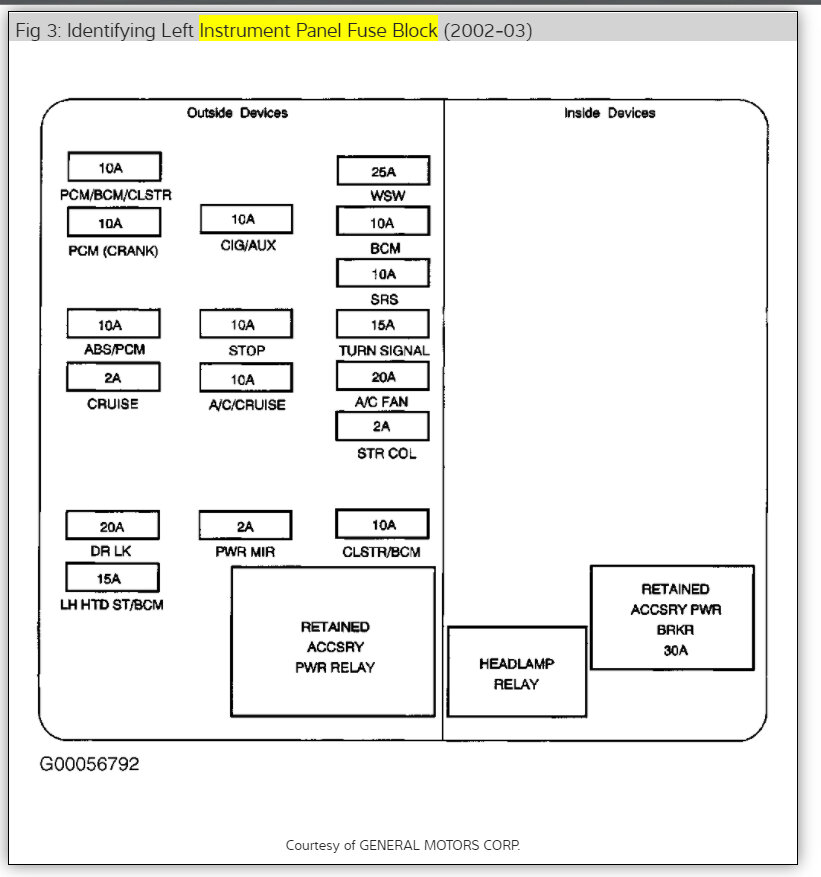

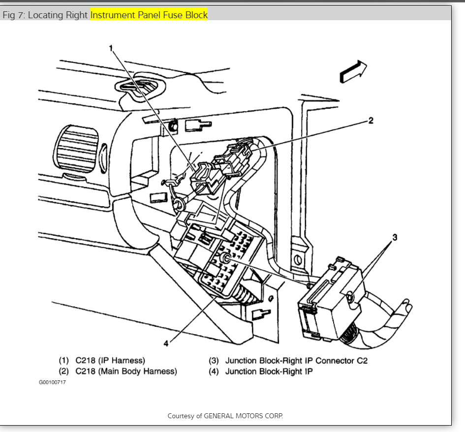

The first thing we need to do is check the fuses, this guide should help, and I have included this how to guide so you can see what to do.

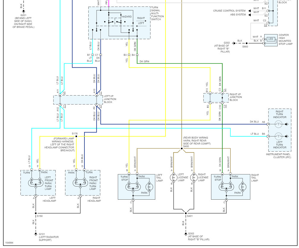

Here are the running light wiring diagrams so you can see which fuses to check and how the system works. Also, if the fuses are all good there is a running light relay, I would swap out which should fix the problem.

Thank you very much for your wonderful instructions. According to the running light wiring diagrams which you send to me, I have use the test light and a multimeter to checks all fusses/grounding/continuity, have found the parking lp relay malfunction , I swapped this relay with back up lp relay (identical), it was confirmed which the park lp relay defected. The new relay was installed an hour ago. All running lights are working perfectly. Thank you, a lot, with the best regards.
