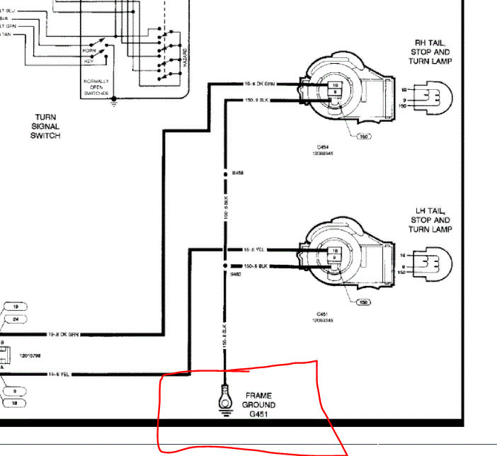

Headlights work. I have no lights in rear at all.

If nothing in the rear works, signals, brake lights, parking lights, the one thing I see they all have in common is they use the same grounding point. What I need you to do is check the black wire on either side for continuity to ground. I attached one pic below. Each system has a different schematic (signals, brakes, tail lights) but they all show the same ground.
If you find there is no continuity to ground, as a test, run a new ground and attach it to the black wire to see if the lights start working.
