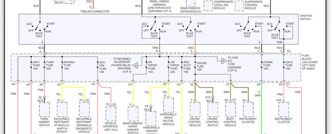

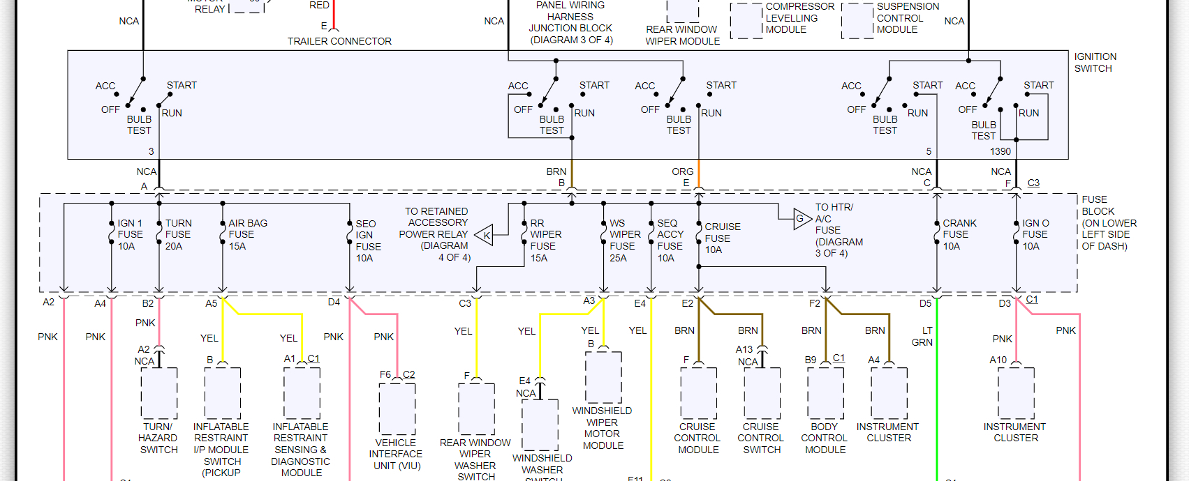

The gauge cluster still lights up and the speedometer works. everything else is not working. Can't run the heat because you can't turn it on. Checked all the fuses and they look good. I will say that they wired in a push start button but you still have to put the key in and turn it over. Not sure if that would have caused a failure.
Jan 29, 2021 at 4:35 AM
  • 55,224 POSTS

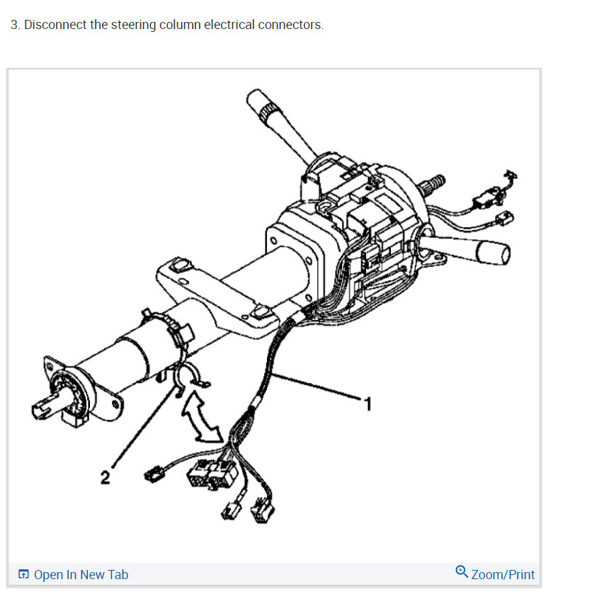

It sounds like the ignition switch needs to be replaced. here is a wiring diagrams so you can see how it works plus we can confirm the issue by checking for power at the under dash IGN 0 #5 fuse. this guide will help:

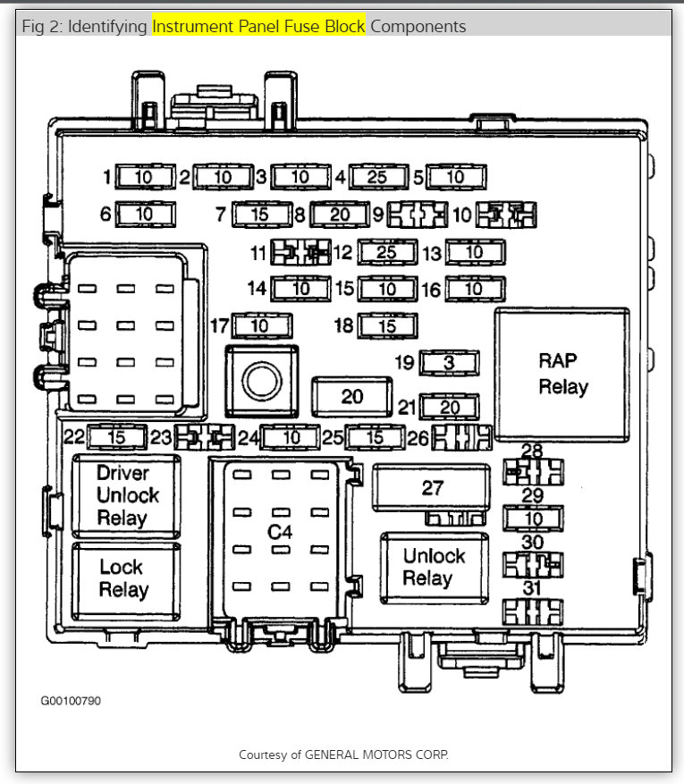

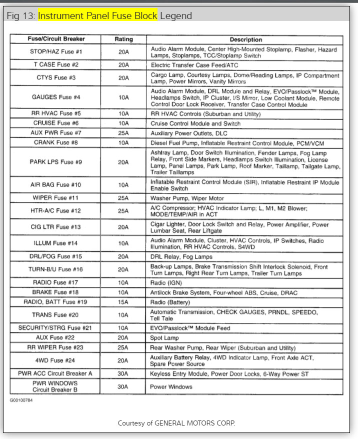

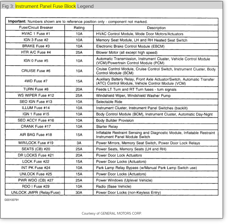

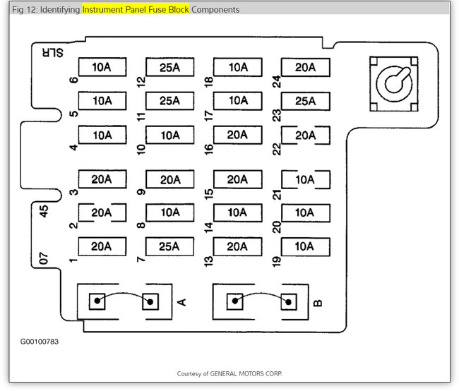

Didn't show me where the fuse for dashboard lights are at in the fuse box?
Sep 1, 2023 at 6:12 AM
  • 55,224 POSTS
Here is the dashboard light fuse #14. Check out the images (below). Please let us know what happens.
