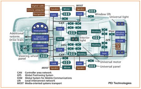

  • 75,992 POSTS
We should be learning and familiarizing the ( CAN ) diagnostics this is what's happening in lieu of liquid engineering technology,this is my 2cts. Any fully qualified expert on it I'm willing to learn more on it the heck with the slippery stuffs.
https://images.2carpros.com/forum/automotive_pictures/12900_auto_networks_1.jpg
Good day Gentlemen rasmatics at work

Throw in Mode 6 too while your at it Raz! It's like reading bloody Greek.
Aug 27, 2009 at 5:28 PM
  • 75,992 POSTS
That's right amigo its one of them and I'm getting bald trying to figure it out myself I think I need to go back to school to refresh my half watt PCM. But by the time it fully locks in place I'll be gone, right now am on borrowed time.
Aug 27, 2009 at 5:32 PM
