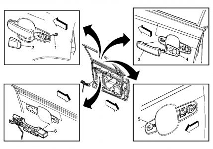

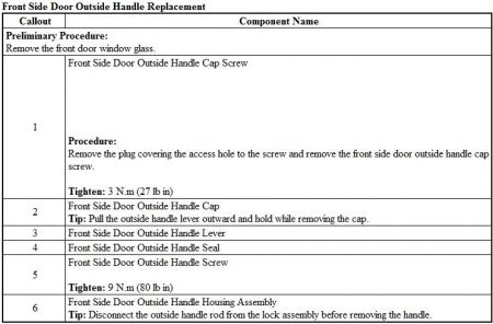

HOW DO YOU REPLACE THE INSIDE DOOR HANDLE,
ON THE DRIVER SIDE?
DO I TAKE IN....?
ITS A 2007 CHEV.HHR

https://images.2carpros.com/forum/automotive_pictures/261618_Noname_2072.jpg
https://images.2carpros.com/forum/automotive_pictures/261618_Graphic_470.jpg
