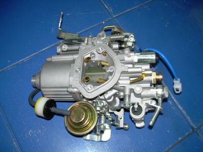

Hi , my carb has these problems , it can't be tuned a mechanic told me the CO reading is adnormal and can't be adjusted . It seems like there's a problem with air intake , the car "surge" back and forth at lower gear when the air conditioner fan is on (i guess) , The rpm pointer goes up and down , fuel consumption is high .
So I would like to know what could be the real culprit .
Thanks for answering my question .

Hi gmttmg,
Do they still produce carburetted models for the year specified?
What is your car make and model?

Mine is a proton saga lmst 2005 1.3

Hi gmttmg,
You should rebuild the carburettor. There is a worn/leaking O ring inside the carb for the idling circuit and it is preventing the CO to be adjusted correctly.

I can't find any workshop that provide rebuild service . Do you know any workshop tat provide such service in JB or somewhere else ? My type of carb seems different from the one tat most of the workshops shown me . below is the photo of the one that my car is using .

Hi gmttmg,
Proton has been using this carb for the past 17 or 18 years but the funny thing is not many mechanics knows how to service it.
Easiest thing is to ask at some parts outllets for recommendations on who can do the job. Try big outlets.
