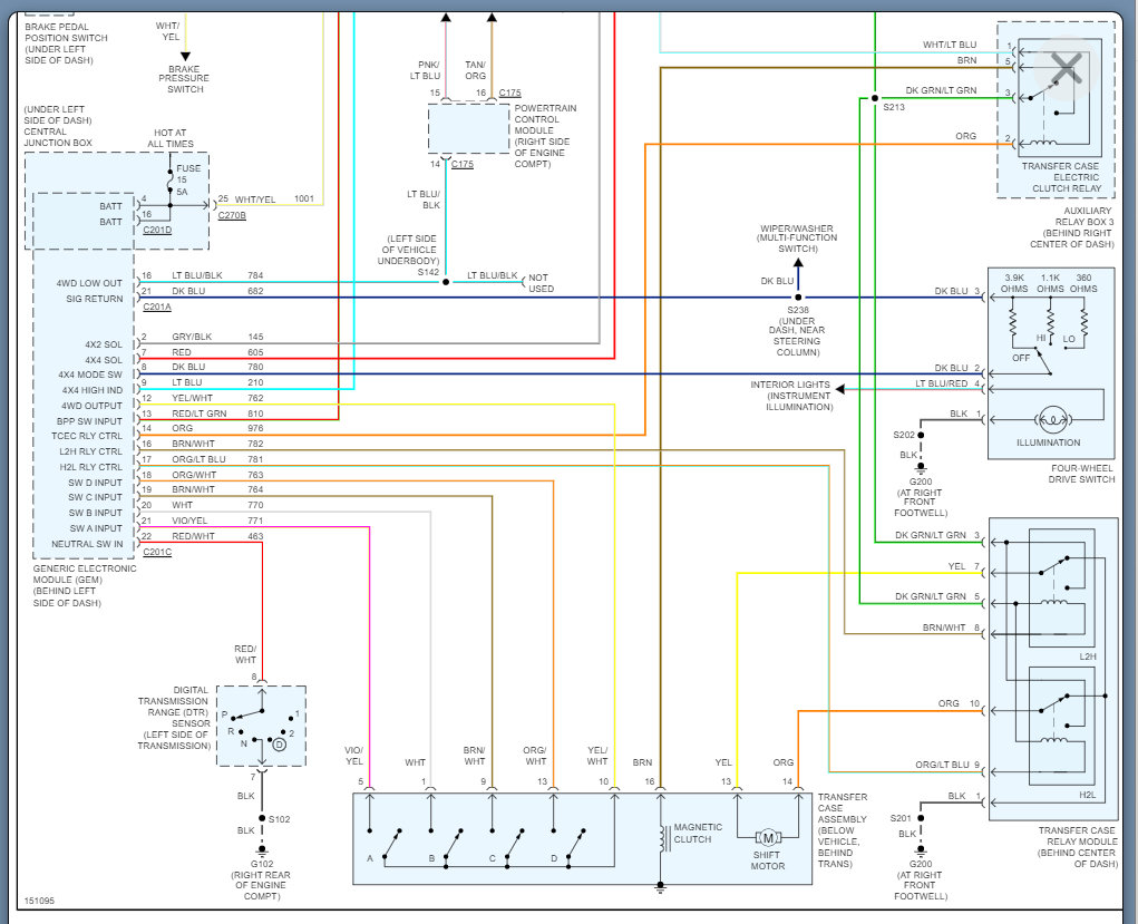

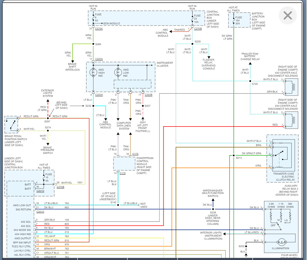

Also, I am attaching the wiring diagram that will help with the testing that we are most likely going to have to do.
You have disconnected solenoids that could be causing issues but if these are the issue, I would expect it will still read 4WD on the indicator but just not engage the front wheels any longer.
We are going to have check power at the GEM to find out if these are remaining engaged.
Please run through this and let me know what questions you have. Thanks

My truck has an electronic switch knob on the dash. 2H, 4H, 4L. The 4WD actuator operates as it should when switching from 2H to 4H. The lever moves the collar in and out fully (it stops at the small E-clip, as it should). The operation is smooth. I engaged the 4H l, saw it and heard it lock in and spun the passenger side wheel and saw the driver side wheel spin in the opposite direction. So far so good.
I haven't road tested the truck after lubing it up and putting it back together (out of town) but what used to happen is that a soon as the wheels are turned the truck "chug" and struggle to move at all. Swap back to 2H and it was fine. It feels like the 4WD works as long as there is zero resistance, as in turning or any obstacles on the road.
The vacuum seems fine, as in there being vacuum in the right places, but I'm not sure if there's enough vacuum. Is more vacuum needed if there is resistance at the wheels? It doesn't sound right to me; I'd imagine if there is enough vacuum to operate the actuator that would be sufficient to keep it in 4WD.
I checked the two solenoids and they both seem fine. Ohms good, voltage seemed good. The vacuum reservoir didn't appear to have any cracks, but I didn't test it for leaks.
