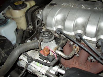

I took your advice and decided to take apart the egr valve and clean it. Went to the parts store to buy replacement gaskets first and they can not match my EGR valve. I looked everywhere I could find on the WEB and the picture of the egr valve for my 2002 saturn 1.9 L, SOHC, does not match the connector or anything else. Mine has a part number 21210000 on the top of the diaphragm, is more square, doesn't have any electrical connection on the top, and the connection to the exhaust tubing is in the horizontal. No idea how to figure this out.

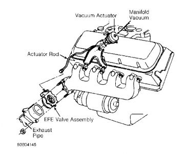

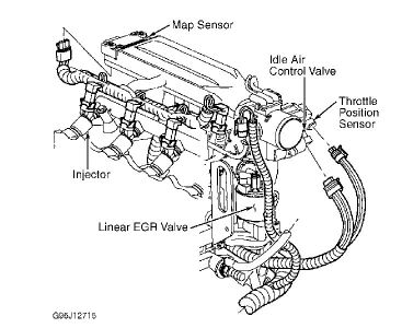

Before anyone blows a hole through me, I am a meager service writer. :) I'm throwin this out here anyway:
https://images.2carpros.com/forum/automotive_pictures/30961_satvac_1.jpg
Are we looking at the right part?
https://images.2carpros.com/forum/automotive_pictures/30961_sategr_1.jpg
https://images.2carpros.com/forum/automotive_pictures/30961_sategr1_1.jpg

Boy do I feel stupid. My EGR valve is just where you said and looks just like it. Thanks so much. I think the "valve" I was looking at is part of the AIR system during engine warm-up. I'll give it another try. What should I look out for when I try to clean the EGR valve?

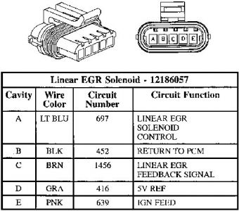

I pulled the egr valve and it was pretty clean. A thin film of fine carbon, but no chunks. The pintle (has a little torx head in it) was moving freely. It has some light spring pressure that I could push in with a small screwdriver. If I shake it it rattles a little. I sprayed it with carb cleaner, but I want to check it out before I put it back on. How do I go about testing it off the engine? Can I apply some voltage to it to make it move in (open)? If so, how much and which contacts? It has 5 electrical contacts in the connector.

By chance did you check for any codes in the computer? Here's the connector view:
https://images.2carpros.com/forum/automotive_pictures/30961_satcon_1.jpg
I can't say that a rattle should be present, short of a piece of carbon in there, but if you cleaned the pintle, That's about the best you can do on those as I understand.

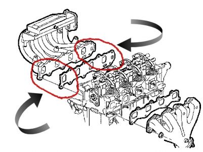

One more shot at a possible vacuum leak. Spray some carb cleaner, brake clean throttle cleaner etc around the intake manifold gasket, especially #1 cylinder area.

After spraying some more carb cleaner it seemed that at least the #1 injector might have a seal leak. I changed all of the manifold seals on the injectors which didn't make any change. Also put the socket on the intake manifold bolts, with no effect except not getting P0301/P0304, but _0507 instead. Put a cover over the egr gasket and idled it so an egr leak would be stopped....no effect. Still idles rough and get P0507 codes.
