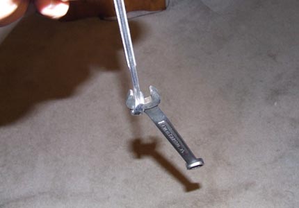

how do i get the fan belt back on the pully after fitting a alternater on my rover 400

To install, first locate your tensioner pulley, this is a spring loaded pulley that applies downward pressure on the back side of the serp belt, on this pulley you will have either a square drive hole that a socket wrench can plug into, or a regular hex bolt, using the correct size wrench, apply opposite force to relieve tension on the old belt and remove the belt. Install the new belt on all pulleys except the top most one, or easiest one to get at, then while holding the belt in the possition ready to go on the last pulley, apply the wrench to the tensioner pulley and slip belt onto the pulley! Done!
