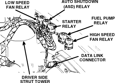

1993 grand caravan- 3.3L......245K miles and is still a great vehicle.
What is the location(s) of the AC clutch relay....and and radiator fan relay?

Found ones for the fan......hope this makes the trip.......
https://images.2carpros.com/forum/automotive_pictures/66436_relaymr5_1.gif
