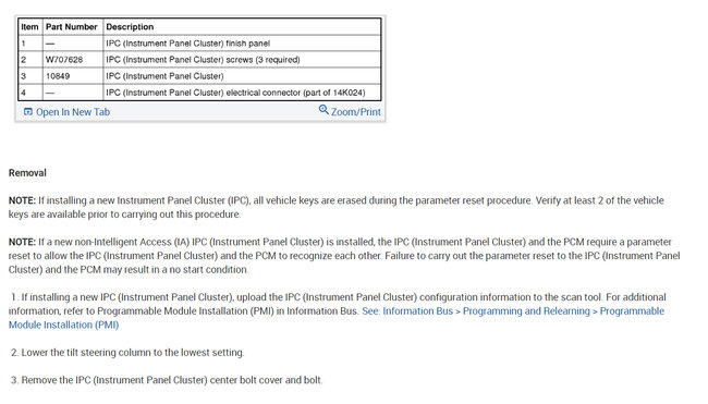

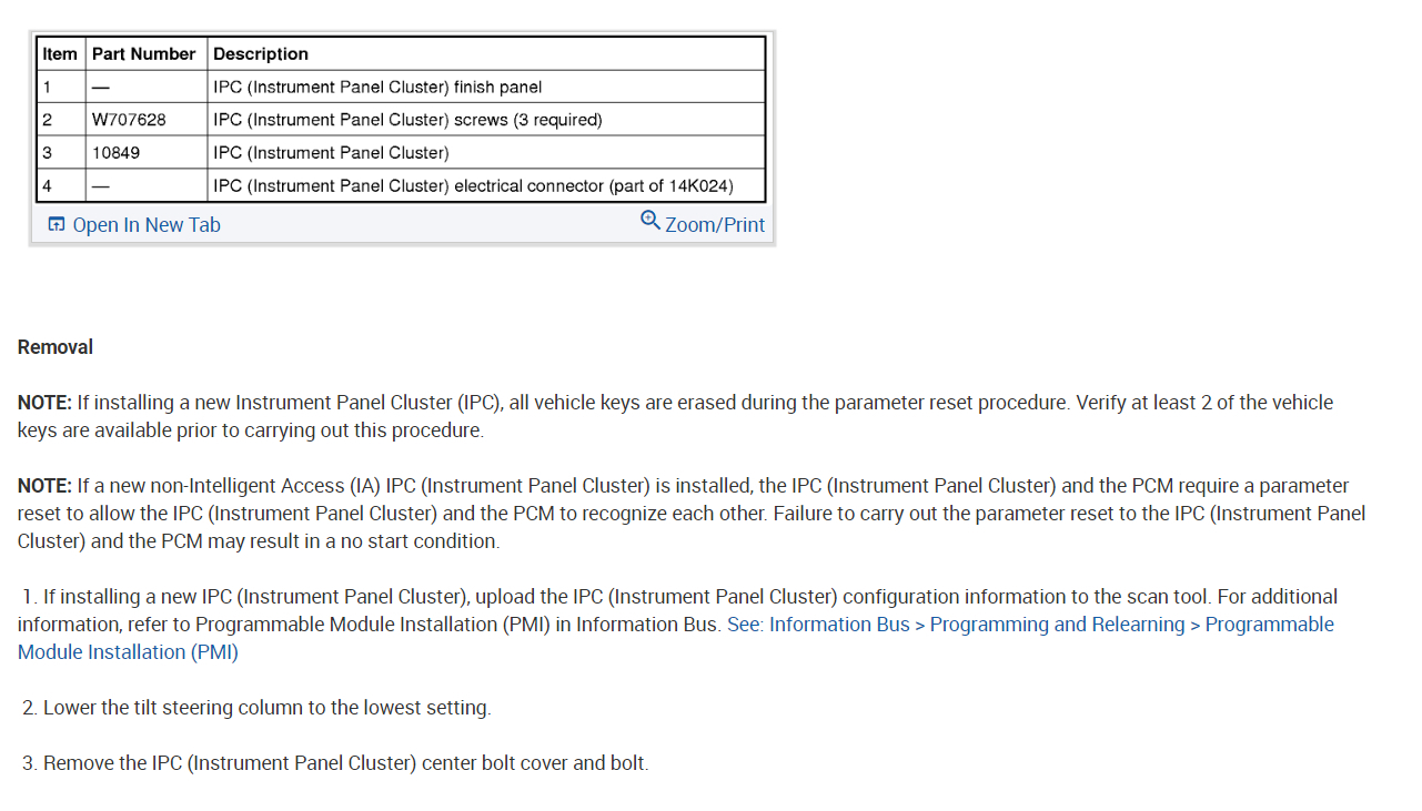

Had wheel bearings put on and all my dash lights came on even the gaslight. I replaced the speed sensor, but it did not change. What is my problem?

Usually when all the warning lights come on it means the cluster has gone bad but to be sure we can do a CAN scan which is easy. you can get a CAN scanner (Controller Area Network) from Amazon from about $32.00.

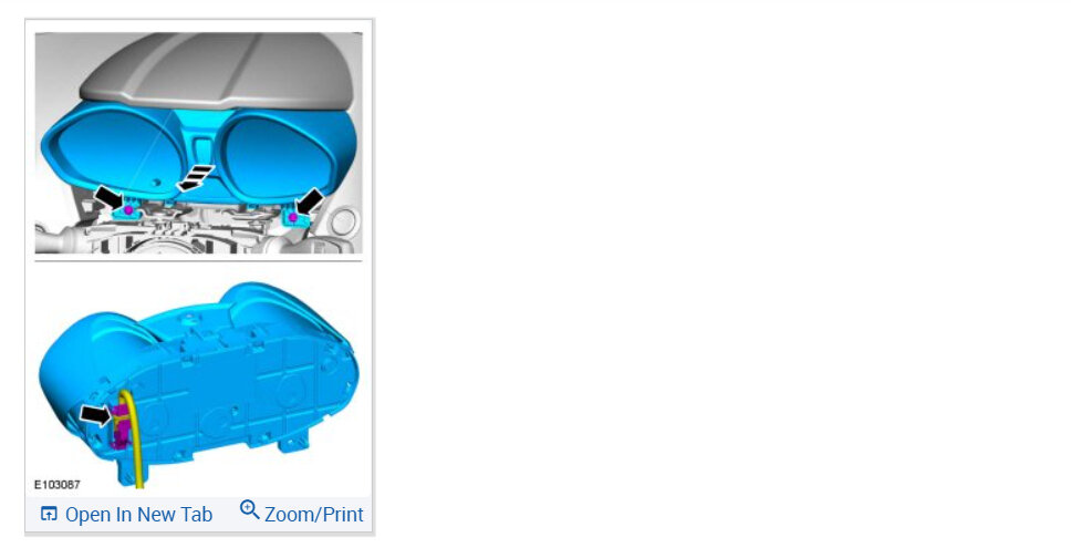

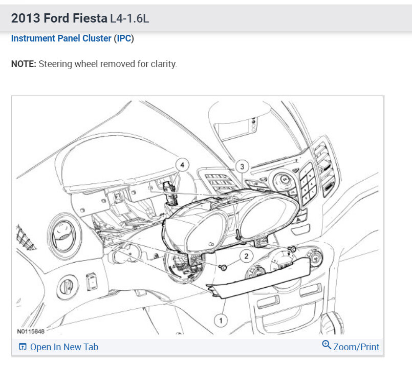

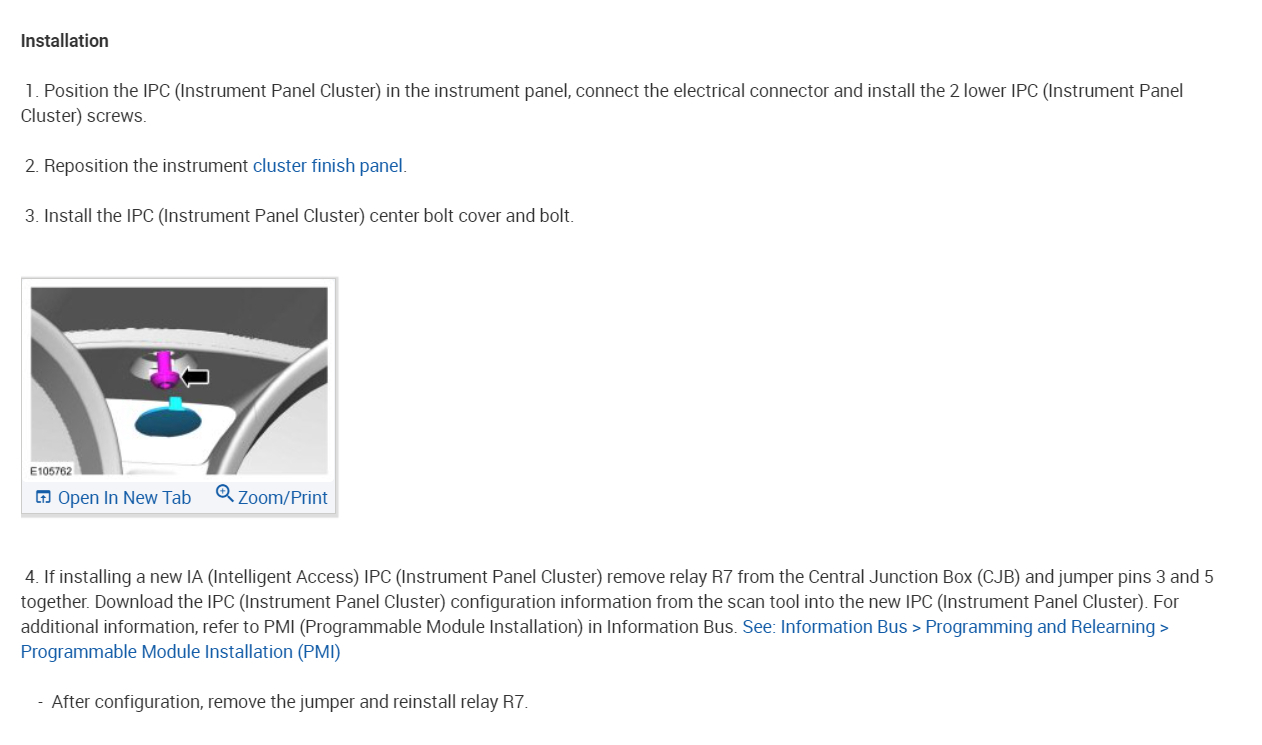

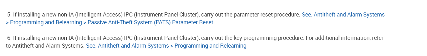

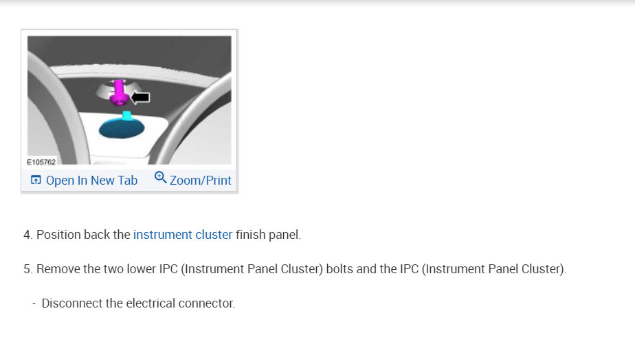

Here is how to change the cluster out and you can get a rebuilt cluster that is pre-programmed by searching Google or eBay. Check out the images (below). Please let us know what you find.
