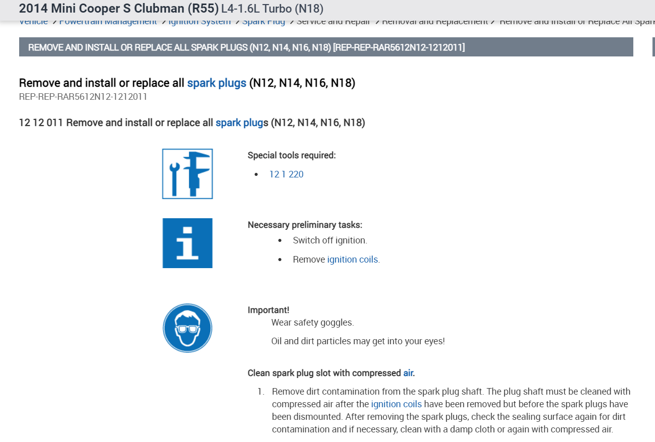

reduced power message and the engine misfires?
116,000 MILES • 4 CYL • TURBO • 2WD • MANUAL
BHAMDOC1973
  • 2,007 POSTS
The car listed above is a Paceman s, manual, reduced power message and all misfire.
Oct 23, 2022 at 8:11 AM
  • 55,711 POSTS

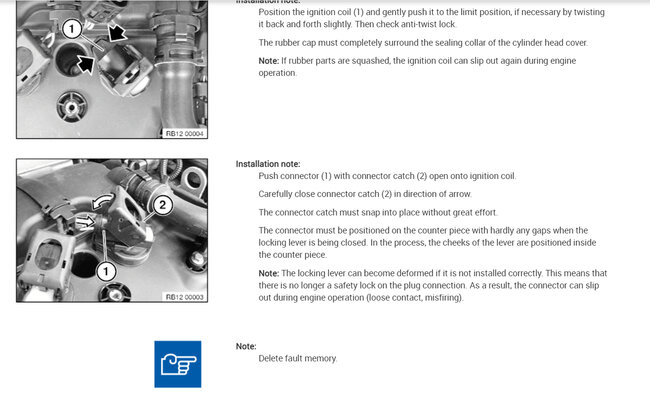

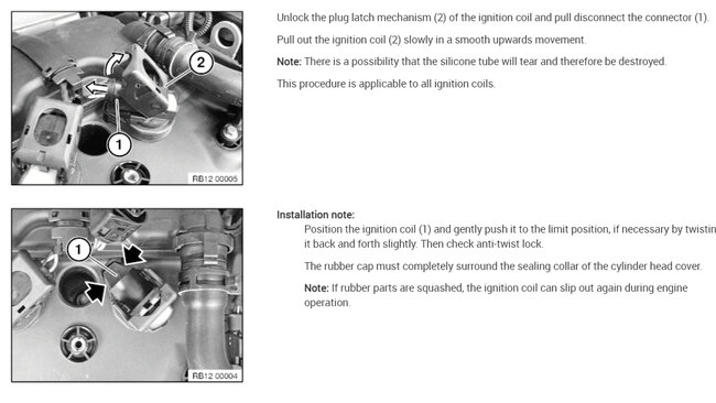

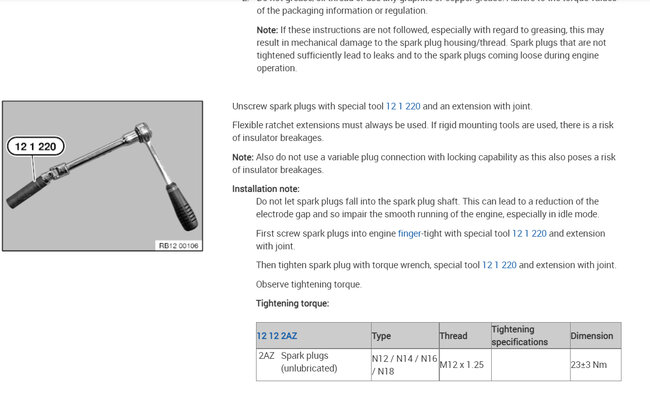

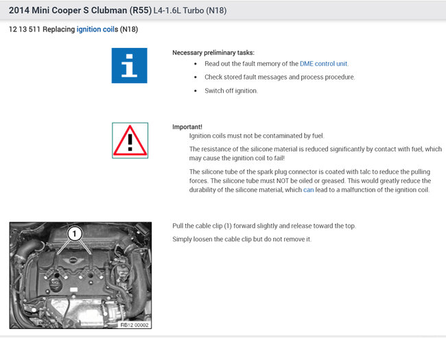

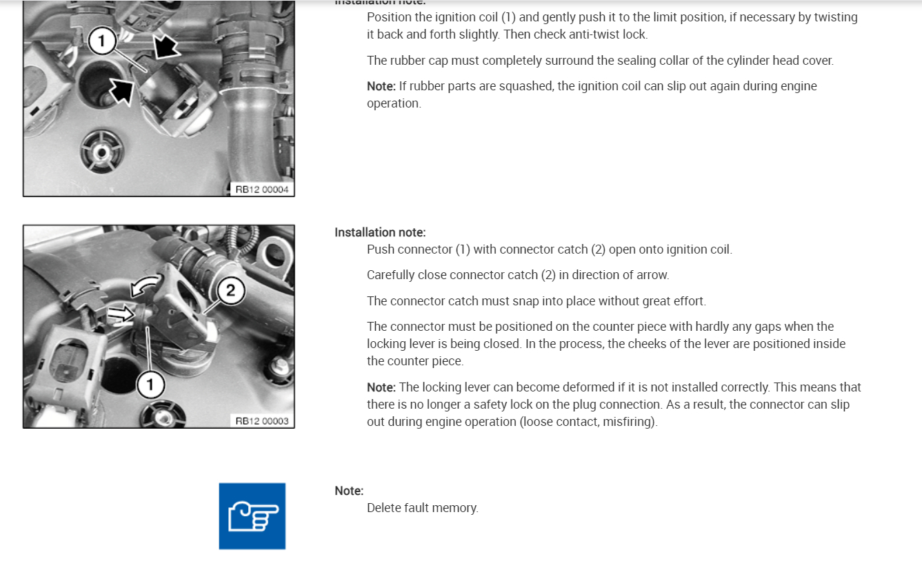

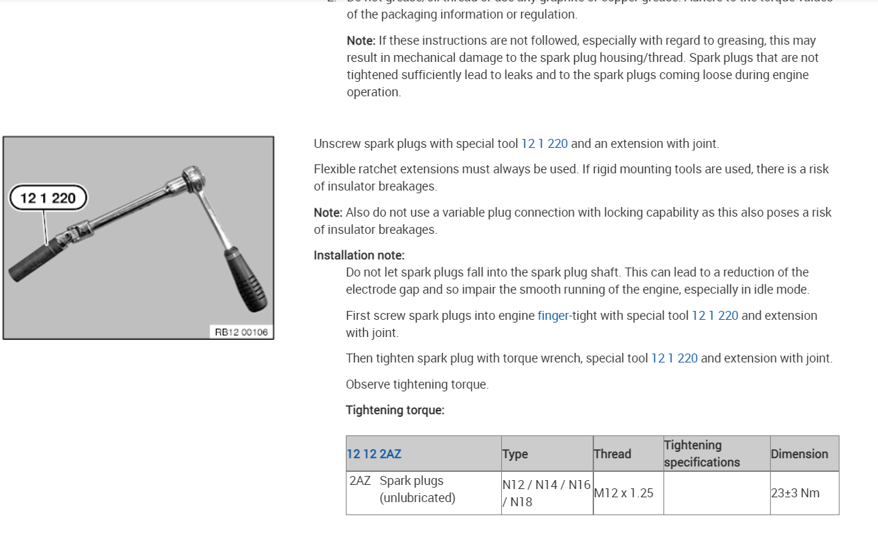

This can happen when the spark plugs are worn out. I would start with plugs and coils which are common.
Here is a generic guide to help with instructions in the images below for your car:
https://www.2carpros.com/articles/how-to-change-spark-plugs
and
Also, I would service the throttle body. Check out the images (below). Let us know what happens and please upload pictures or videos of the problem.
Oct 24, 2022 at 4:31 AM
