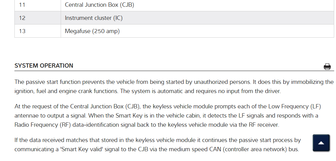

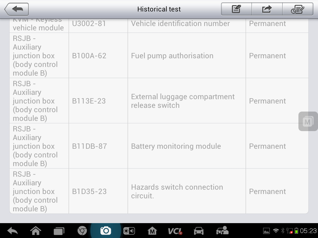

I had just one passive key programmed but it cranks no start. so i figured i need 2 transponder chip keys to program on it. hope it will take car of the problem.
Aug 1, 2019 at 5:17 PM
SCGRANTURISMO
  • 4,897 POSTS

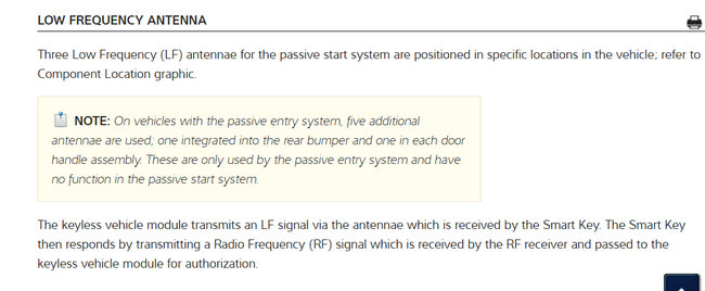

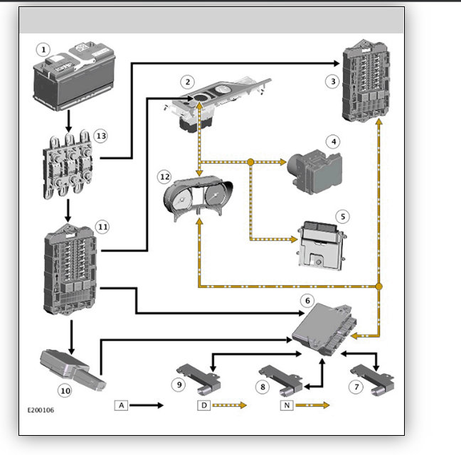

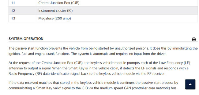

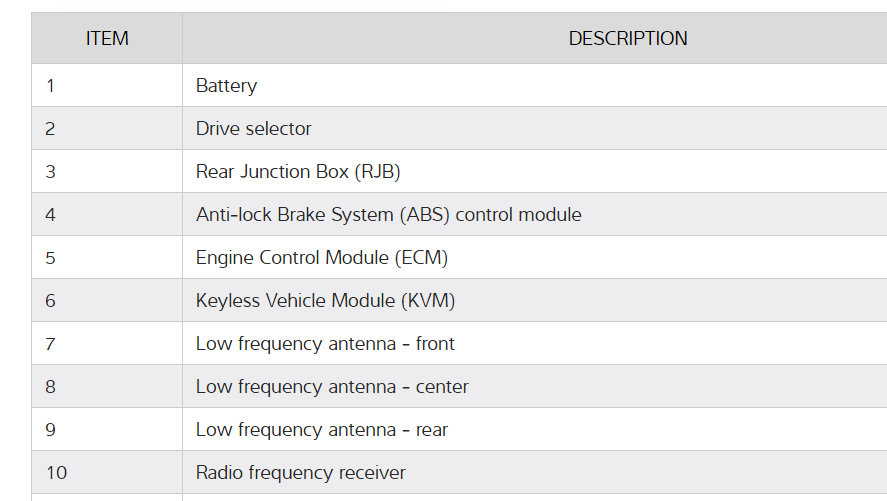

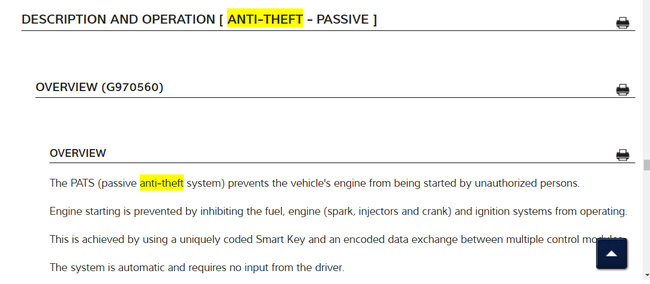

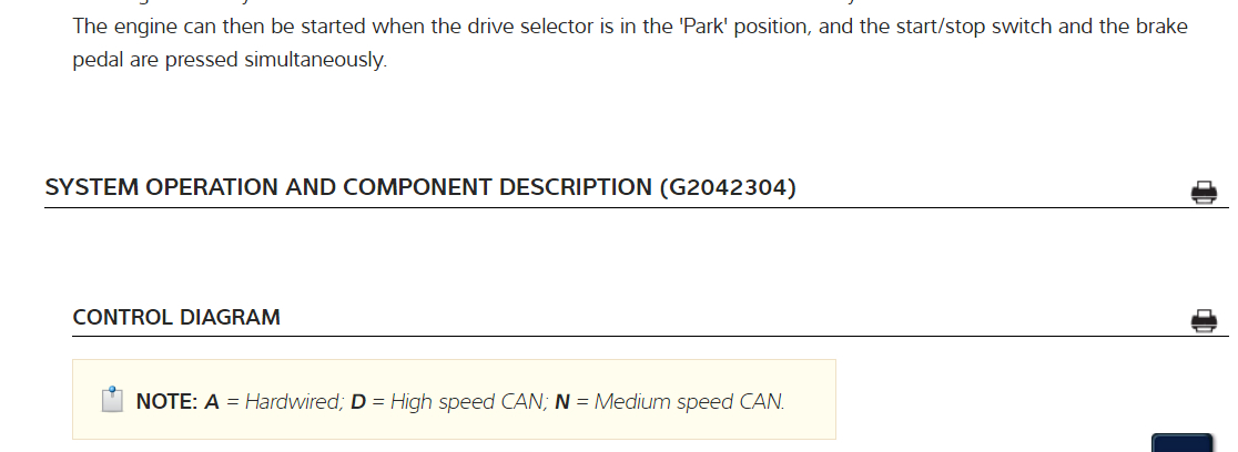

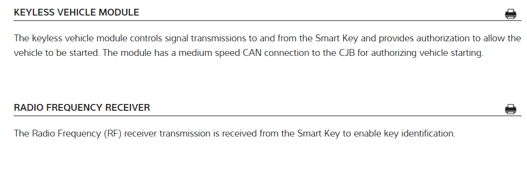

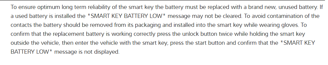

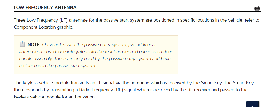

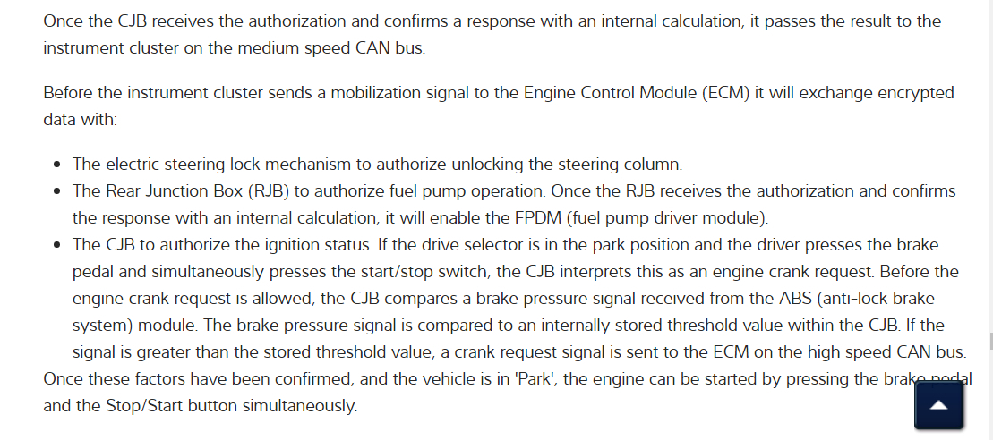

Hello again,
I have included a much more detailed description of your vehicle's passive anti-theft system, from the vehicle manufacturer. Please go through these guides and keep us informed as to things progress.
Thanks,
Alex
2CarPros
