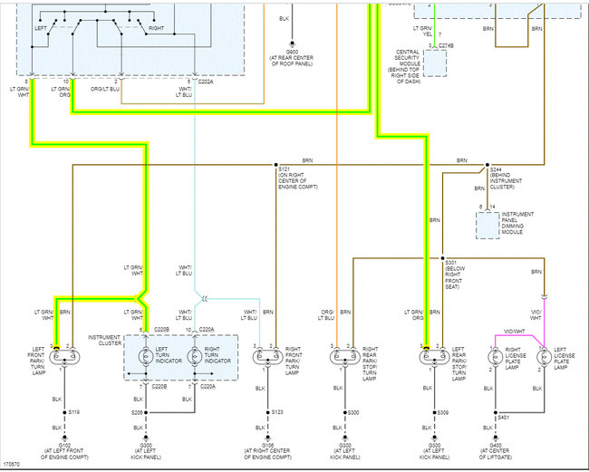

Headlights, brake lights, turn signals on right side and hazards on right side work. Everything works on left too except turn signals and hazards. When I put right turn signal on my flasher on dash lights up as well. When I put left turn signal on there is no light on dash and front and rear don't light up.
Jul 18, 2020 at 8:41 AM
  • 110,241 POSTS

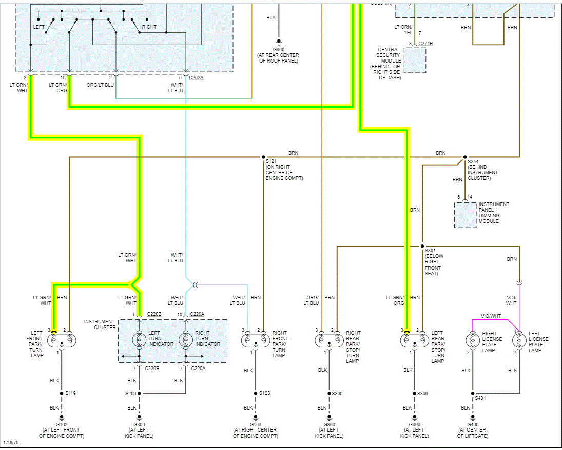

Does anything happen when you turn the left signal on? If absolutely nothing happens, I suspect the switch is bad. The power for the right side signals comes from the same place and they work, so it's not a power issue. The grounds for left and right are at the same place as well. So that leaves the switch. What you could do is check to see if there is power to the light green wire with a white tracer (front left signal) and the light green wire with an orange tracer (left rear signal) for power when you turn the left signals are on. If there is no power, replace the switch. If there is power, then we have two broken wires at some point. If it happened all at once, then chances are that isn't the issue.
I attached a portion of the wiring schematic below for you to see. I highlighted the wires that go to both the front and rear lights.

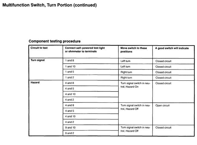

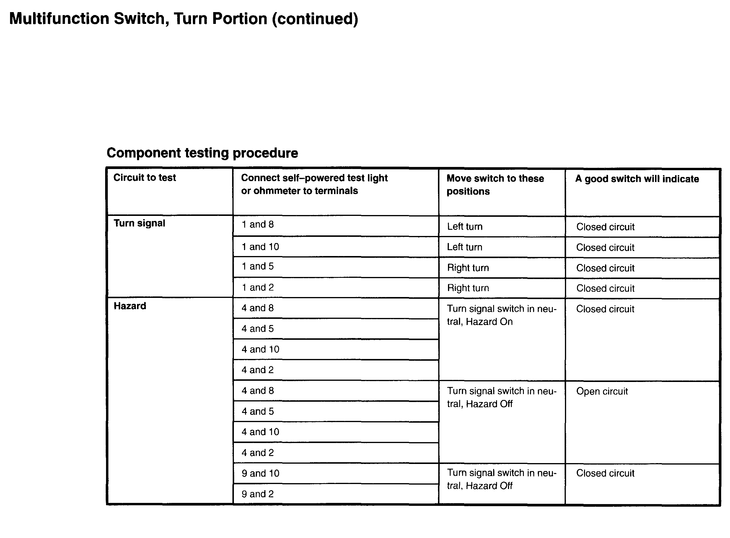

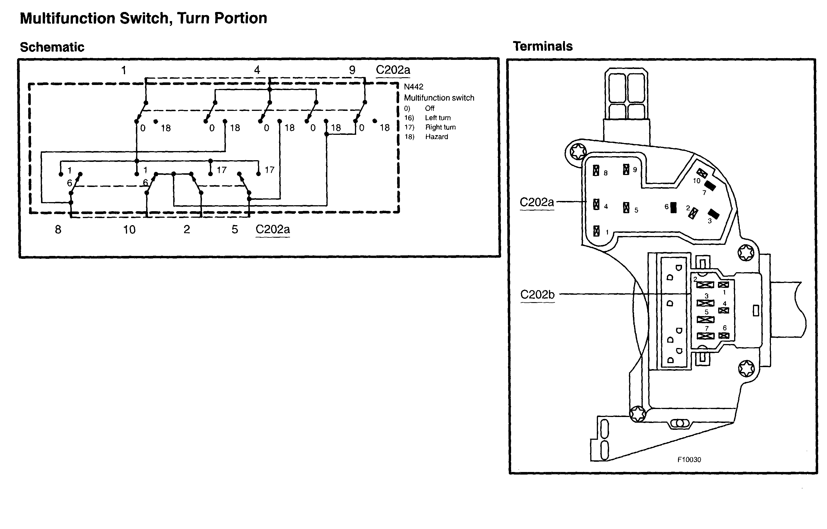

Let me know what you find. Also, here are the directions for testing the switch. The attached pics correlate with the directions.

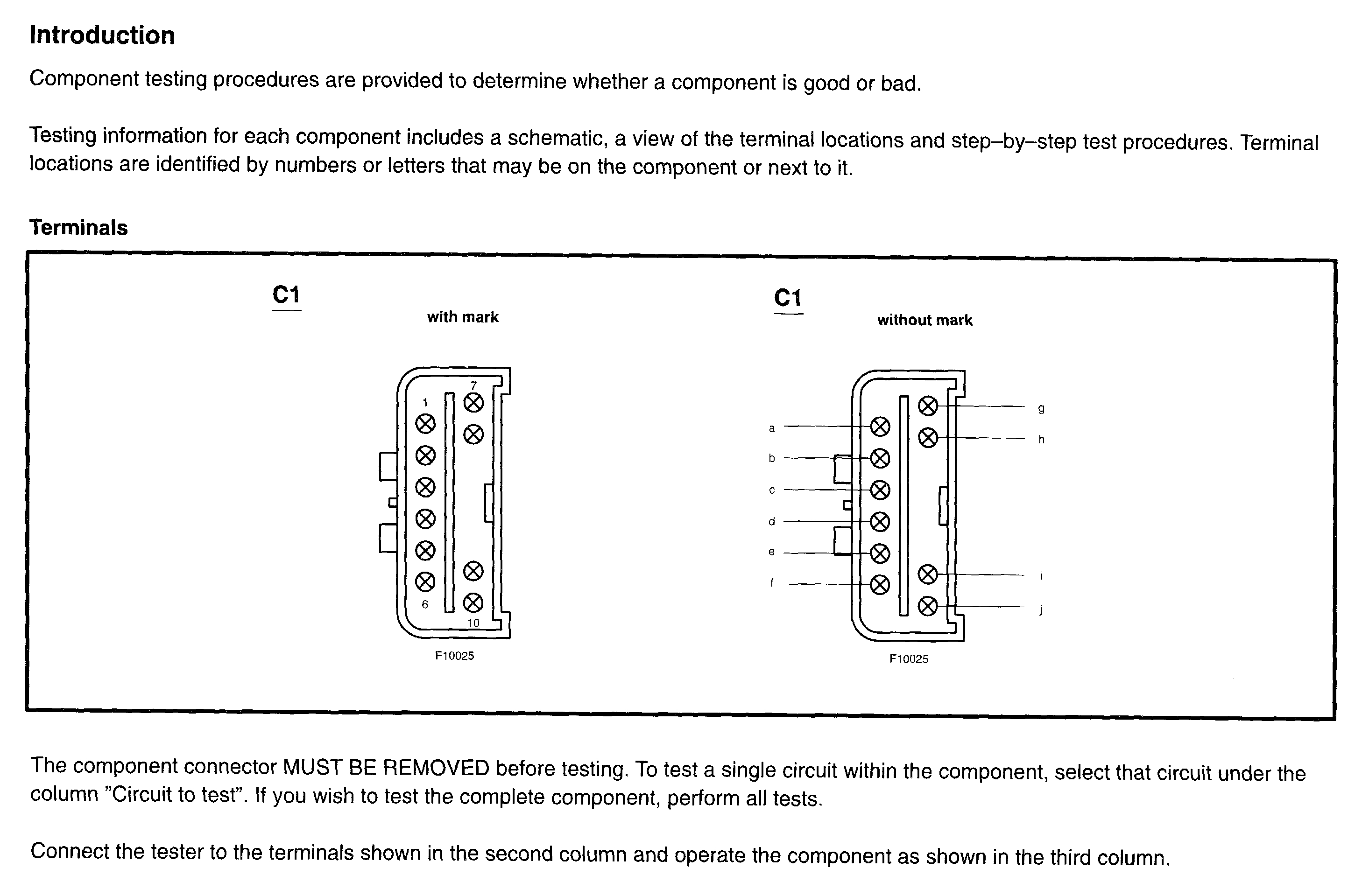

Introduction To Component Testing
Pic 1
Multifunction Switch, Turn Portion
See pic 2
See pic 3
