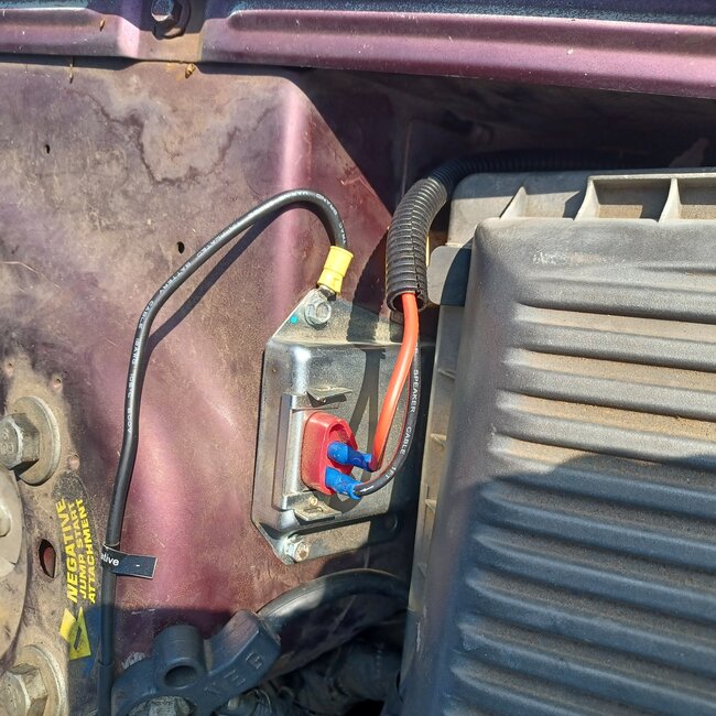

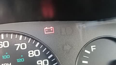

I installed an external voltage regulator because PCM was not controlling voltage to battery. I noticed that, after I installed it, the dash lights and headlights were pulsing. I have checked the ground and tried different locations for sourcing power, but have not had any success correcting this issue. Any advice will be appreciated.

What kind of regulator did you use? Chrysler's 1970s unit is what is commonly used. Did you do any diagnostics on the system before modifying it?
Is the pulsing a regular surge up and down, an intermittent flicker, or something else? Measure the battery voltage with the engine running and tell me what you find. Is there anything you can do to cause the pulsing to occur, or to occur more often?

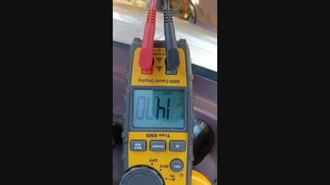

Original test found voltage in the 16 voltage range. Not seeing a voltage regulator under the hood, and not realizing that the voltage was regulated by PCM, I bought a new alternator. It came with specific instructions for testing, and that test showed alternator to be good. I installed the new one anyways. Since I was getting 16v I thought the regulator was the issue. Then I installed the external regulator. The pulse is constant and doesn't seem to change regardless of load. I have attached a couple of videos. Thanks.

You do have the common regulator used for this modification. I did the same thing on my skid steer. While the setup will get the job done, there are some technical problems with it. This was the first electronic voltage regulator, first used by Chrysler on 1970 models. They have a really long list of "firsts" that truly benefitted car owners.
The first problem is this regulator has temperature compensation built in, but that's all. Charging the battery is a chemical process, and those slow down in colder temperatures. This regulator will bump up charging voltage a little in cold weather.
Other manufacturers like to put the regulator inside the generator, making it an easy-to-replace package deal. You have to buy both parts when one of them fails. With Chrysler's design, the alternator remains a stand-alone part, so that's all you replace when it fails. By putting the voltage regulator inside the Engie Computer, it can respond to everything the computer knows. Specifically, it knows battery temperature, engine coolant temperature, engine load, engine speed, and a number of "anticipation" controls. That means it knows for example, when the computer is about to cycle on the AC compressor or the rear window defogger. Both require extra current, so instead of that sudden current increase causing a drop in voltage, and dimming lights, it ramps up alternator output just before those higher loads begin. The external regulator has no way of knowing that. It can only respond after the loads occur and system voltage has dropped.
The second thing to be aware of, while likely not the problem here, is this regulator has a third, very important wire. That is the ground made through its metal housing. Relying on the bolt threads is not the best idea. Instead, consider scratching a clean surface through the paint to get the best possible connection. To check the connection, use a digital voltmeter on the lowest DC volts scale, then measure the voltage drop between a clean spot on the housing and the battery's negative post. Since mechanical connections are involved, there will be some slight voltage drop, but it should be in the order of millivolts. I'd expect to see less than perhaps 10 to 20 millivolts. If you find more than that experiment with additional ground wires between the engine and body sheet metal, and between the body sheet metal and the battery's negative cable. That will be the smaller cable of the two in the negative cable clamp.

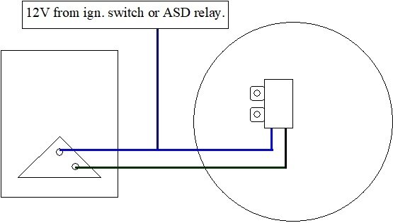

The next concern has to do where you're getting the 12 volts to run the regulator. The Engine Computer usually has four 12-volt supplies. One is constant to maintain learned fuel trim numbers, sensor personalities, and any diagnostic fault code data. A second supply from the ignition switch turns the computer on. There may be a third supply that gets switched onto one of the outputs to turn on the automatic shutdown, (ASD), relay. That relay feeds 12 volts to the ignition coil(s), injectors, fuel pump or pump relay, oxygen sensor heaters, and it is the fourth 12-volt supply going back to the computer. That is the 12 volts the computer looks at to monitor system voltage. By monitoring the ASD line, it maintains steady voltage to everything that makes the engine run right. The lighting circuit comes along for the ride. It will be stable as long as the engine controls are stable.

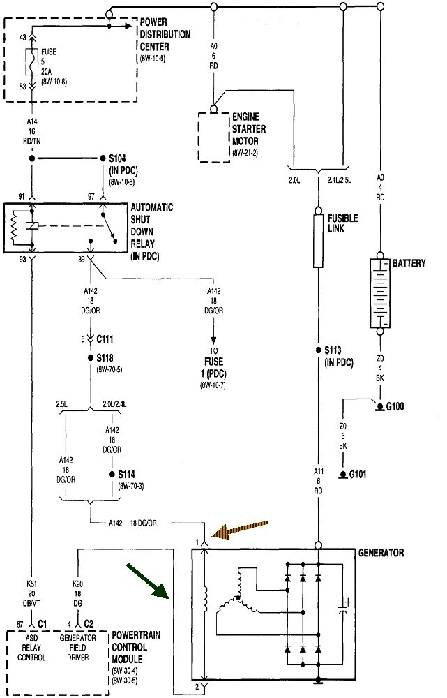

In this diagram, you'll see the feed wire to the field coil is dark green / orange. The "control" wire is dark green. In this story, we've determined the field circuit is open, and it appears you correctly found the defect is inside the Engine Computer. Before going through the work of the modification, (or spending our customer's money), we had better verify the alternator itself is okay and doesn't have an additional problem. A real fast way to do that is with a "full-field" test. All that involves is grounding the dark green wire while the engine is running. Be aware this is definitely no time to raise engine speed. Doing so has the ability to send system voltage well over 30 volts, enough to destroy multiple computers and burn out any bulbs that are turned on. Alternators and generators are very inefficient at low speeds, but if working properly, they will develop plenty of increased voltage to be seen. Monitor battery voltage, or watch the brightness of the head lights when you ground that wire. If voltage goes up, the alternator can be said to have "not failed". It still may not be working to full capacity, but that's a story for another day.
Next, I get to discuss some problems with this dark green wire. This same circuit was used on Dodge Shadows. We had three of them, donated by Chrysler, to my community college, that I used for training. On those models, there was an inline connector halfway between the computer and the alternator. I never did, and never allowed anyone to pierce wire insulation to take measurements. Instead, those connectors made dandy test points. That is a perfect place to touch a jumper wire, and to ground, to full-field the system. If you don't have an inline connector, or know where to find it, you're presented with a new problem. You can do this test right at the back of the alternator, however, both wires go through a black plastic block and emerge as two thin tabs bolted to the two small terminal bolts. When the system is working properly, it's easy to tell which tab goes with which wire by the voltages. It's when you have your problem of an open circuit, both voltages will be exactly the same. Which tab do you ground to perform the full-field test? If you try the correct one first, charging voltage will go up. If you grab the wrong one first, you'll blow the fuse feeding the ASD circuit. No harm done, but it is embarrassing. I do have a relatively simple trick to figure out which is the correct terminal to ground, but I can't give out all me secrets at once.
Okay, as promised, back to my thoughts on adding a capacitor. We're looking for the cause of alternator output going up and down. That is a result of unwanted current flow changes between the two smaller field terminals, and that is caused by unwanted voltage fluctuations between them. A capacitor, for anyone not familiar with them, can be thought of as nothing more than a very small battery. The large ones basically want to oppose a change in voltage across them. Their use in this type of circuit is to absorb the voltage increases, and provide a little current when the voltage drops. It smooths out the voltage. This is not a part I would buy just to experiment. As a former tv / vcr repairman who has scrapped out hundreds of units, I have boxes full of these "prizes". Find any friend who is into electronics, or visit any tv repair shop, if you can still find one, and they will have all you want, probably for free. They're rated in voltage and "microfarads", which is their electrical storage capacity. I'd look for something in the area of 100 to 1000 mfd. The voltage just has to be higher than what it will "see" in the car. Common voltages are 50 and 100 volts. It refers to the voltage it can withstand without arcing and shorting internally. These larger capacitors are referred to as "electrolytics", and as such, they do have a polarity. Get that polarity wrong with so a low voltage, and it's extremely likely nothing exciting will happen. For testing, it will work fine. If possible to figure out, the positive terminal should go to the 14-volt feed terminal, and the negative to the dark green wire / terminal.

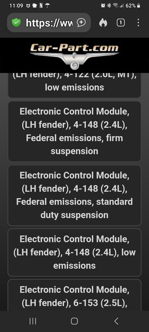

I think I will go back to square one. I am going to reconnect ecm and re-test. However, I have a couple of questions. When I connected external regulator, I cut the two small wires that go to plug on back of alternator. I then tied external regulator to that plug. This takes regulator in ecm out of the loop, correct?
The other questions I have are in regards to buying a used ecm.
The options I see online ask if I need:
Low emissions vs federal emissions.
Firm suspension vs standard suspension.
Also, would it need to be programmed or can I just match part numbers?

First question. Yes, if you cut the wires, the internal regulator is removed. The two on the external regulator go to the two on the alternator. No polarity, meaning either wire can go to either terminal. Then the entire modified charging system needs a 12 volt power source. I put this drawing together to show it better. On '70s and '80s models, for all cars and most trucks, every dark blue wire under the hood got 12 volts switched onto it when the ignition switch was in "run". By the mid '90s that 12-volt wire was commonly dark green / orange. On the voltage regulator, that 12-volt wire is the one at the top peak of the triangular plug, like in my sad drawing. (For some '80s trucks, that 12-volt wire was often red).
The emissions is basically one system for vehicles sold originally in California. The federal system is for the other 49 states.
I've never heard of a different Engine Computer based on the type of suspension. Unless you're aware of some type of optional sport package, assume you have standard suspension.
As for programming, I'm going to tell you more than I know. For '95 and older vehicles, computers were a simple plug-in-and-go affair. If you find one with the same part number, it will work, but we normally go by application, not part number. When a computer is sent in to be repaired or rebuilt, it gets the latest updates, then, instead of a part number that ends with "AA", the part number gets increased to "AB". That last letter steps up one time for each update or advancement in the software. When there is a really significant change or modification, it gets an entirely new part number that ends again with "AA". You can have three, four, or five computers, all with very different part numbers, that all are for the same application. They will, of course, be different between four, six, and eight-cylinder engines, but within each group, some Engine Computers are compatible with different engine sizes.
Right around '98, give or take a few years, they began requiring a four-digit PIN be entered with a scanner. There is a way to read that from the old computer, with Chrysler's DRB3 scanner, otherwise you need to call the dealer. I used to work for a very nice Chrysler dealer, and the people there like me, so they give me these numbers over the phone. I found out they do that for my friend too who they do not know. You can find the DRB3 scanners on eBay. I don't know if aftermarket scanners can do this, but if any can, I'd expect Autel products to be able to do it.
This next topic is harder to explain than it really is, but it could be extremely important. If your car has the optional factory-installed anti-theft system, you can plug in any correct Engine Computer, and / or any Body Computer and it will work. The anti-theft system lives in those two computers. If the replacement computer doesn't have anti-theft programming, it will learn that from the other computer the instant you turn on the ignition switch. Once learned and that anti-theft programming is activated, it cannot be undone.
Here's where the potential problem comes in. All of the Engine Computers and all of the Body Computers have the anti-theft programming built in. It is simply not activated if the car doesn't have that option. If you plug in a used replacement computer from a donor car that has the anti-theft option, that computer will immediately teach that to the other existing computer as soon as the ignition switch is turned on. Now you'll have a crank / no-start condition because both computers are waiting to see the "disarm" signal, but that's never coming since the system isn't on that car. At that point, the only solution is to replace both computers at the same time, with two that have not had anti-theft activated. That's usually impossible to know when buying them from a salvage yard, because the people there usually don't know whether a certain car had that.
I've seen or been involved with this problem three times. The first one was a learning experience for a coworker who later explained this to me. It was on a '92 Dynasty without anti-theft. For the second one, a friend with a body shop where he specializes in rebuilding one and two-year-old smashed Chrysler products, repairs were done except for replacing the crushed Engine Computer on a 2003 Neon. He borrowed a computer from another friend's car and verified everything was working properly. What he didn't know is the repaired car had anti-theft, and the Body Computer activated it in the borrowed Engine Computer. Engine ran fine. Next, he put the friend's Engine Computer back in his car, and now that one was a crank / no-start. That's because the anti-theft had been activated and it taught that to the Body Computer. Both computers in the friend's car had to be replaced.
If you buy a rebuilt Engine Computer from the dealer or from a legitimate computer repair shop, it will come with the anti-theft programming not activated. It will be activated automatically if your car has that system. Once that occurs, you don't want to put that new computer in another car without anti-theft or this same problem will occur.
The third vehicle that this happened to was on a '95 Intrepid donated by Chrysler to my community college after it had been used for training. That car did not have anti-theft. A student borrowed our Engine Computer to see if it would solve a problem on his car. He did have anti-theft, so his Body Computer taught that to our computer. When he put our computer back in our car, that Engine Computer activated the anti-theft in the Body Computer. Now we had a crank / no-start. To add to the frustration, my tool room attendant kept ordering used computers, one at a time, thinking he was going to get the engine to run. It was very difficult to convince him both computers had to be replaced at the same time before the ignition switch was turned on.
To boil this down, there is nothing to worry about if your car has factory anti-theft. Any replacement computer will self-activate that programming if necessary, but remember, that programming cannot be deactivated, so it can't be used later in a car without factory anti-theft.
If your car doesn't have anti-theft, you must be careful to use only replacement computers that don't have it activated. In your case where the engine does run but you're trying a different computer as a test for some other problem, if you suddenly have a no-start condition, that used computer has anti-theft activated and it just did that to your Body Computer. If you reinstall the original Engine Computer, it is going to self-activate due to learning from the Body Computer. Now you must replace both computers. If those computers are otherwise okay, they can be used in other cars that do have anti-theft. If you recognize this right away when the donor Engine Computer results in a no-start, you only have to replace the Body Computer due to it just being activated, but then the original Engine Computer can be reinstalled as it hasn't learned the anti-theft activation yet.
I know that can sound complicated, so sometimes I describe it as someone brushed paint on your shirt. Now that you have that paint, which can't be removed, you can wipe some on your hand and wipe it on someone else's shirt. The only way now to take the girls out tonight is for both of you to change your shirts at the same time. If only one of you does, the other still has paint he can wipe on your new shirt.
Now that I shared all that, I don't know if that applies to the Stratus and Cirrus models, but I suspect it does. I think I'd feel better if you reconnected the internal regulator, then take the voltage readings for me to analyze. If you do that, tell me what you find, and remember on which tab you find which voltage on that little black box on the back of the alternator.

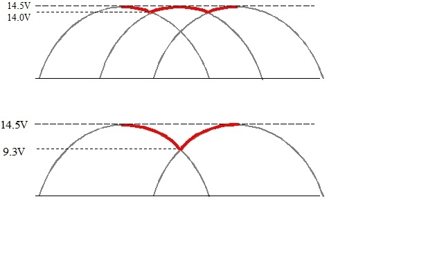

Others researching this topic may read this. For their benefit, I'd like to add one more comment. Along with a really long list of "firsts" for Chrysler, they were the first to develop the "AC generator", and they copyrighted the term, "alternator". That was first used on 1960 models. Mechanics didn't know yet how to diagnose these very simple systems, so they came up with a trick to remove a battery cable, then if the engine remained running, they assumed the alternator was working. There's a whole pile of problems with that "test". In fact, today, a mechanic caught doing that might be lucky and get one warning, but more likely they will be fired.
The first problem is the battery is needed to assist the voltage regulator in doing its job. All AC generators put out three-phase output, similar to what's found in large factories. After it passes through the internal "diodes", one-way valves for electrical current flow, it looks like the top waveform in the drawing below. The "ripple" voltage shown here as 0.5 volts, (the difference between 14.0 and 14.5 volts) is very easy for the battery to smooth out. In fact, the battery is preventing it from going much above 14.5 volts.
When a battery cable is disconnected while the engine is running, that ripple voltage increases and the peaks could easily go to 16 to 18 volts. That voltage goes right back around to run the field coil. With a higher voltage, you get higher current and a stronger electromagnet. That causes a higher output voltage to be induced resulting in higher output current. That cycle continues until it's very easy to reach well over 30 volts. For demonstration purposes this has to be done on a generator test bench because on a vehicle, 30 volts will destroy most of the computers, any bulbs that are turned on, the diodes in the alternator, and on GM generators, the built-in voltage regulator. The only thing that can save it is all generators are very inefficient at low speeds. Raise the motor speed on the test bench and that 30 volts is reached and exceeded in a heartbeat. Once the smoke comes out, you can't put it back in.
Without the battery in the circuit, the voltages in my top waveform are more likely to be 12.6 volts and perhaps 16.0 volts. Some voltage regulator designs operate by looking at the 12.6 volts. They increase generator output in an attempt to get that up higher. As they do, the 16 volts goes to 18 or 20 volts, but the regulator keeps seeing and responding to that 12.6 volts. Stuff gets burned out.
Other regulator designs look at the 16.0 volts and cut back on generator output in an attempt to get that down. Without the load of the battery to help with that, it can't cut back far enough. It keeps dropping and dropping field current until there's insufficient output current to keep the engine running. Injectors and electric fuel pump alone take over ten amps. The engine stalls, giving the false illusion the generator is not working.
Those are instances where you get invalid results when removing a battery cable. Another problem occurs when one of the generator's six internal diodes has failed. You lose one phase of the output. That looks like the lower waveform. Ripple voltage is very high, 5.2 volts in this case. Under the "full-load output current" test, the most you'll be able to get is exactly one third of the generator's maximum rated capacity. Today it's very common to find generators capable of developing 100 amps. With one bad diode, roughly 33 amps is all you'll be able to get. That's not enough to run the entire electrical system under all conditions. The battery has to make up the difference as it slowly runs down over days or weeks. Removing a battery cable with this condition will cause the same results as before, but maybe more pronounced. Even if the engine does stay running, you haven't identified this defect.

Measure the battery voltage with the engine off. It will be very close to 12.6 volts if it's good and fully-charged. At 12.2 volts, it's good but fully discharged. If it's around 11 volts or less, it has a shorted cell and must be replaced.
Next, measure the battery voltage again with the engine running. Now it must be between 13.75 and 14.75 volts, give or take a little depending on which textbook you read. If it is, that just means it's okay to continue with the professional tests. You'll need to visit a shop for that. Those testers will measure that charging voltage again, plus the full-load output current and the ripple voltage. A few testers can make paper printouts. Those will display ripple voltage as an actual voltage. Most testers just show ripple voltage as "low", (good), or "high", (bad), with a series of flashing lights.
