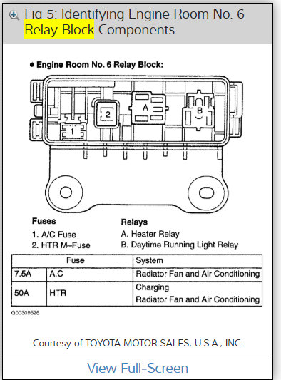

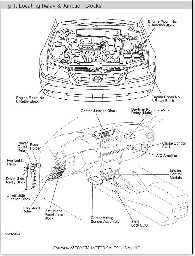

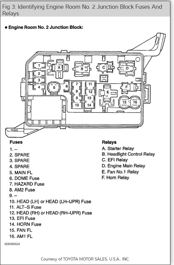

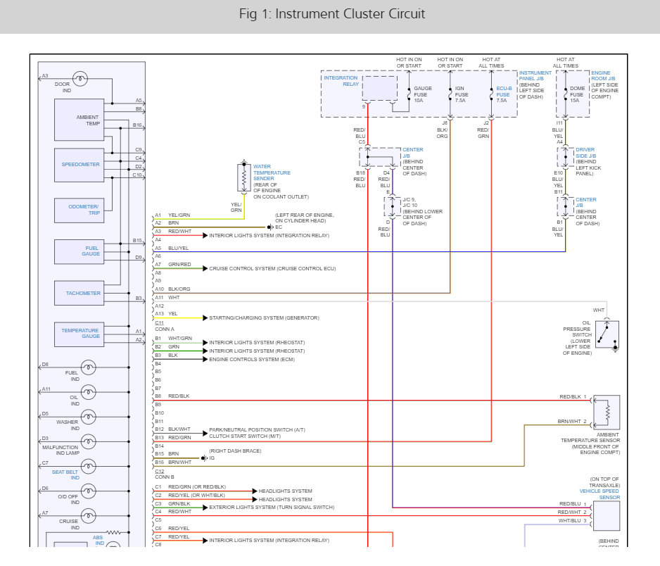

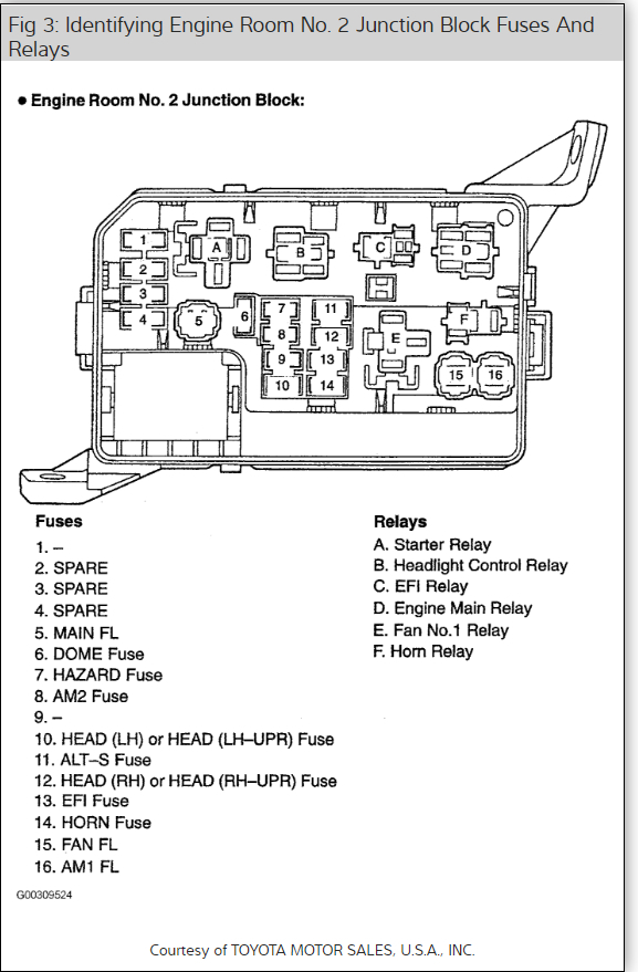

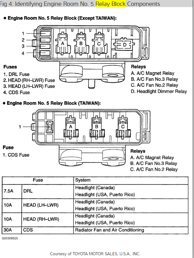

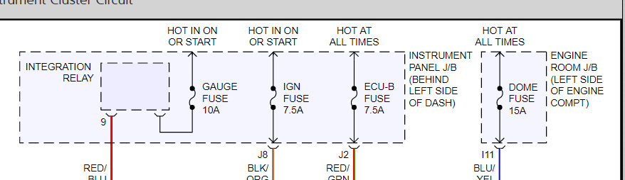

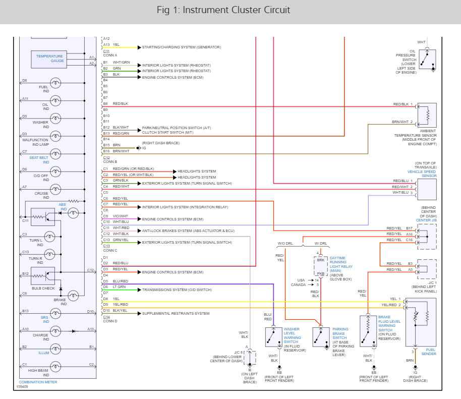

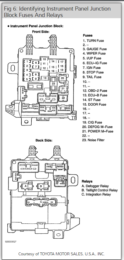

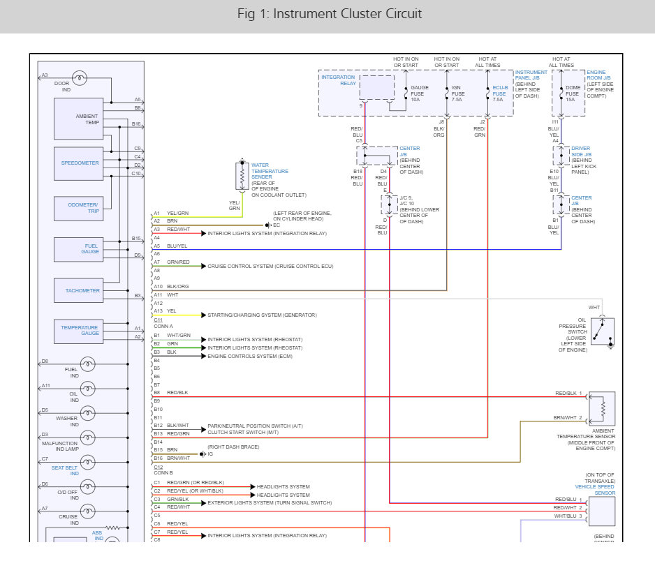

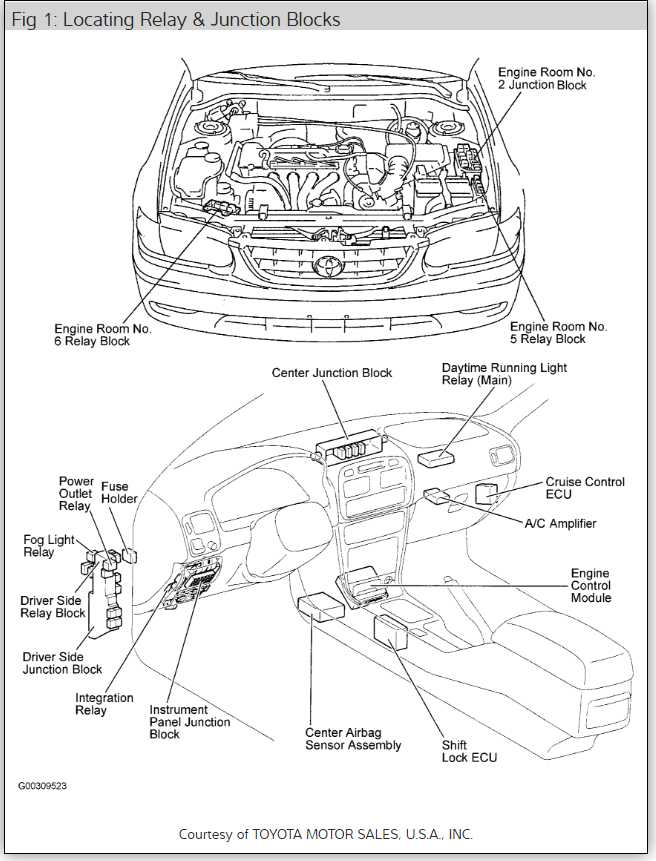

We need to check the fuses which are in the diagrams below. here is a guide to help check for power and if the fuse is any good. I have also included the fuse location and the cluster wiring so you can see how the system works.
May 28, 2021 at 3:14 AM
CHIDA MOYO
I checked all the fuses they are all good.

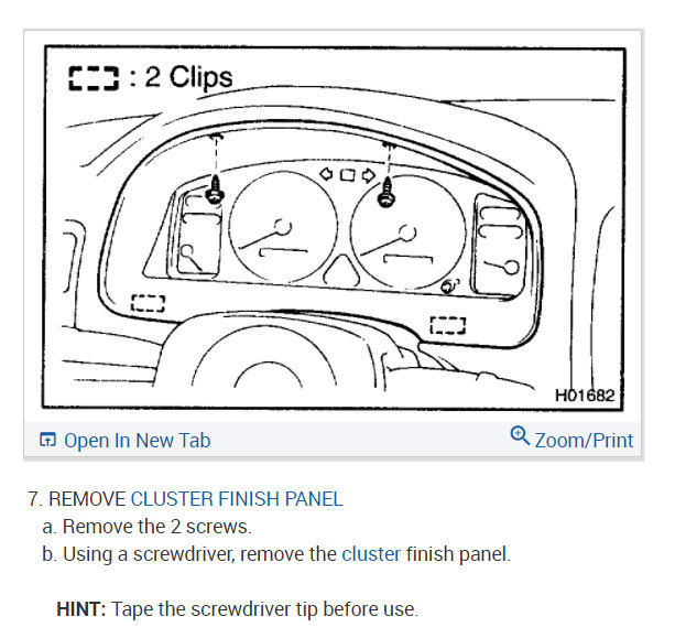

Good job, if all power and grounds are good the cluster has gone bad. This video shows the job being done on a similar car but the process is the same. There are diagrams below to show you how on your car.
https://youtu.be/_HEC44xENxw
